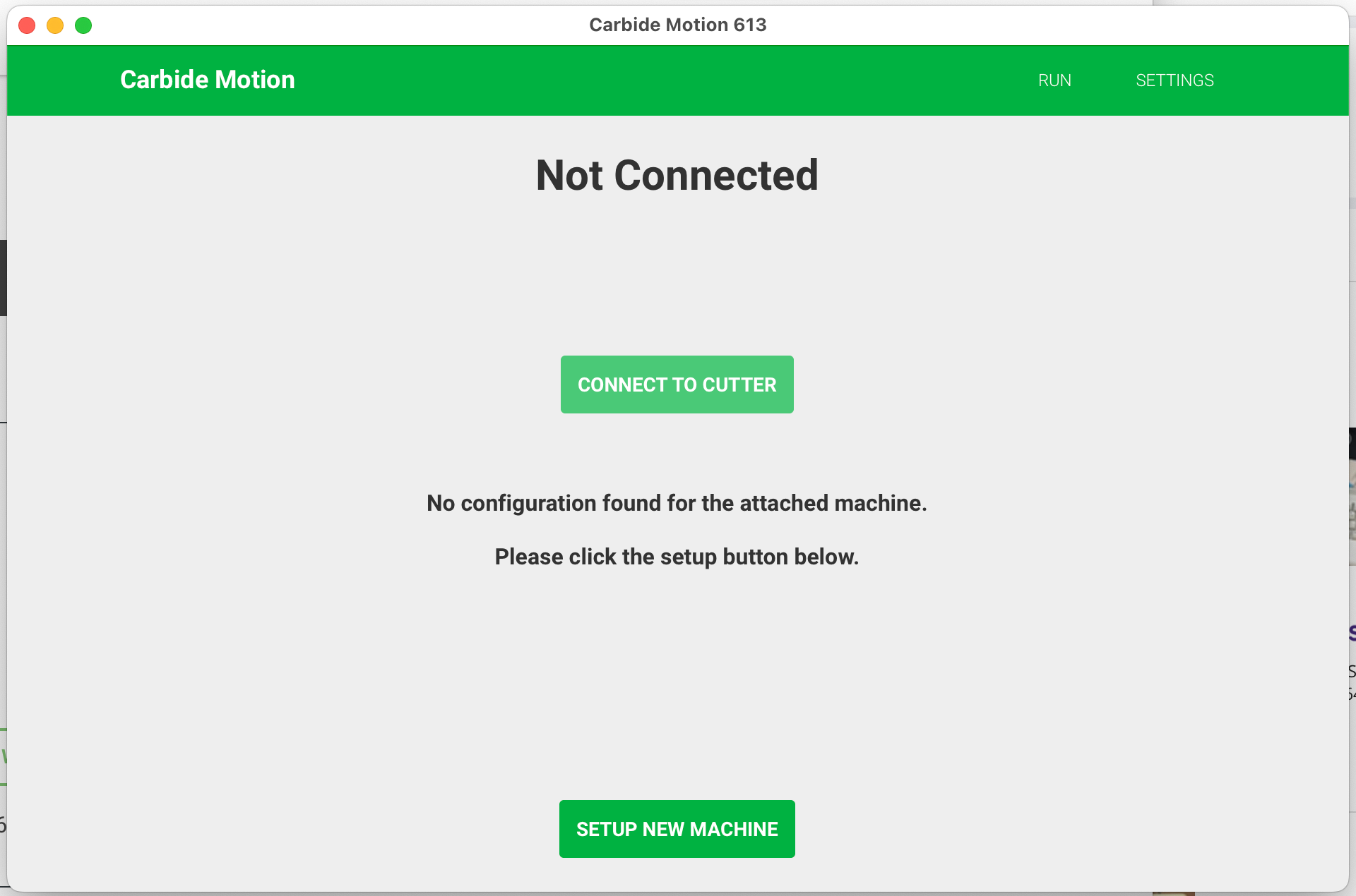

I (naively) upgraded CM, as I haven’t used my Nomad in a while. I landed on the Downloads page, which has a link “Carbide Motion 5, Get Carbide Motion Here”. I upgraded CM.
Turns out what I got is Build: 613 Released: 6-16-2023 (MacOS version), which seems to be “version 6”.

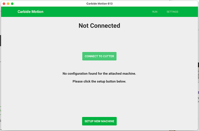

Now a “setup wizard” runs every time I launch CM. It connects to the machine, homes it correctly, and I can save the setup. It says “your machine should now be ready to run”. But it isn’t — the main screen always says “No configuration found”.
I wanted to downgrade, but it seems all available versions have the “setup wizard” thing and are version 6.

Build 582 is available at:
which should get you back up and running.
Thanks! But that’s an .exe file, and I’m on a Mac — is the Mac build available, too?
Yes:
https://carbide-downloads.website-us-east-1.linodeobjects.com/cm/stable/582/CarbideMotion-582.dmg
Thanks, downgraded now and hopefully that will let me use the machine tomorrow.

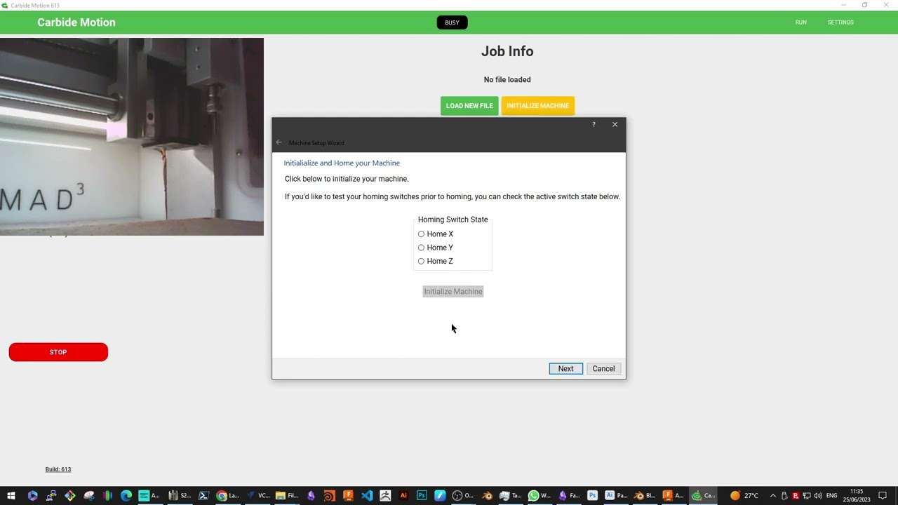

I believe I have the same issue - here is what I did
Until we have a new version, folks should revert to 582 if need be (but please, if you are reading this and haven’t updated, please try it and let us know how it goes at support@carbide3d.com )

I’m having the exact same issue. Nomad 883, Windows 11 version 616. I see the setup work while the setup dialog is open (you can see the same in video above) and then it’s back to “no configuration found”. I’m back to v5. It was a frustrating afternoon digging through all this.
Latest version of motion should have fixed this issue.
