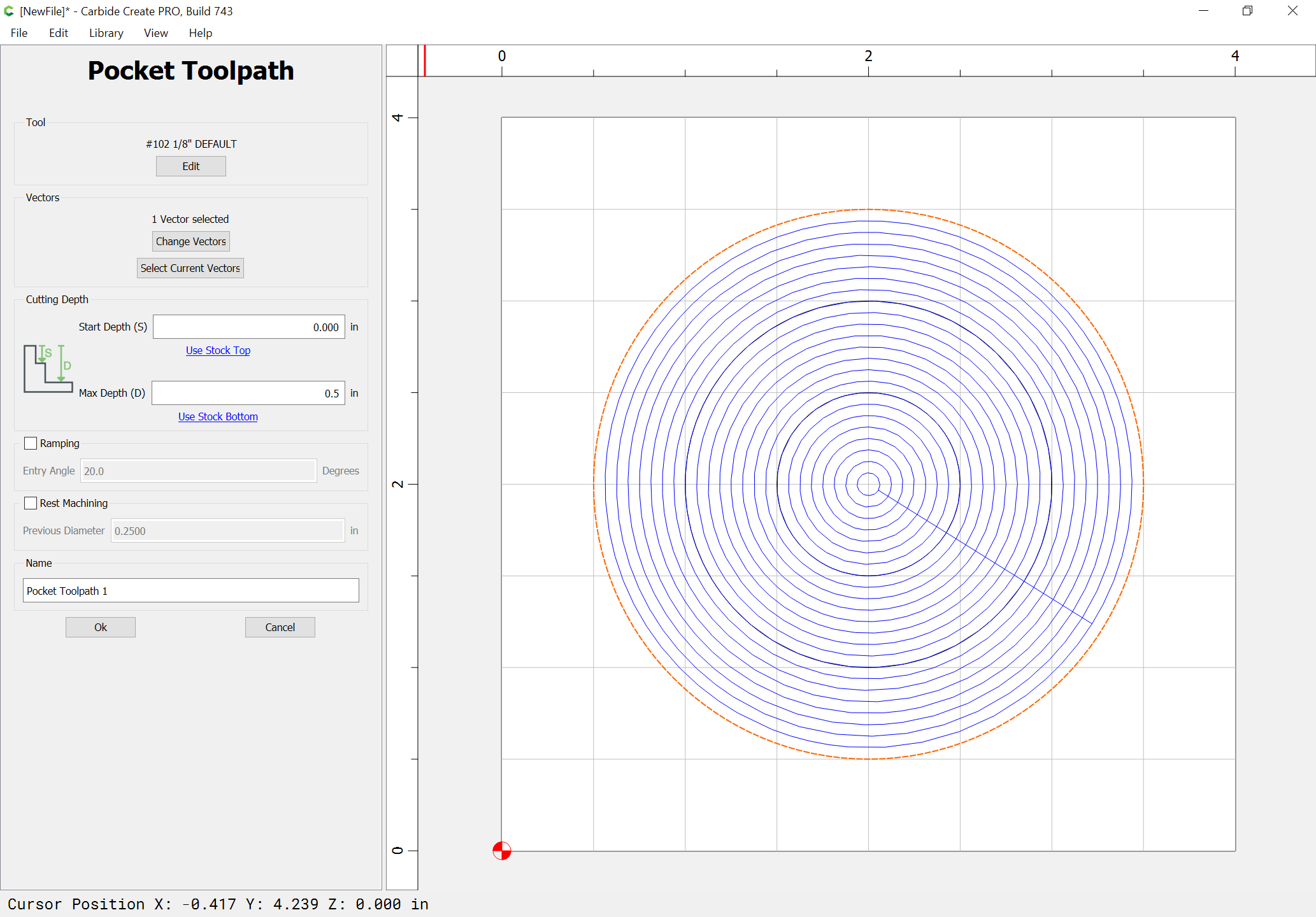

First, set up the job:
Set up a pocket from 0 (top of stock) to 0.5" (midway through the 1" stock):

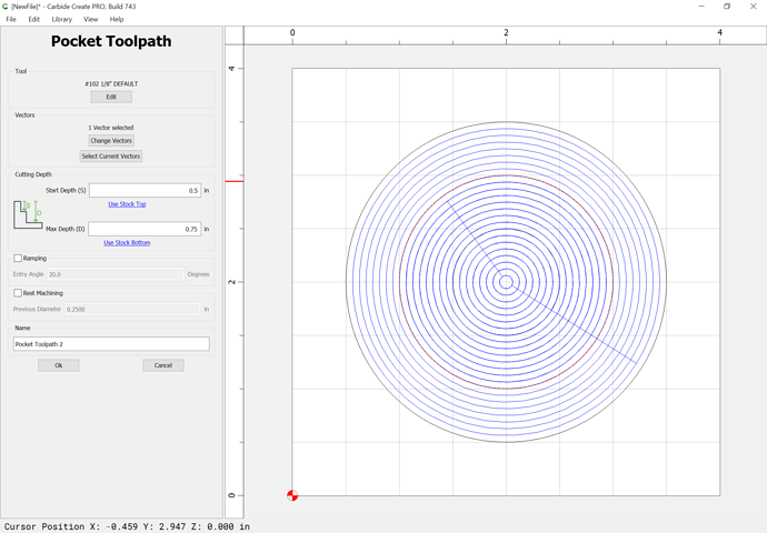

Next, cut a pocket starting at the bottom of the mid-way pocket, and cutting another 0.25" deeper:

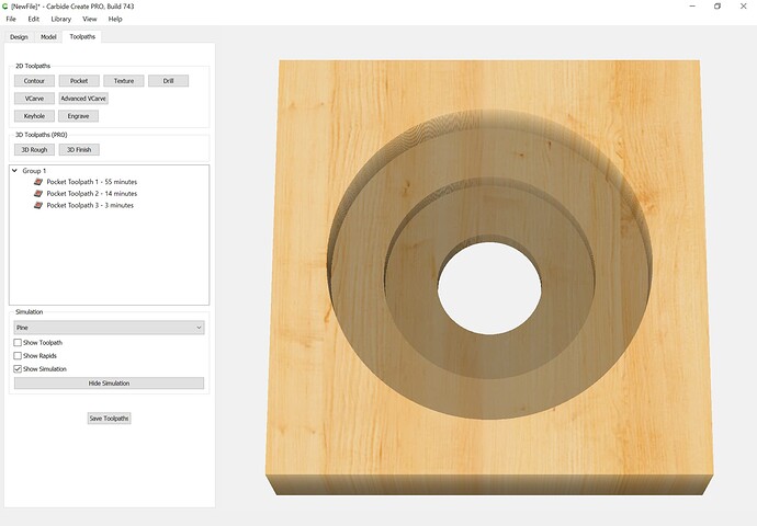

Then, cut from the bottom of that all the way through:

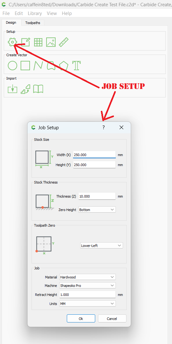

Something to watch out for is when selecting the Start Depth / Max Depth the image to the left shows that it’s in reference to the top of your stock regardless of where Z(zero) is set
Also note the options circled “Use Stock Top” and “Use Stock Bottom” which will enter the value for you if you click it (ie. if clicked for Start Depth (S) the value will be zero and if clicked for Max Depth (D) this value will be the bottom which should match the stock thickness you entered when setting up the project settings under “Job Setup”).
To test things out I tried setting the value for Max Depth (D) to something greater then the stock thickness. I’m my example I setup the stock thickness to 10mm and in the following toolpath I entered 15mm for Max Depth which is 5mm below Z(zero) which is setup for the bottom of the stock / CNC bed.
Taking a look in NCViewer you’ll notice the pocket is too deep and will cut the pocket 5mm into the CNC bed/table. Probably best practice if you want a toolpath to go to the bottom of your stock use the “Use Stock Bottom” button and if it’s not the value you expected then you probably didn’t enter your stock thickness (Thickness Z) properly in the “Job Setup”.
