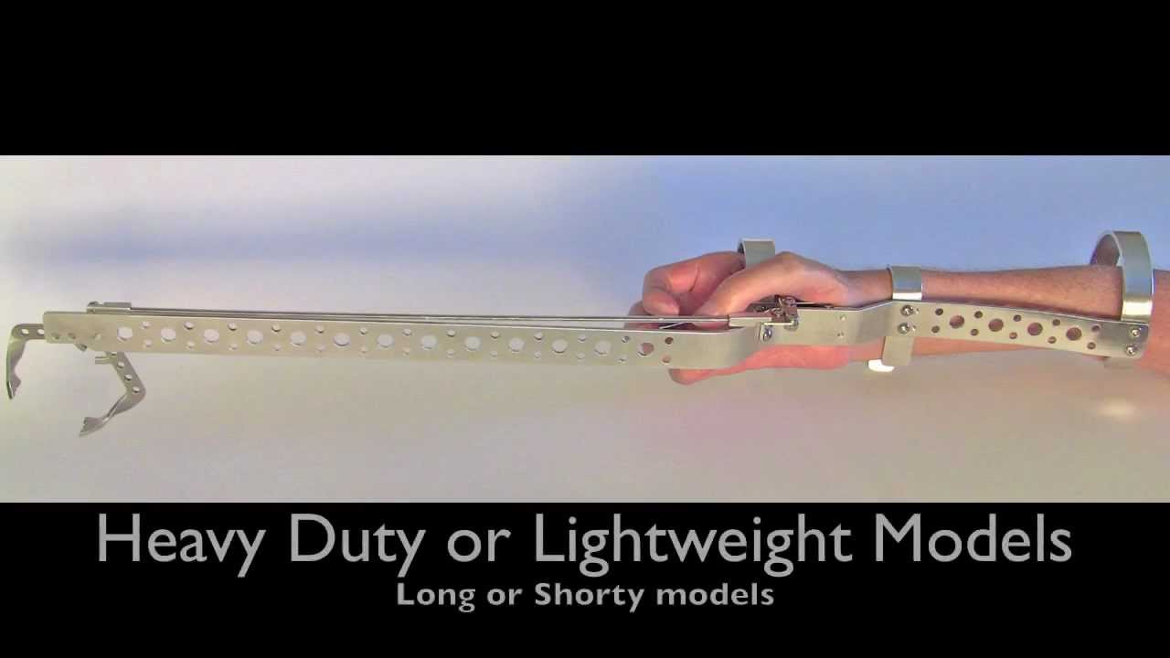

Thanks for posting this I am looking into drilling on a cnc router for a friend that needs to drill hundreds of holes in 3/16 aluminum bar stock.
How long did the drilling take? When I entered it in a drilling calculator it comes out to under a second.
I’m hoping he can reliably run an 1/8" stub drill with air blast and light lubricant mist. He needs 1/8" and 3/8" holes. My thinking is drill everything with the 1/8" drill then use a 3mm Datron single flute stub mill to go from 1/8’ to 3/8" where needed.

I like the idea of drilling out the center of the 3/8" holes with the 1/8" bit and then milling out to full size. I’m assuming the latter would be done at full depth to spread wear along the length of the cutter.
Yes it will ramp down to full depth then open it up. I figured pre drilling will help take the plunging load off the endmills work and speed up the cycle time. The work will be done on a Tormach 24r which is a linear rail ball screw machine that should be fairly rigid. Had the HDM foot print been large enough I would of had him go that route but he needs 40" of travel for his parts.
He has been hand machining and drilling 1000’s of holes to make adaptive reachers for quadriplegics every year for the past 20 years on an old bridgeport knee mill so I’m excited to help my friend to get into doing Cnc work for the first time. His tools changed my life and I couldn’t live independently without them so to help him help others is a pleasure and the least I can do.
Here is a video of how each reacher is made 1 at a time solo in a little garage shop.

I looked into them as the first option but I don’t know long the sharp point will last with non stop drilling. From my understanding they are for light drilling not for constant drilling as the point quickly wears out. I couldn’t find any drill mills with 118 degree tips.
The holes will be drilled prior to bending with only 2 holes being drilled in a angle jig. I had him try it flat but those hinge holes deformed when bent so they have to be done after the bend.
