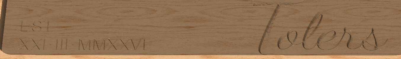

I’m starting my 3rd CNC project for a wedding present. I’m using Eric Ahrens’s Serving Tray With Dip Bowl design and have simply added some text to the bottom of it.
I realize I’m running out of vertical room in the pocket to be able to etch this text, but my walnut is actually about .06 thicker. I will adjust this. I’ll be adding tabs too.
In the mean time, would someone with more experience than I please do a once over on the tool paths of my text to see if all looks good? Any suggestions/tips would be welcomed.

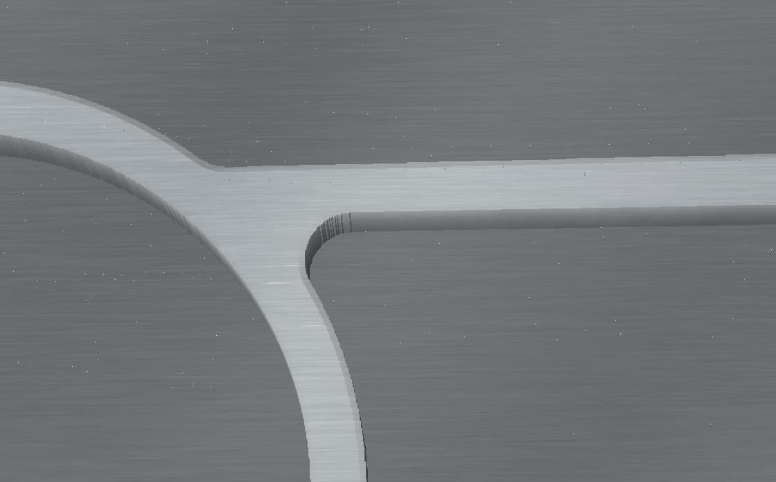

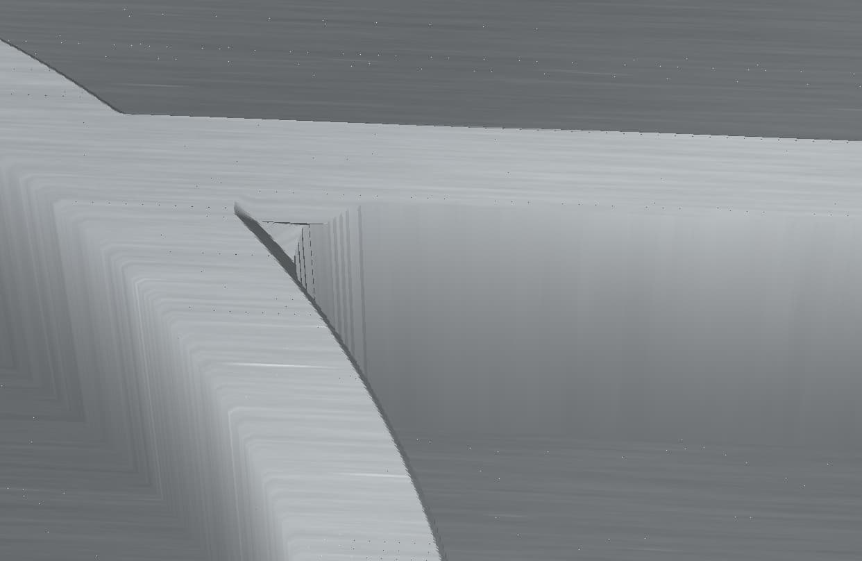

Looks amazing.
My only suggestion is to filet the corners. The chamfer pass with the .25 EM pocket will leave a small piece of wood in there.
. I just added some rounded corners, so the chamfer will not leave that little corner piece.
Toler Wedding Tray filet corner for .25 em.c2d (1.0 MB)
Alternatively, you could run an inside contour with a .125 or smaller bit to hog out that little area.
Thanks Anthony. Much appreciated. Did the text at the bottom of screen look good?
Curt
The text looks great.

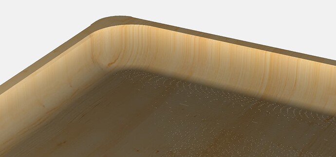

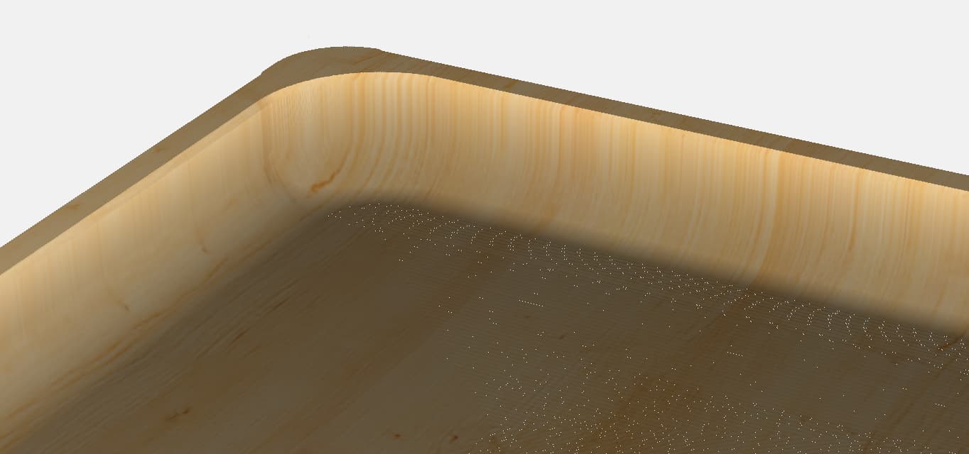

The other suggestion I have for these types of Valet trays is to use a bowl bit. Using the .25 EM will give you a 90 Degree angle at the bottom of the tray, which makes it hard to pick up things like coins, earrings, etc. If this were my project, I would use a .75 Bowl Bit.
Amana .75 Bowl Bit on Amazon
Here is the how it would look using a .75 Bowl Bit. Note to make the Filets work with the larger bit size you simple select the vectors and do an inside offset vector using the diameter of the bit as the offset, then you repeat but select outside vector.

Your toolpaths look good, and adding the text in the pocket should work fine since your walnut is slightly thicker.
