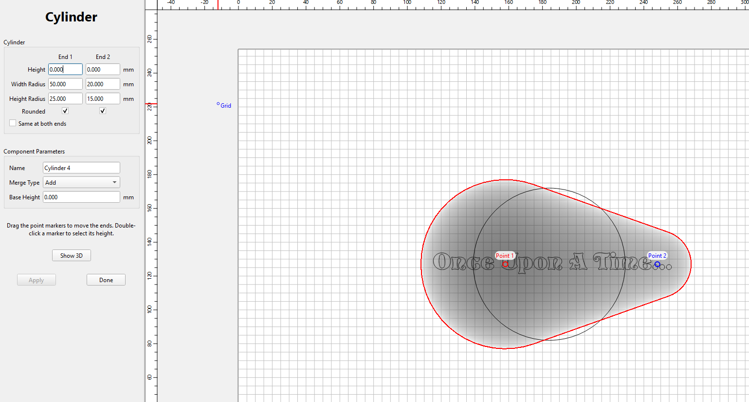

Oh yeah, that Tangency change to the Cylinder model visually feels so much better!

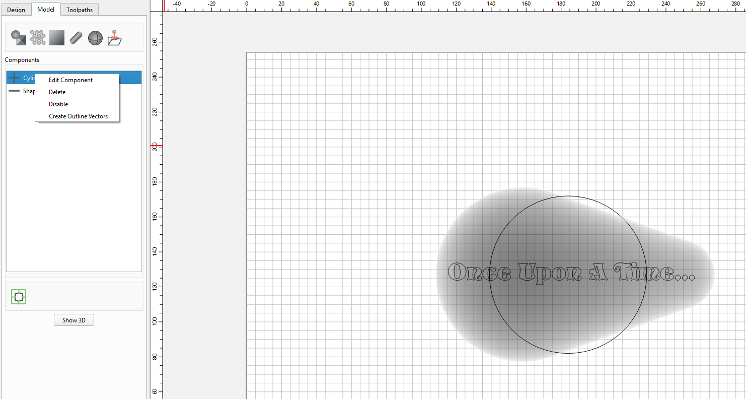

Another quirk I came across: attempted to create an outline of the test cylinder model to generate some toolpaths but the Create Outline Vectors function does not appear to work with it. Should it work? Will it work?

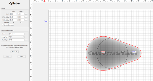

It simply does not create a vector outline of the generated model - tried multiple times with different height levels.
CC_CylinderTest v1.c2d (412 KB)

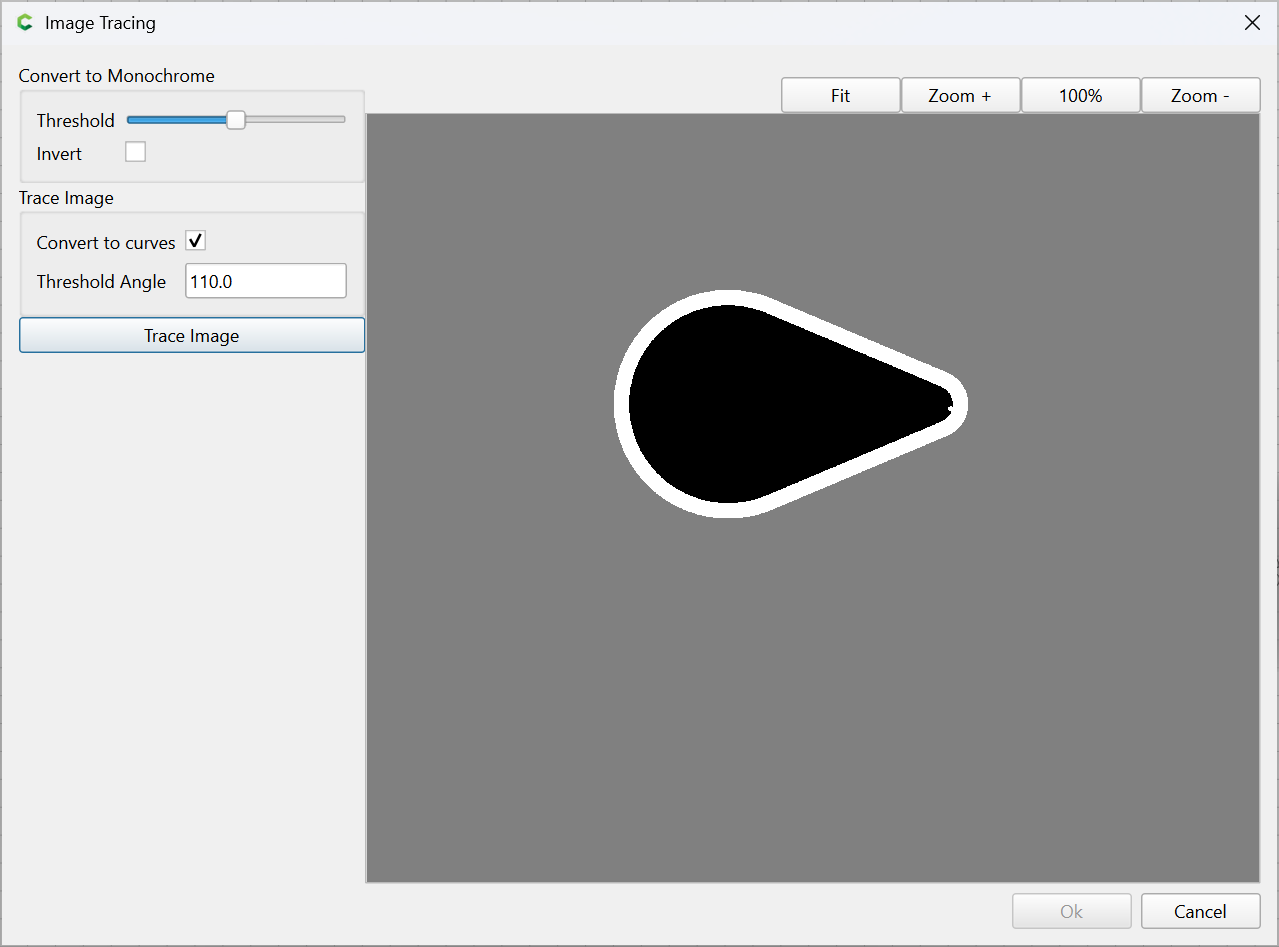

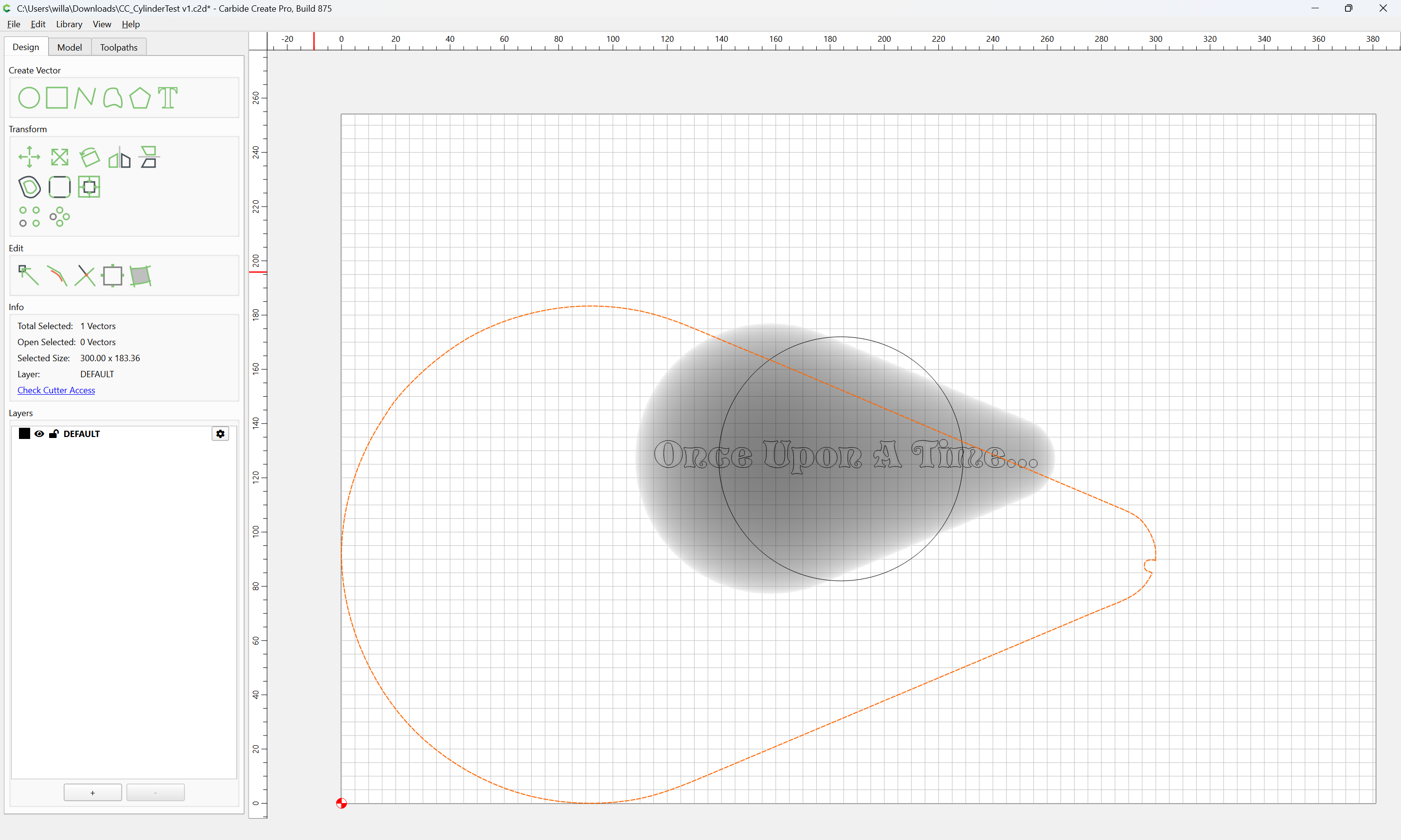

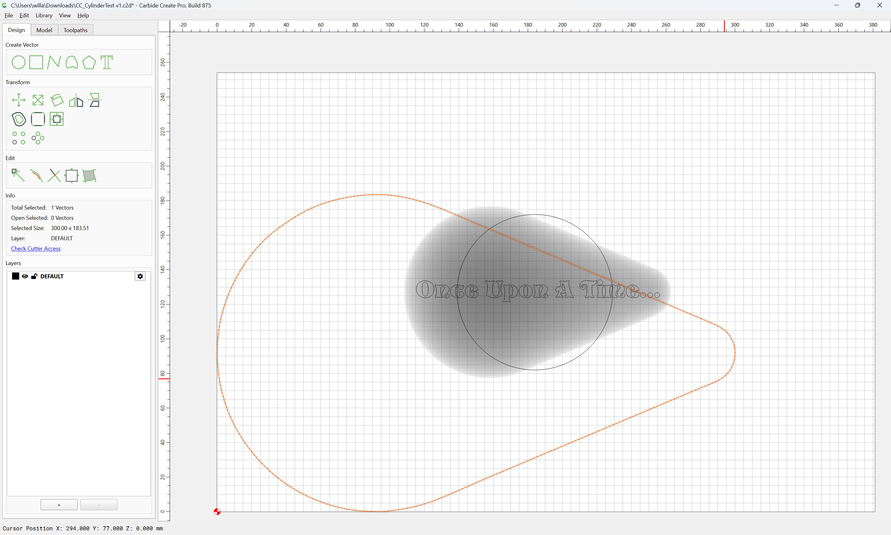

OIC.
Seems to be a bug. Until it’s fixed, export the pixel image, then reimport to trace:
EDIT: Note that the defect is caused by the subtraction.
and then scale and position to match.
