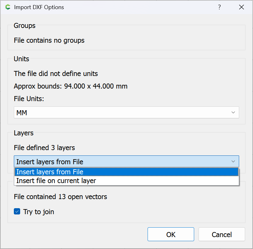

For folks who don’t have a DXF which uses the features which are now supported, here is an example of the import dialog:
Note especially the Layers drop-down:
where the option “Insert layers from File” means that an object which is on a layer in the DXF will be placed on a layer so named in the .c2d file:
(and if colour-coded, will then match)
