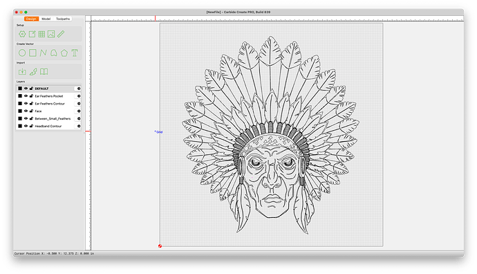

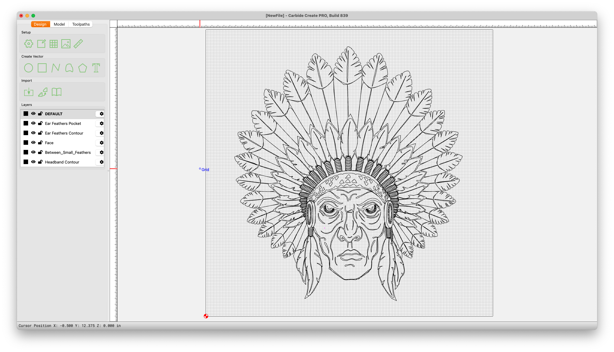

Hello and thank you for the beta. I’ve attached two images. One is an image showing dxf files imported in V7 and the other in V8. V8 is distorting the vectors in weird ways. I’m not sure how or why but wanted to give you the info that I saw. Adobe Illustrator CS4 exported as DXF files w/options (AutoCad Version 2004/05/06 • 1:1 Scale • True Color • Raster Format PNG • Preserve Appearance)

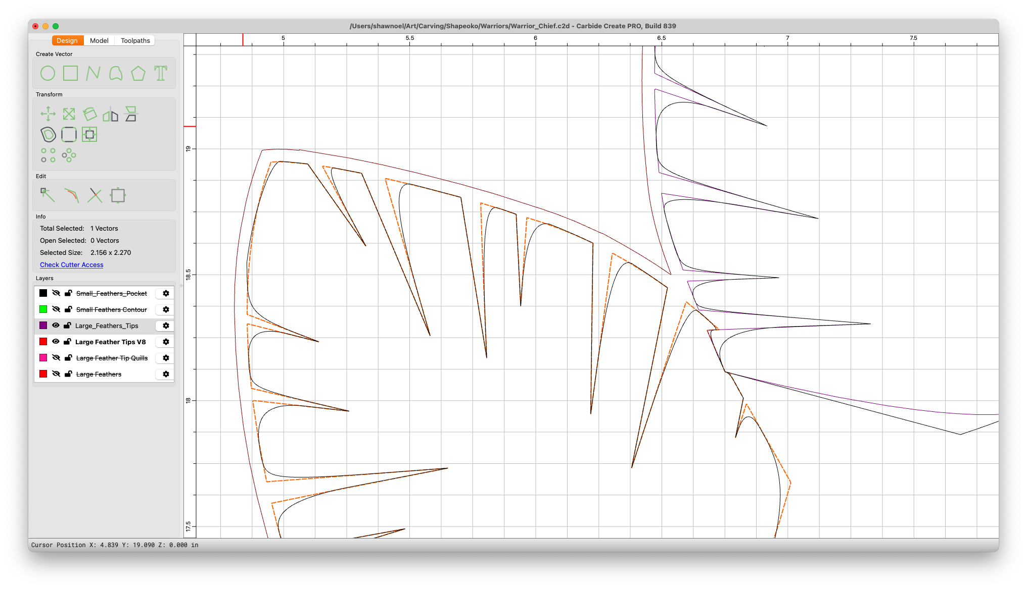

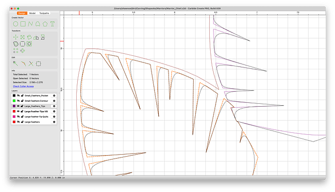

The biggest change was to the “Warrior_CFL_LargeFeather_Tips” however most files were affected.

Thank you! In the attached image it looks like it’s “bending” the corners or softening the corners, if that makes sense.
Yep, we were inserting extra knots when importing the splines.

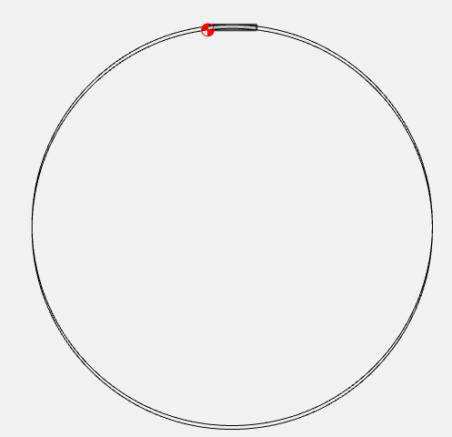

Thanks for the great work. Anything on the horizon which might include a dedicated tool for creating arches? Currently still having to greatly enlarge the document size, create circles, then chop off unwanted segments. Just curious; thanks.

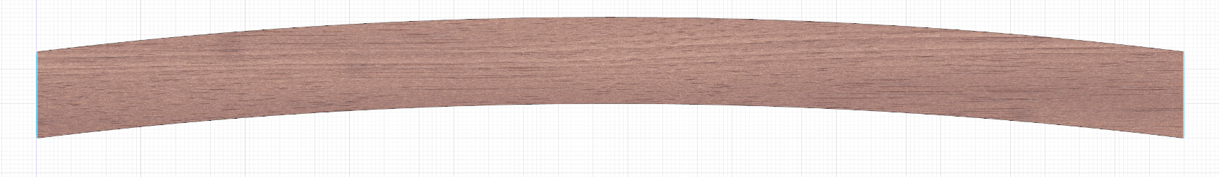

Here’s the shape I needed, drawn easily in fusion 360:
Width is 33 inches. The two arches are parallel, 2.5 inches apart, and each with a radius of 136.625 inches.
The apex (center point) of each arch is 1” above its respective end points.
I did not know you could use rounding corners to achieve this shape.

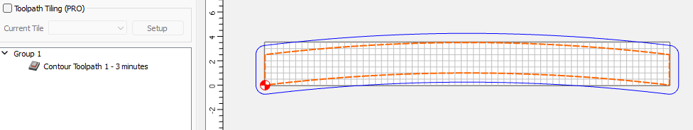

I temporarily enlarged the canvas size and drew two circles of the required radius, then chopped off desired segments. This worked, but cutting on the machine was very slow because there were four tool paths instead of just one. Each path was cut one at a time and not in order according to position. Very inefficient. By the way, that reminds me of another question, is there any way to re-order the segments when drawn or to combine them into one tool path?

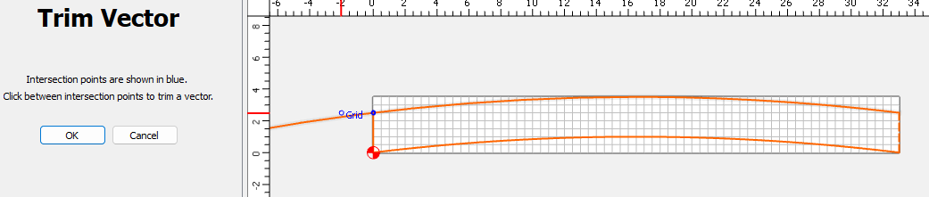

You don’t have to enlarge the workpiece (canvas size). You can draw the circle outside the workpiece & move it into position. BTW, I calculated 135.625
So start with the 2 arcs drawn & in position.
Trim them

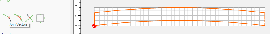

Then join them into a single vector
Now you should get a single contiguous toolpath
