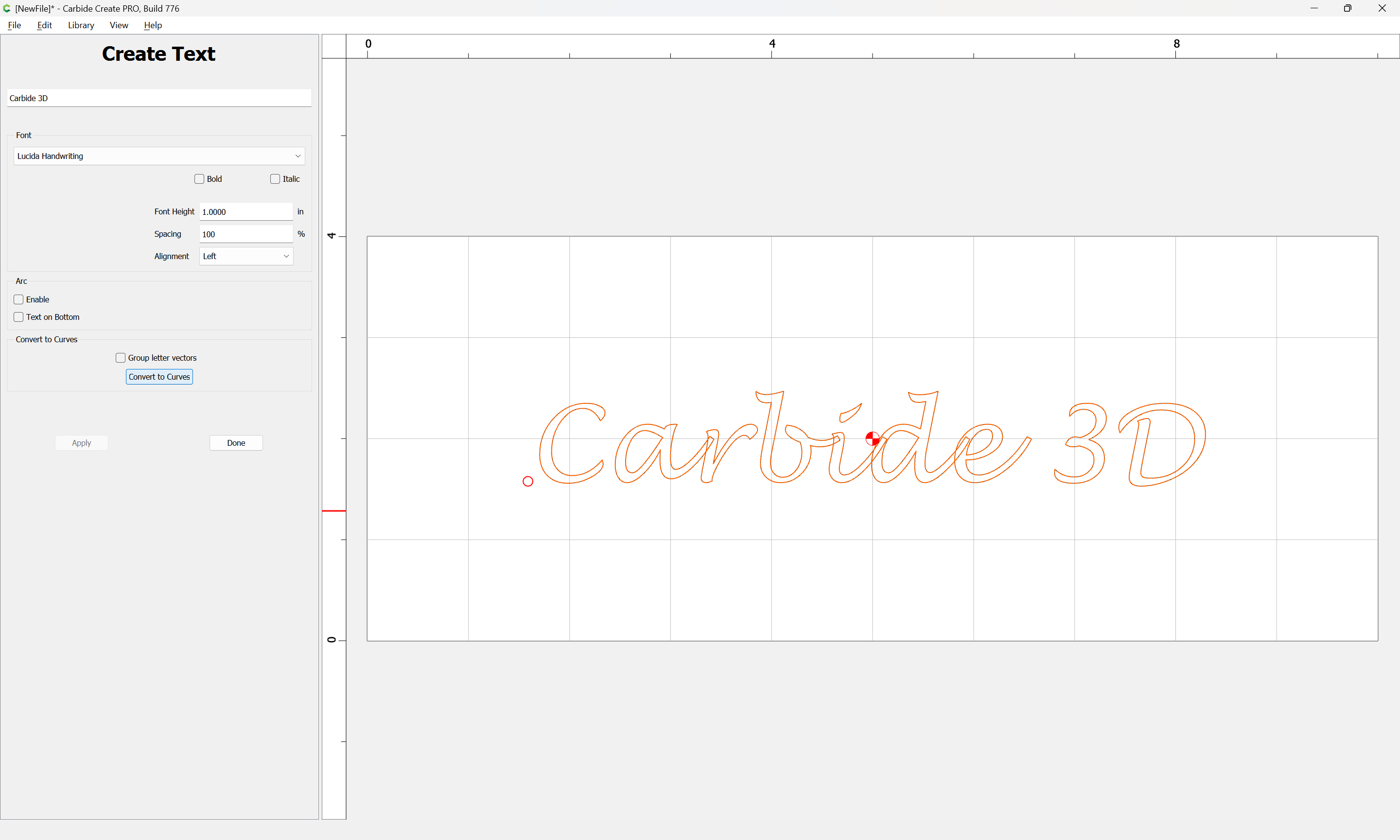

Actually, there are two separate operations, with slightly different results.

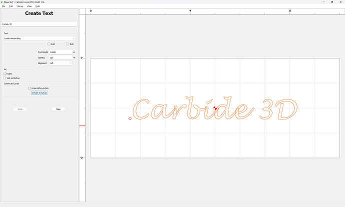

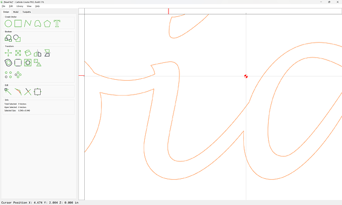

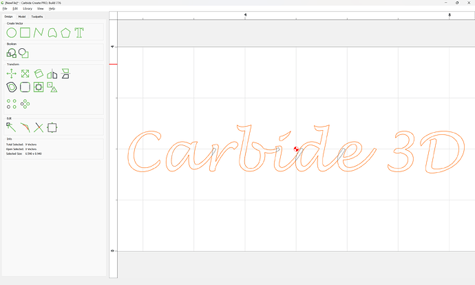

Convert to Curves as described at the link:
results in a direct conversion:

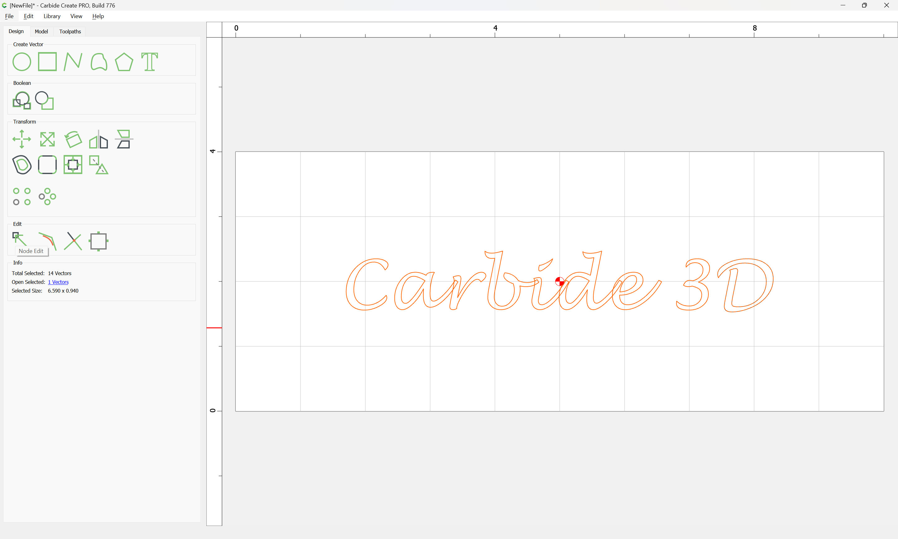

with curves:

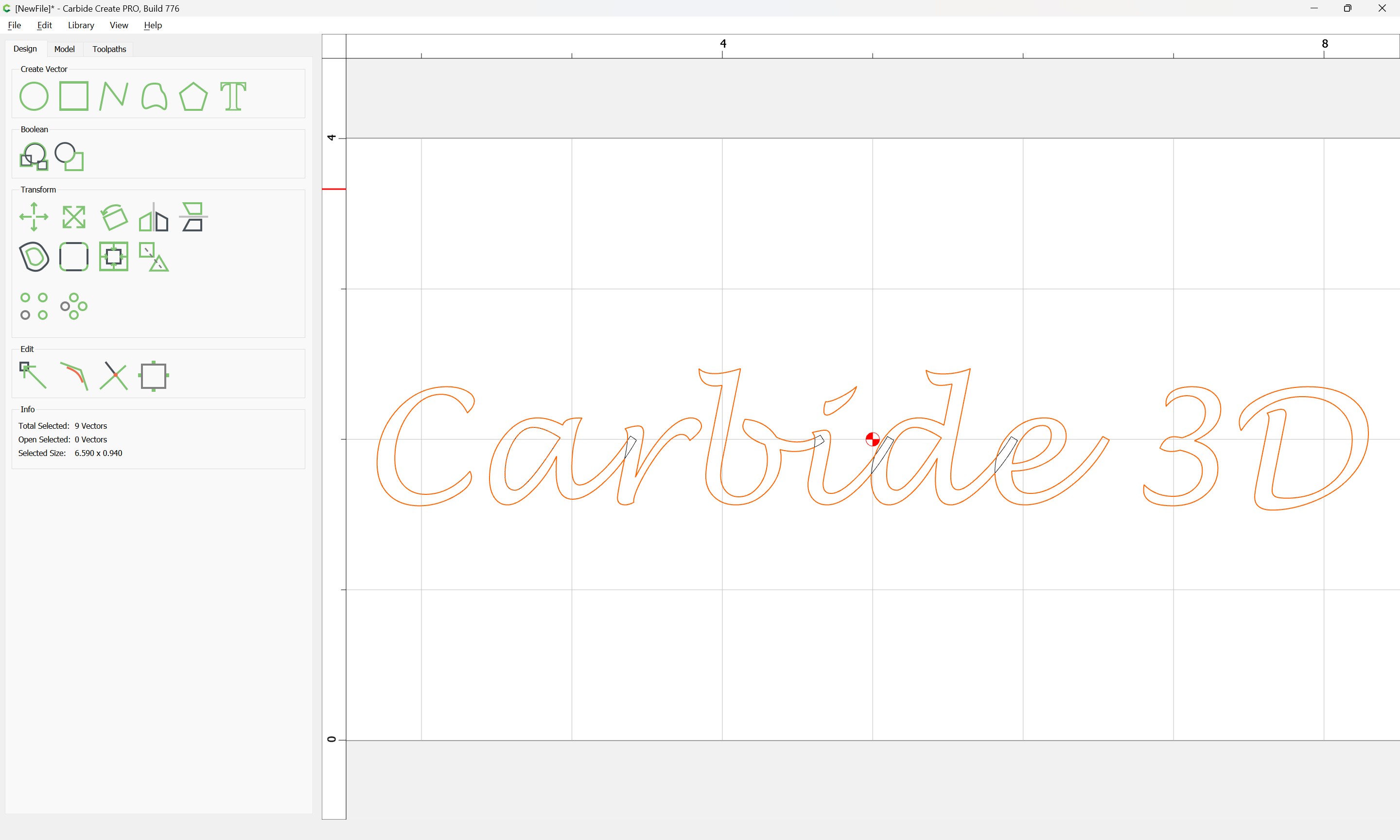

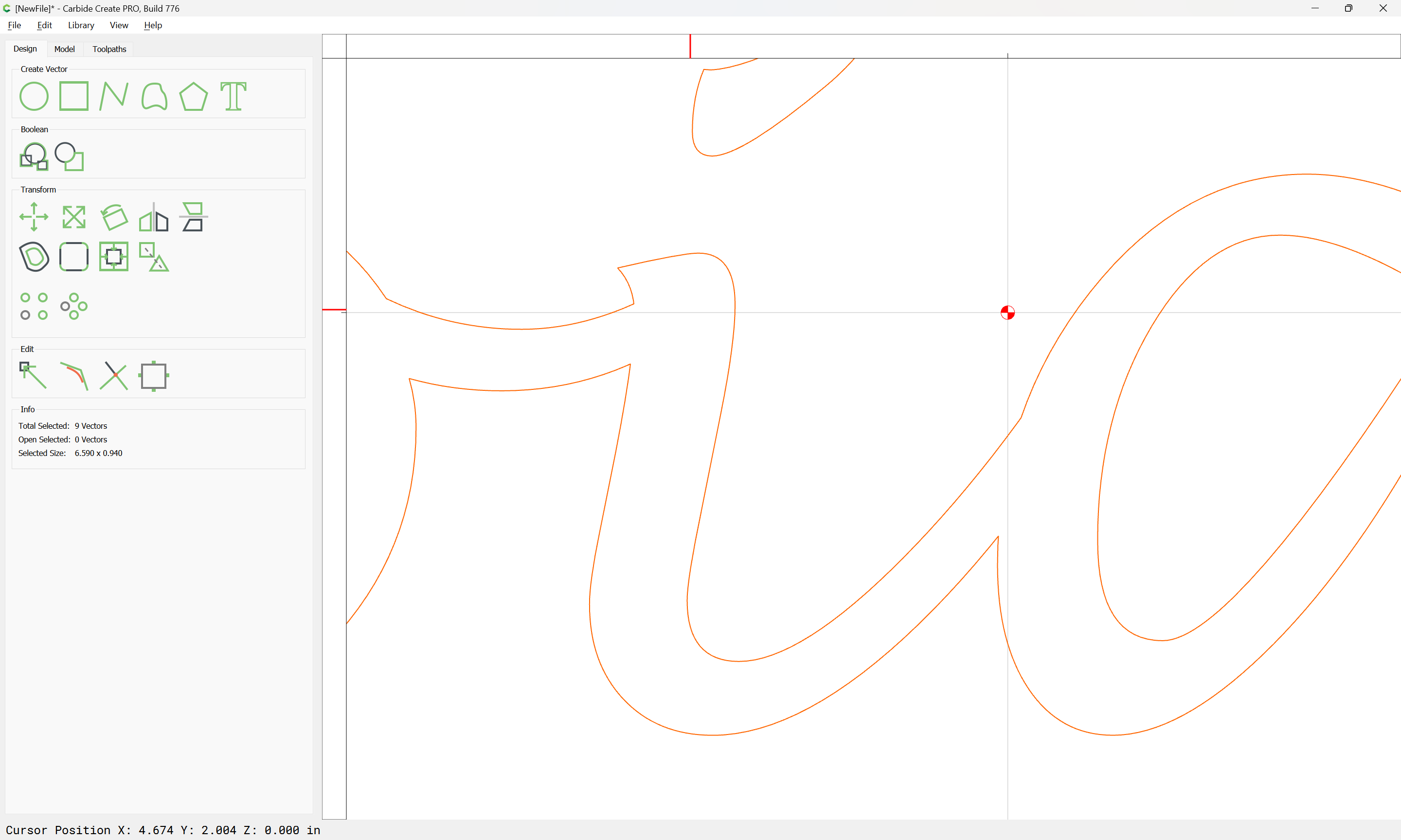

but note that it does not resolve any overlaps:
which would need to be dealt w/ using Boolean operations or (ideally) Trim Vectors.

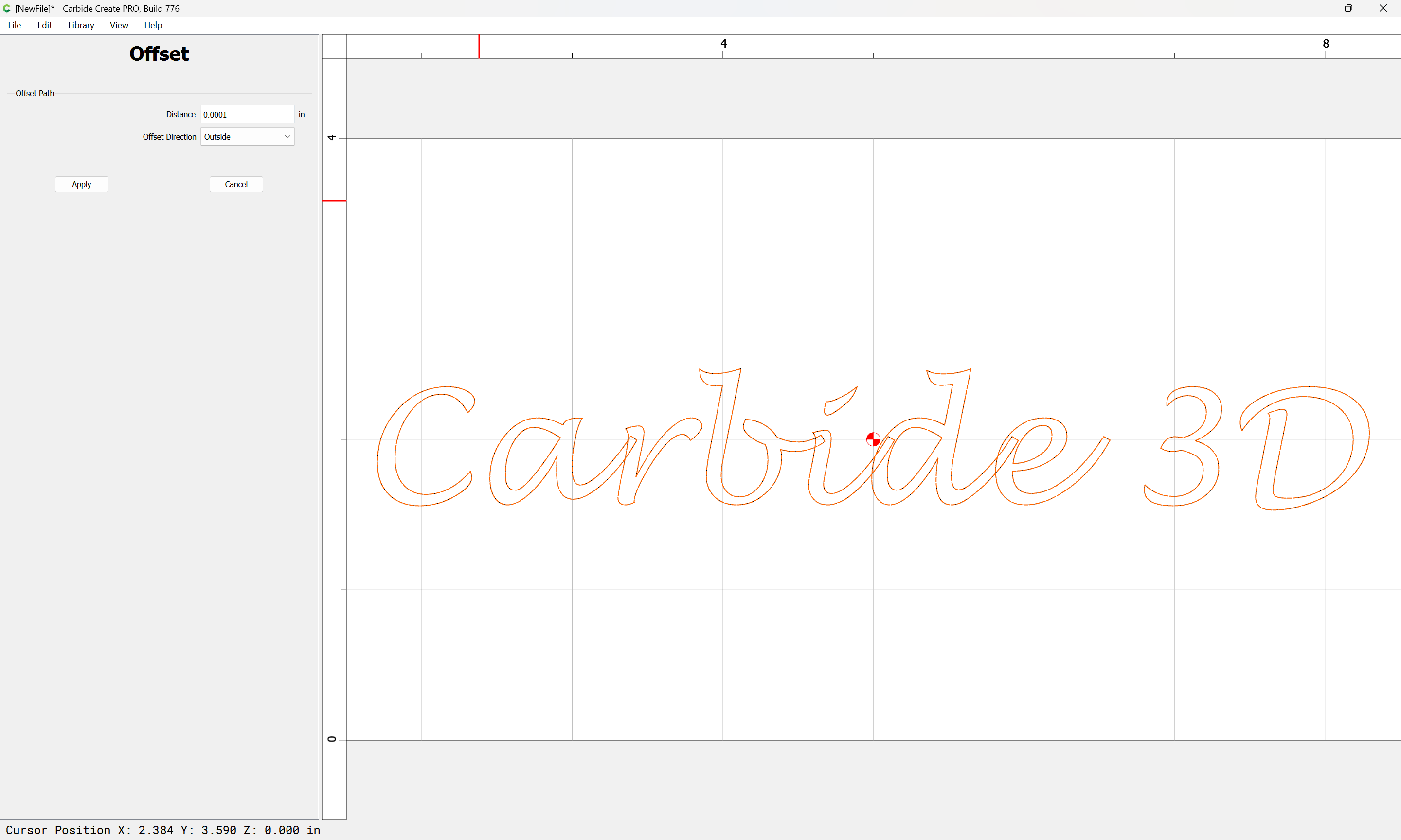

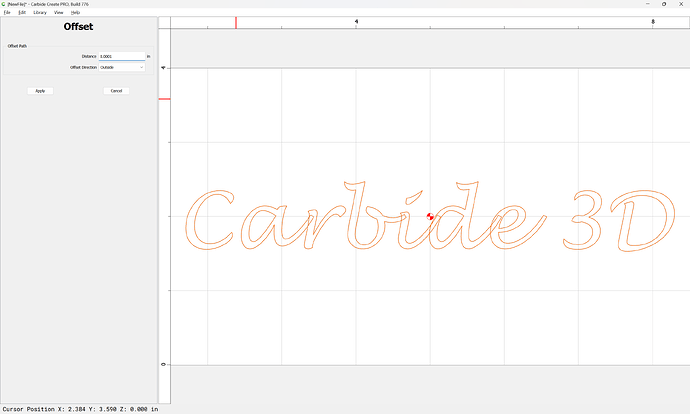

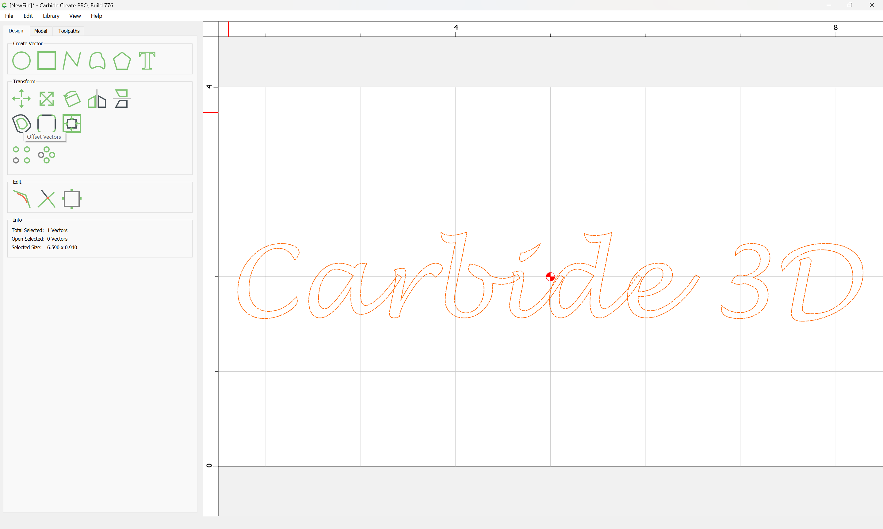

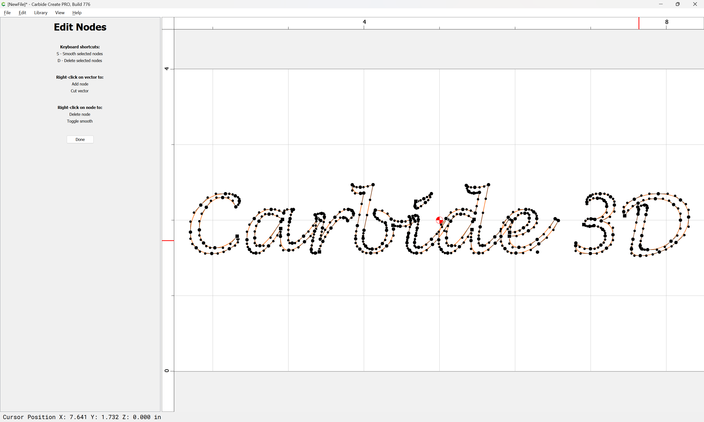

Outlining (using the âOffset Vectorsâ command):
and be done with a very small dimension:
and will resolve overlaps

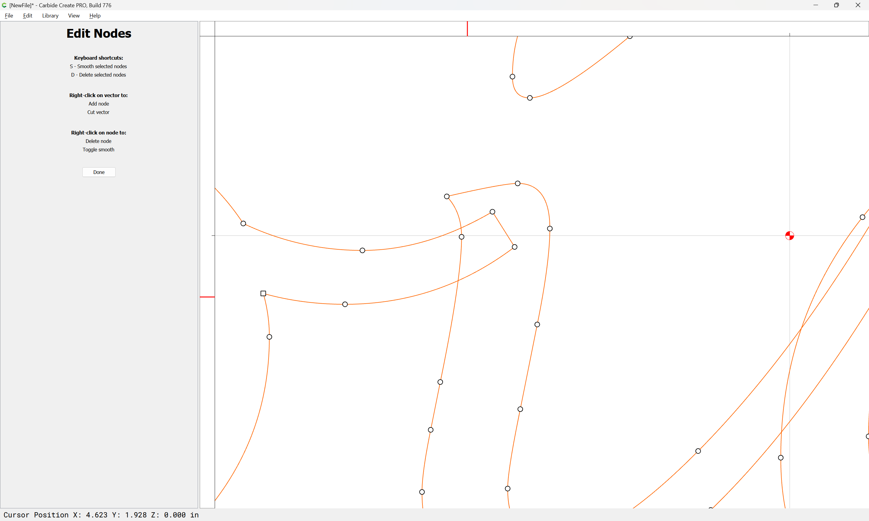

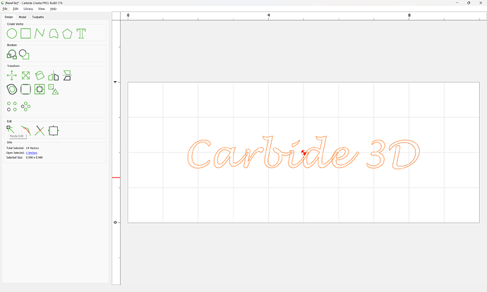

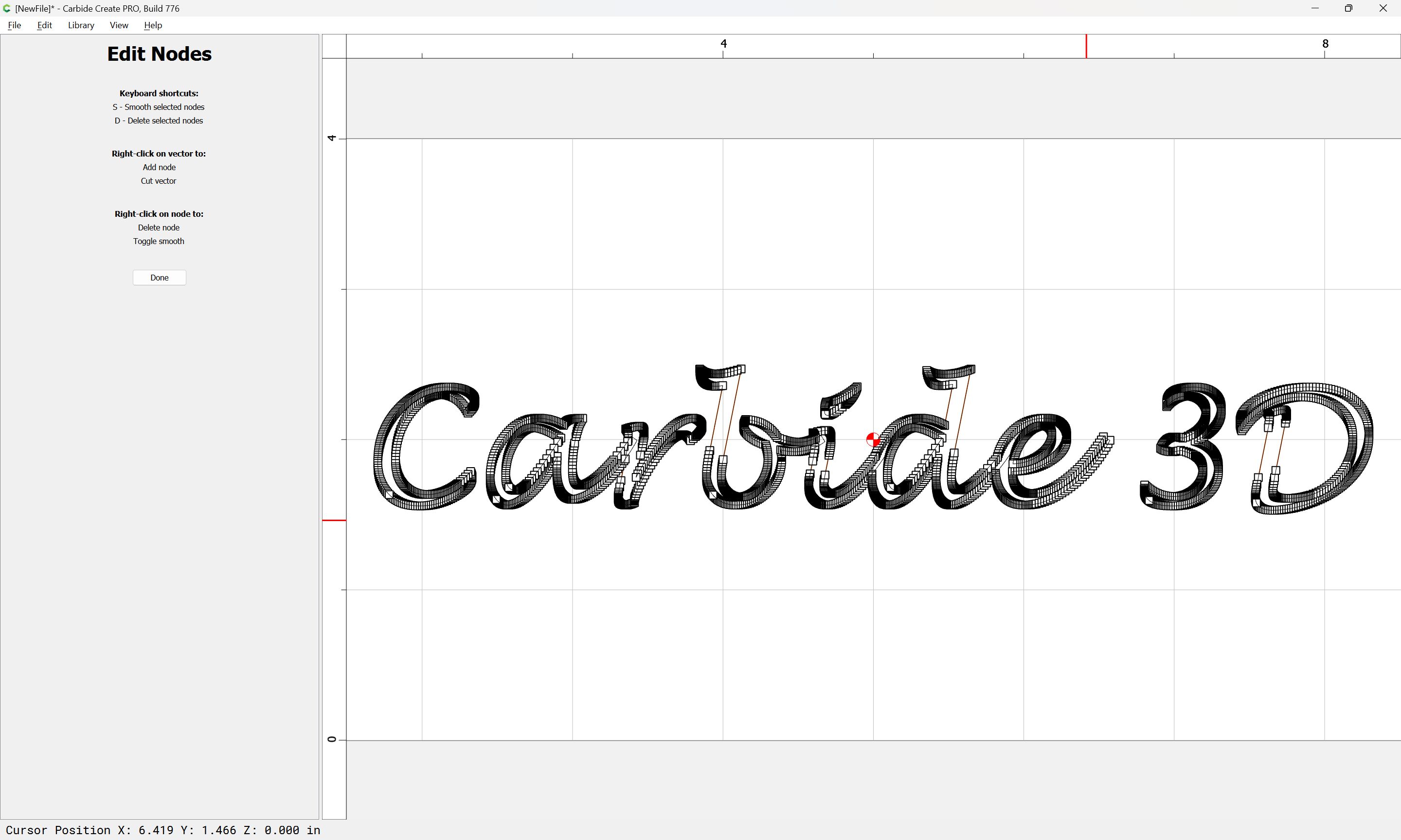

but will result in a polyline:
which is essentially uneditable.
