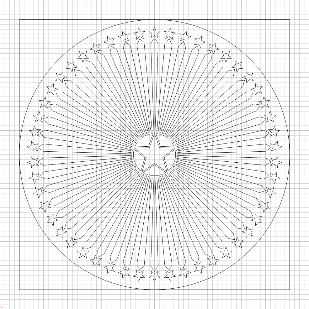

I have seen this pop up when I import a DXF with certain formats.
If you have options when saving a DXF try some different settings.
Currently “2004 Lines” has worked best for me.
Try this file and let me know if it works.
51 StarBurst Design - for a clock face or…
51 starburst 14 inch.dxf (383.9 KB)
Your file worked great, thank you!
