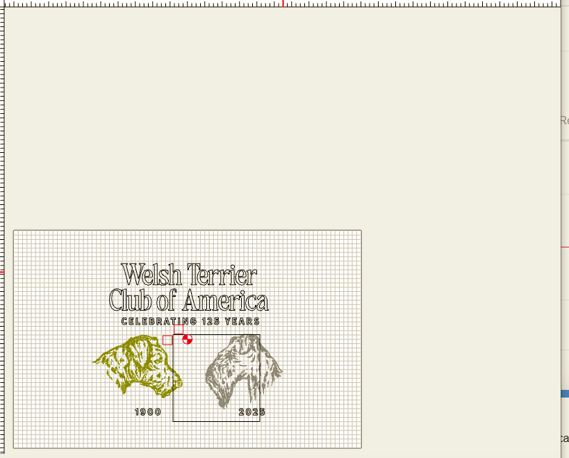

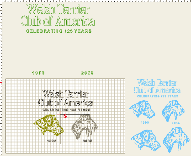

Items that are hidden still affect the extents calculated for ‘Fit View to Job’.
Everything visible:
Items above and to the right of stock hidden:
I would expect that only visible items would affect ‘Fit View to Job’.
Everything visible:
Here is a simpler test file showing the same issue.
