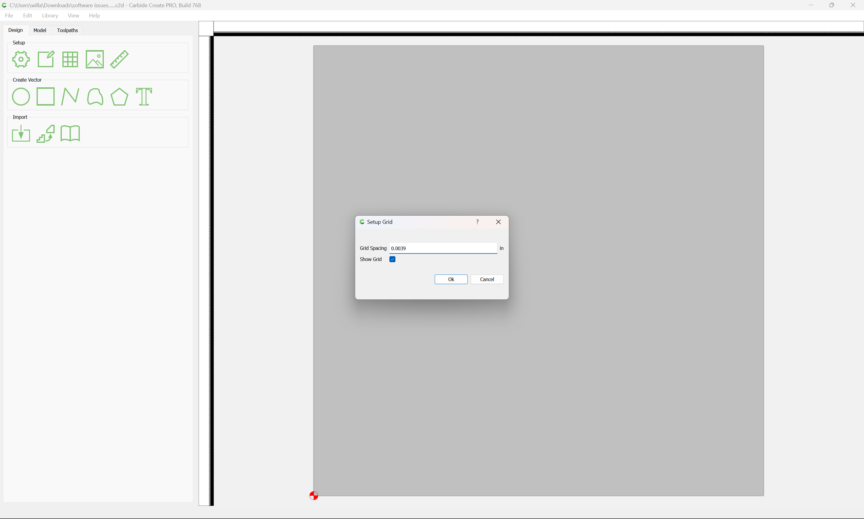

I am running Build 764, built on 2023-10-31, When I open Carbide Create my working area is zoomed so far out I cannot recover it back to normal viewing… any ideas whats going on with this software… when I change the working area using the “Design” tab it reverts back to being zoomed way out…

To fix this, it should work to do About | Carbide Create | Open Data Directory, then go into th Carbide Create folder and delete the settings.ini file

Thank you, that seems to have worked I appreciate you help…
The video seems to be a duplicate of the .c2d file.
The problem seems to be that under some circumstances, when changing units the grid will be set very small — if one then changes the grid spacing to a more reasonable dimension things go back to normal:
