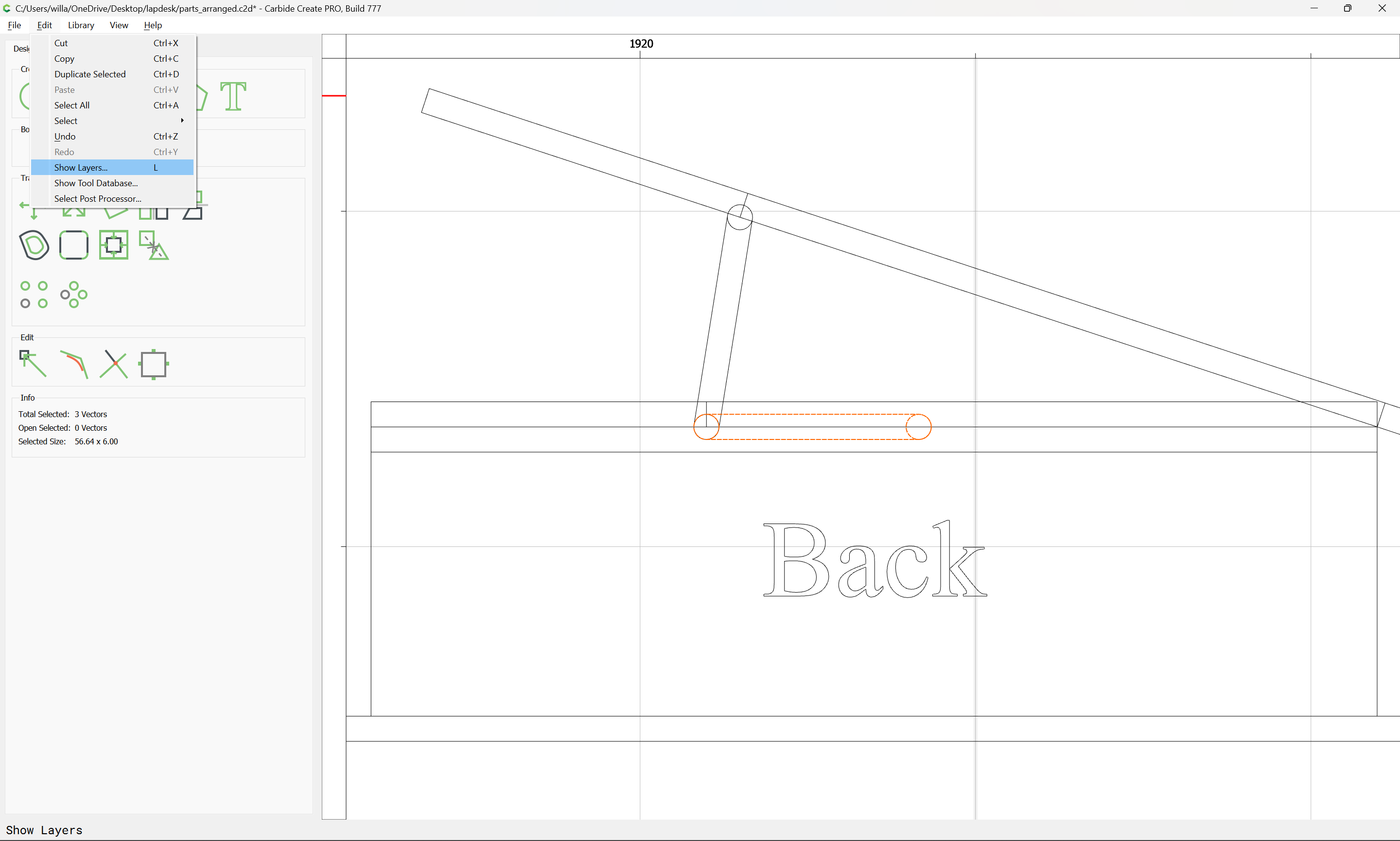

I’d very much like a deeper understanding of LAYERS.

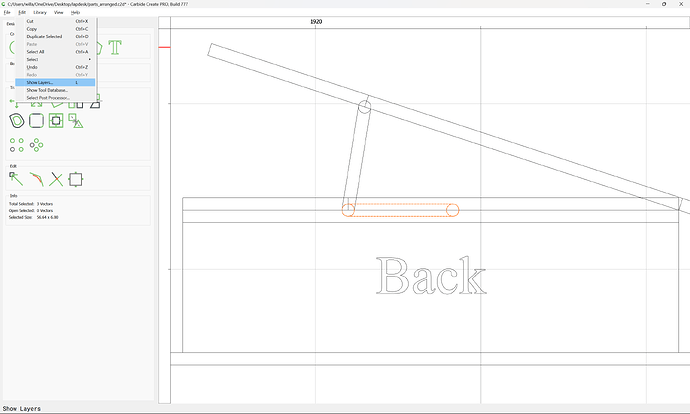

Layers may be brought up by:
Edit | Show Layers

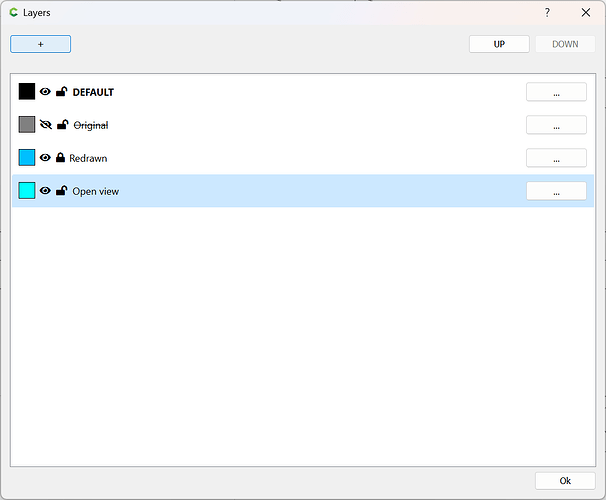

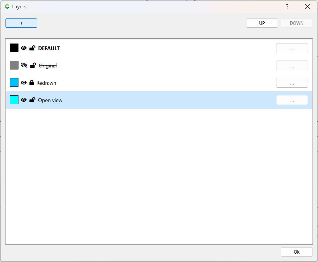

and may exist in one of several states:
  • ACTIVE (indicated by being bold, must also be unlocked and visible/not-hidden) — all new objects will be created on the ACTIVE layer
  • Hidden (indicated by strike-through)
  • Locked (indicated by closed padlock)
  • not ACTIVE — elements may be selected/manipulated

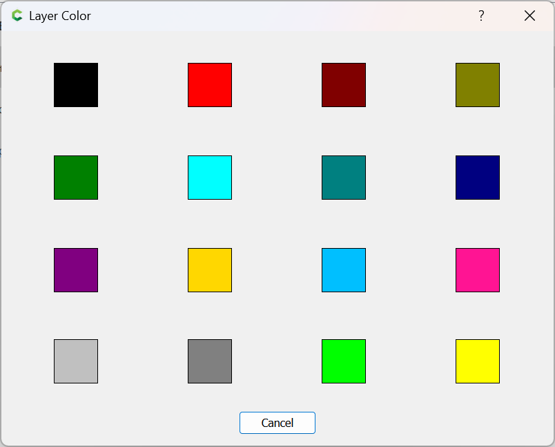

Layers may be colour-coded:
​How they are used, depends on a given project and how a user wishes to approach it:
  • a two-sided job might have separate layers for each side ​
  • a file with multiple parts might have each part on a separate layer
  • a file with multiple tools or which has different types of toolpaths or toolpaths which cut to different depths might have the geometry for each tool/toolpath type/depth on a separate layer, and use the Toolpath facility to associate a toolpath w/ a layer ​
See:
https://willadams.gitbook.io/design-into-3d/2d-drawing#layers
and
