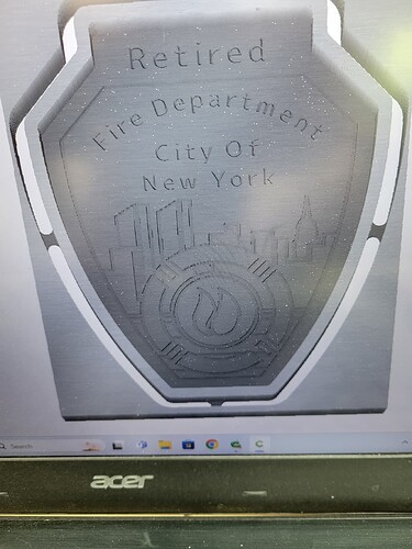

My design looks correct in CC (See pics 1, 2, & 3). But the machine is cutting wrong (see pics 4 & 5). I rebooted everything after picture 4 cut. But it is still wrong in cut 5. Any ideas what may be wrong?
It looks as if what is happening is either the machine is losing steps while cutting the earlier operations, or the machine is being shifted when the tool change is made.

That design is being cut at the bottom of an 0.5" deep pocket:
(note also that it is a bit close to the edge of the pocket and some of the wall is being cut away by the V endmill)

It looks like, in both cases it is failing cutting the horizontal lines in the “City” toolpath. (red)
The next feature cut is the green line, which should be directly above the top horizontal line in that area.
Either the cutter is binding, or something is preventing the machine from moving to the right.
Your toolpaths don’t look unreasonable, S&F and DOC look OK. However, you are “slotting” with a 1/16" tool 0.100" deep. Your “Words” toolpath should be cutting about 0.030" - 0.035" deep.
Try running the path and cutting air. Set your Z zero about 1" above the part & run just the “city” path.
Try to set the job in the same place in X & Y. If there is something going on mechanically in that area, you should see it fail. If not, then it is likely binding in the wood, or getting hung up on something.
