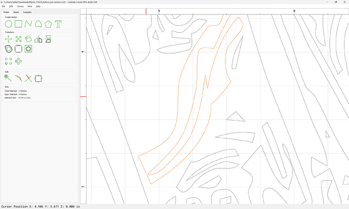

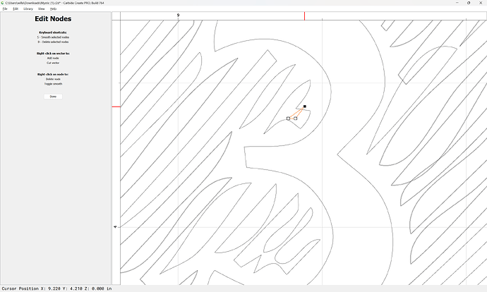

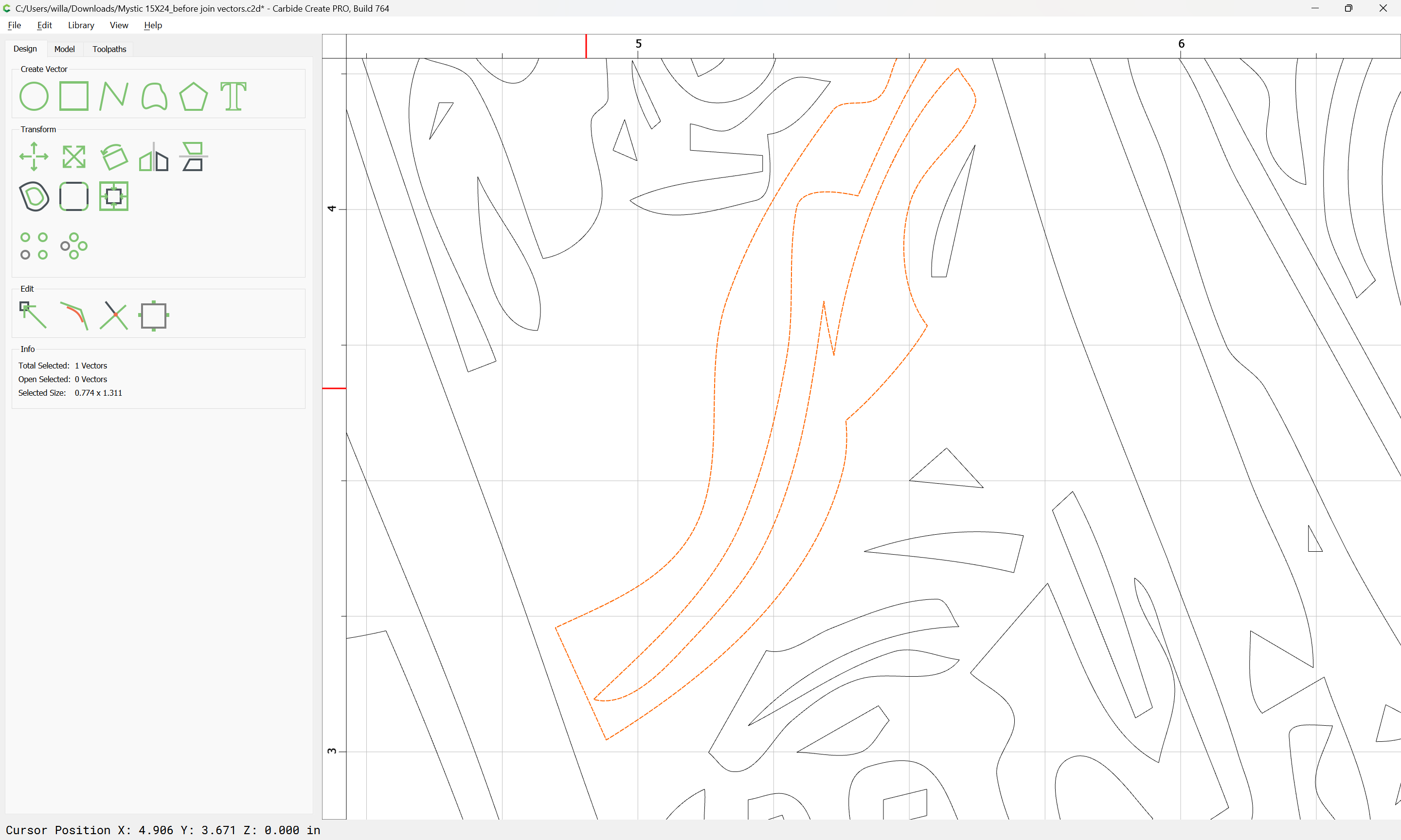

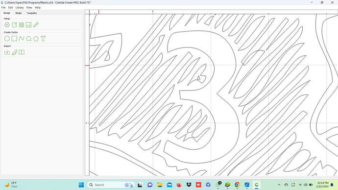

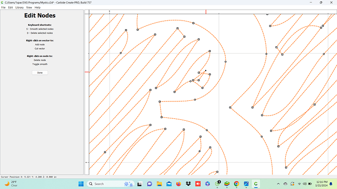

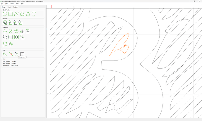

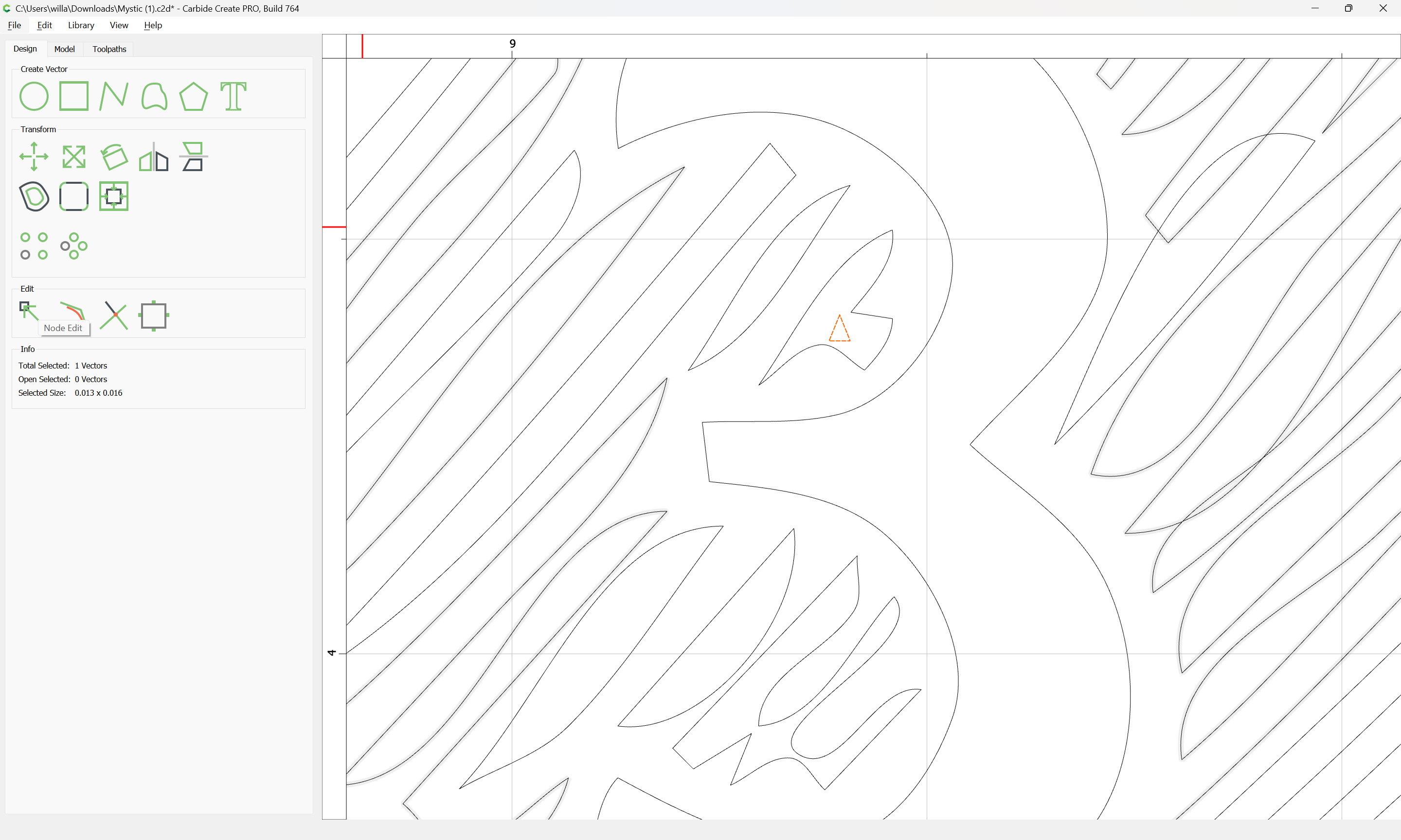

So you can see that little triangle in the inner curve of the 3 is where I join that little triangle together with the bigger vector. This time I had to click back on the edit nodes tab to get the program to crash. It might not be the crash by clicking on the edit nodes tab. It might just be taking time for the program to crash.

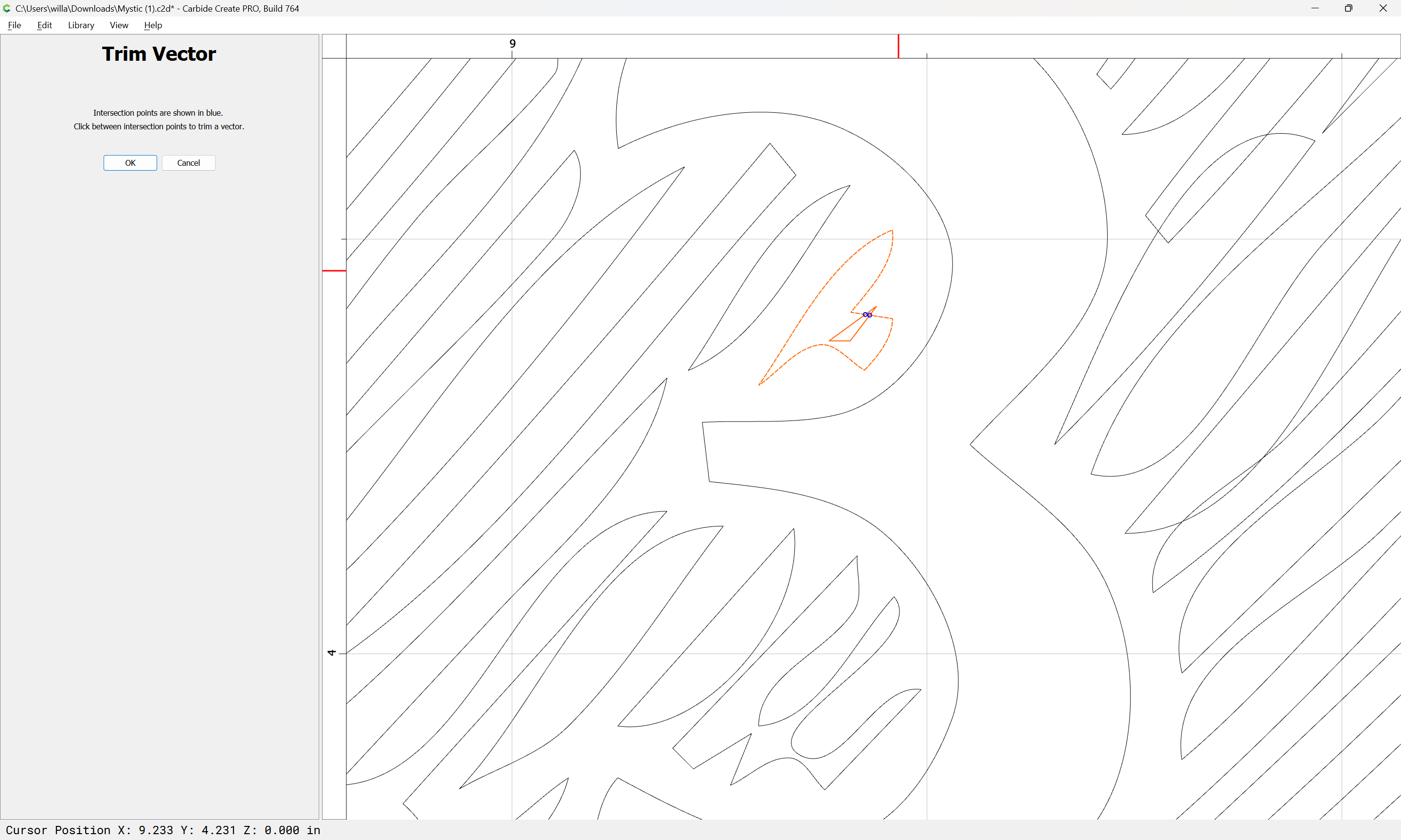

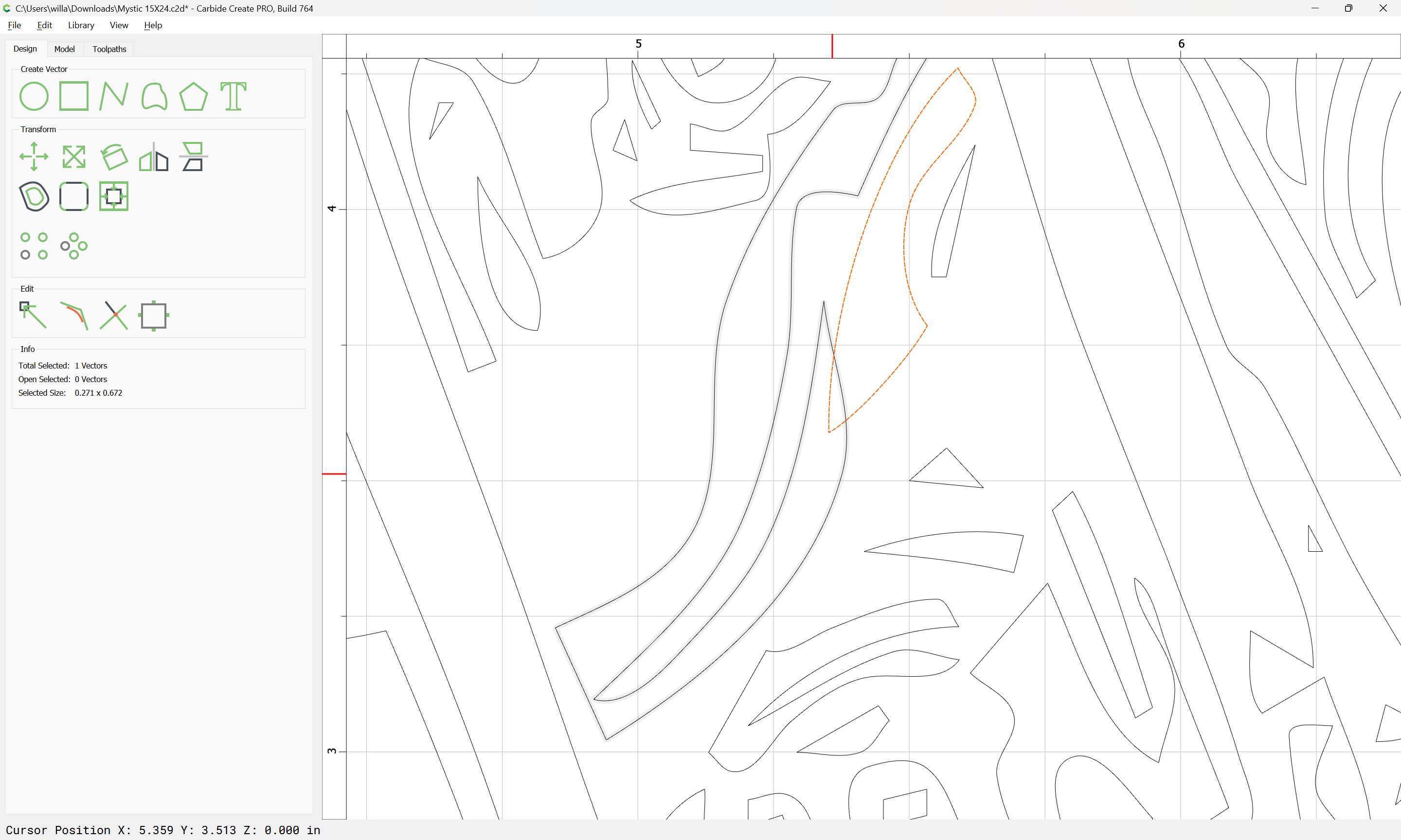

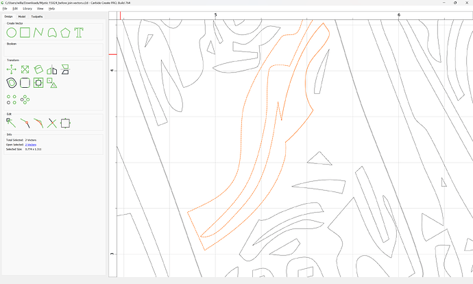

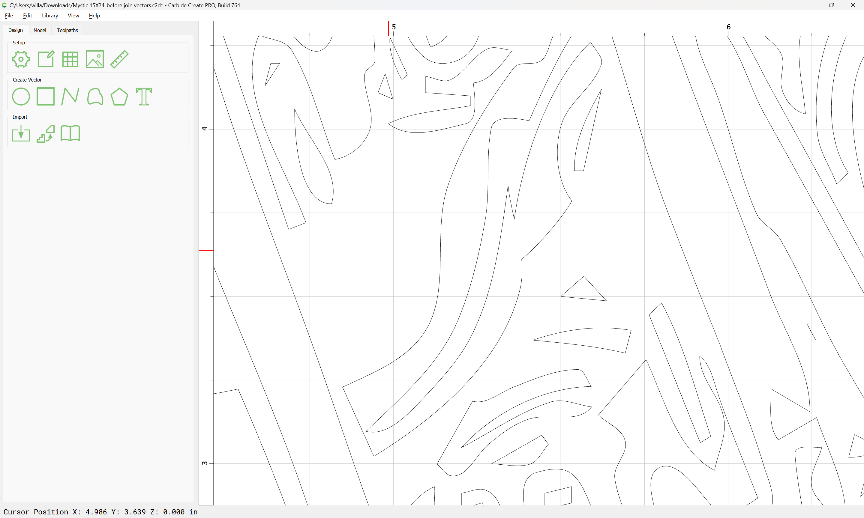

Okay, following along:
Done

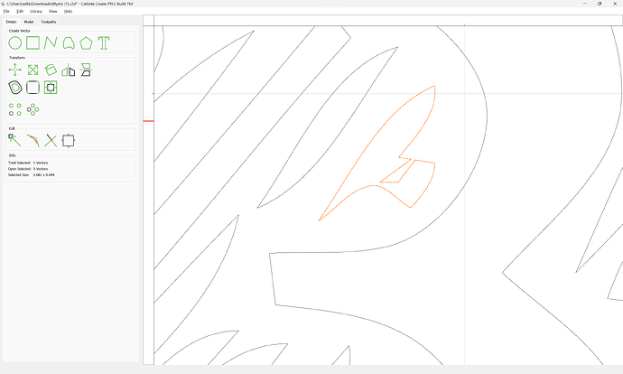

Rather than work with the entire selected geometry:
Ungroup if need be
Select only the two elements which interact:
go into Trim Vectors mode:
OK
OK
Join Vectors
Here:
Mystic_edited_v7.c2d (1.4 MB)

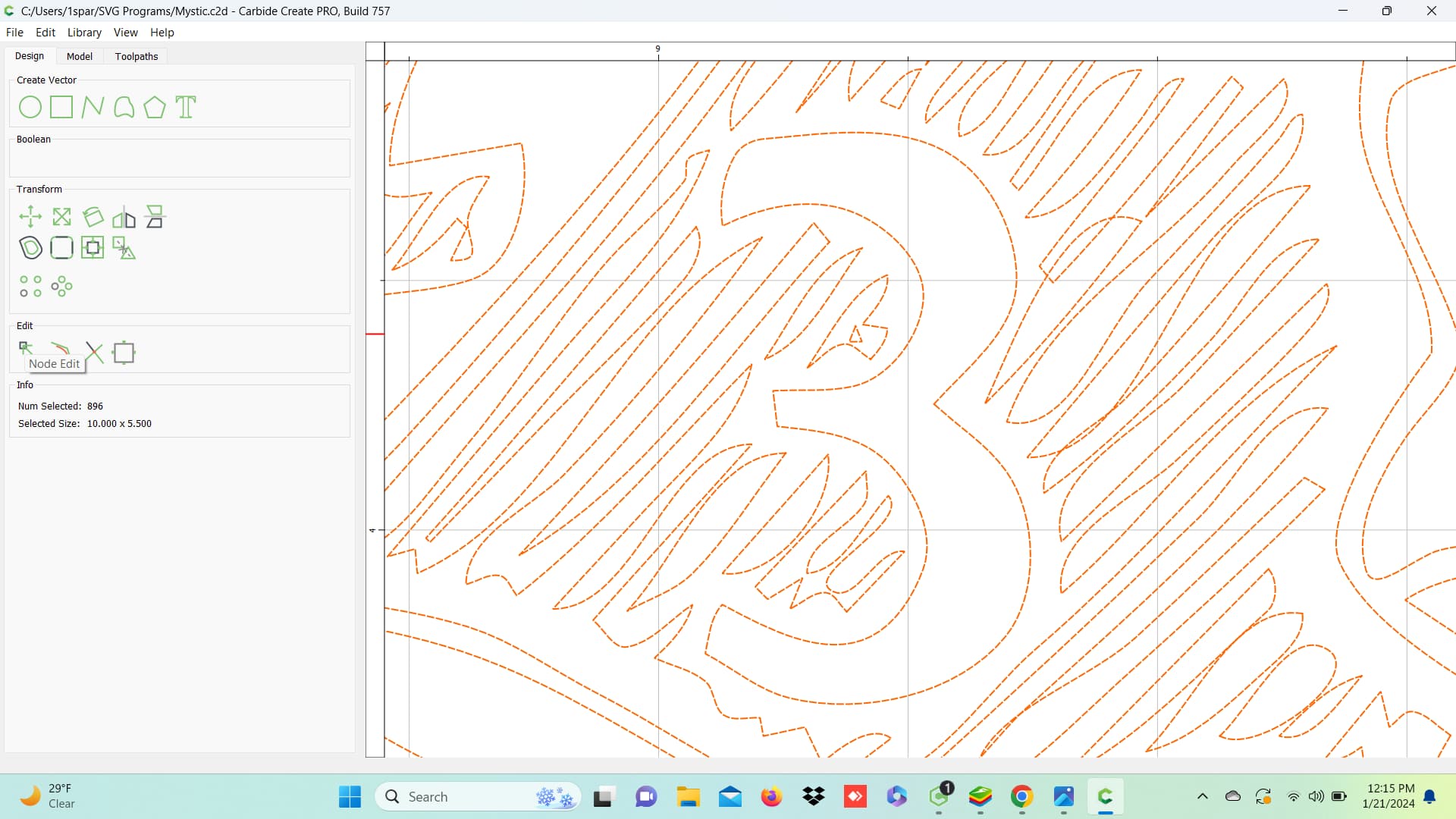

I had this design you see all adjusting in many of the troubled areas. I added in many vectors to get my tool to cut along a line i desired. I had added a border. I had also given the design a pocket cleanout between the outer border and the inner border I created around the inner picture. I also added texture in this void area. The created my own Jack of Hearts to be finely detailed in it’s carving at the bottom left of this design. I was working on the last element of this completed design of the Jack of Diamonds below the Jack of Hearts and was going to have to stack text/pics in order to get them both to be created with depth.
Everything was completed all the way up to the stacked text/pic of the two cards, and then my design would have been finished. I trimmed a vector and then joined them and the program crashed erasing everything I worked on. Lesson learned on my part is to save often and save always.

Ok. Well, not sure what is happening on my end then, because each time I join vectors after trimming them, the program just disappears and takes any changes that havent been saved with it.

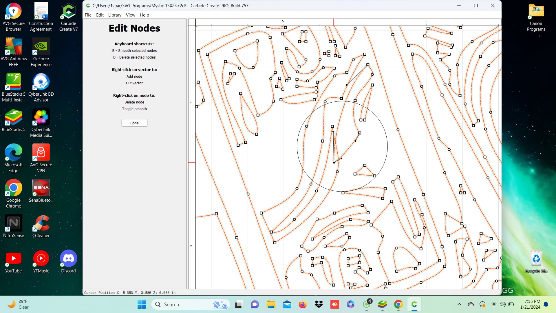

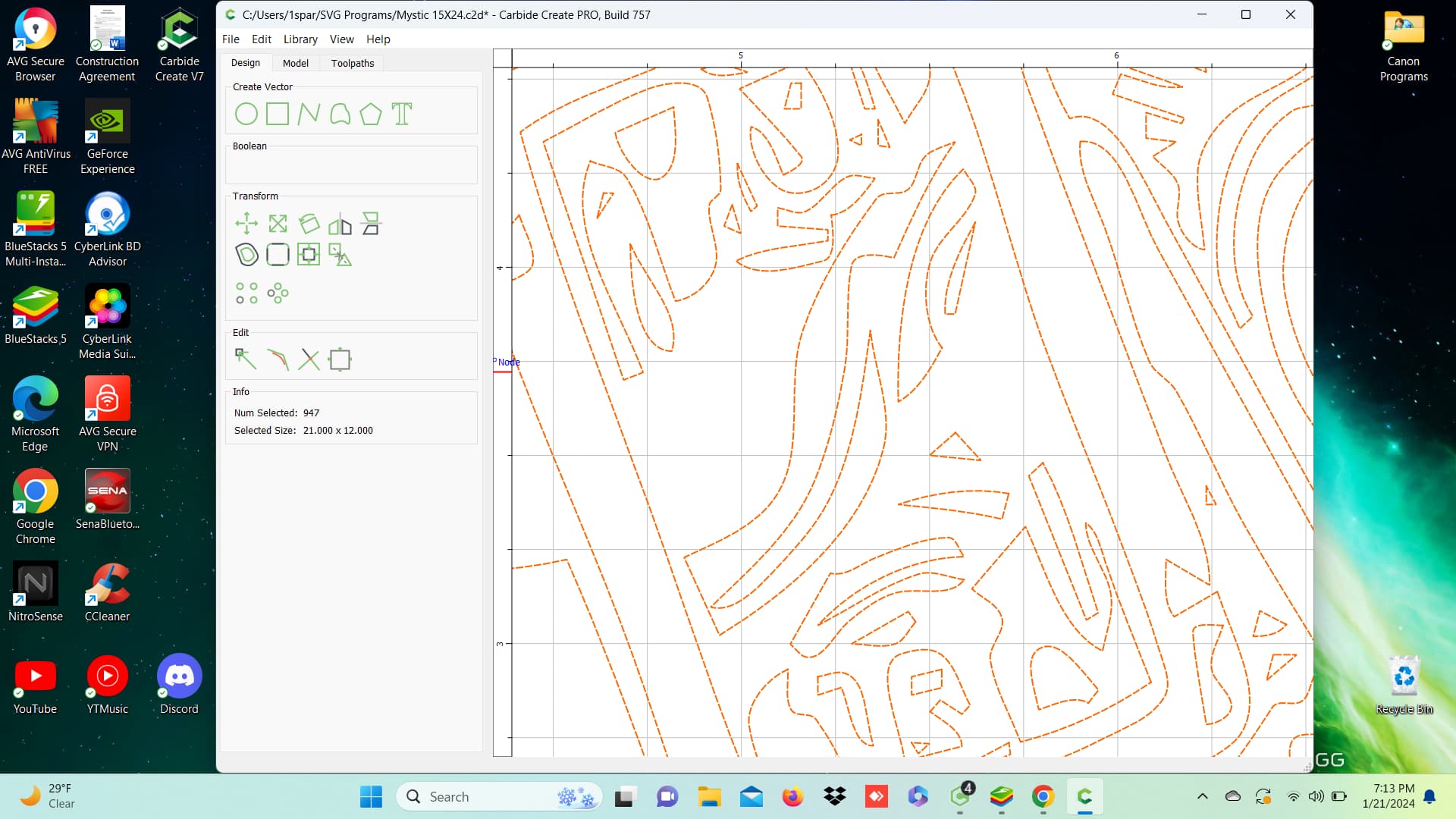

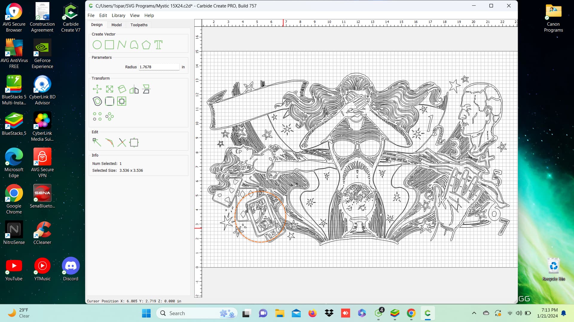

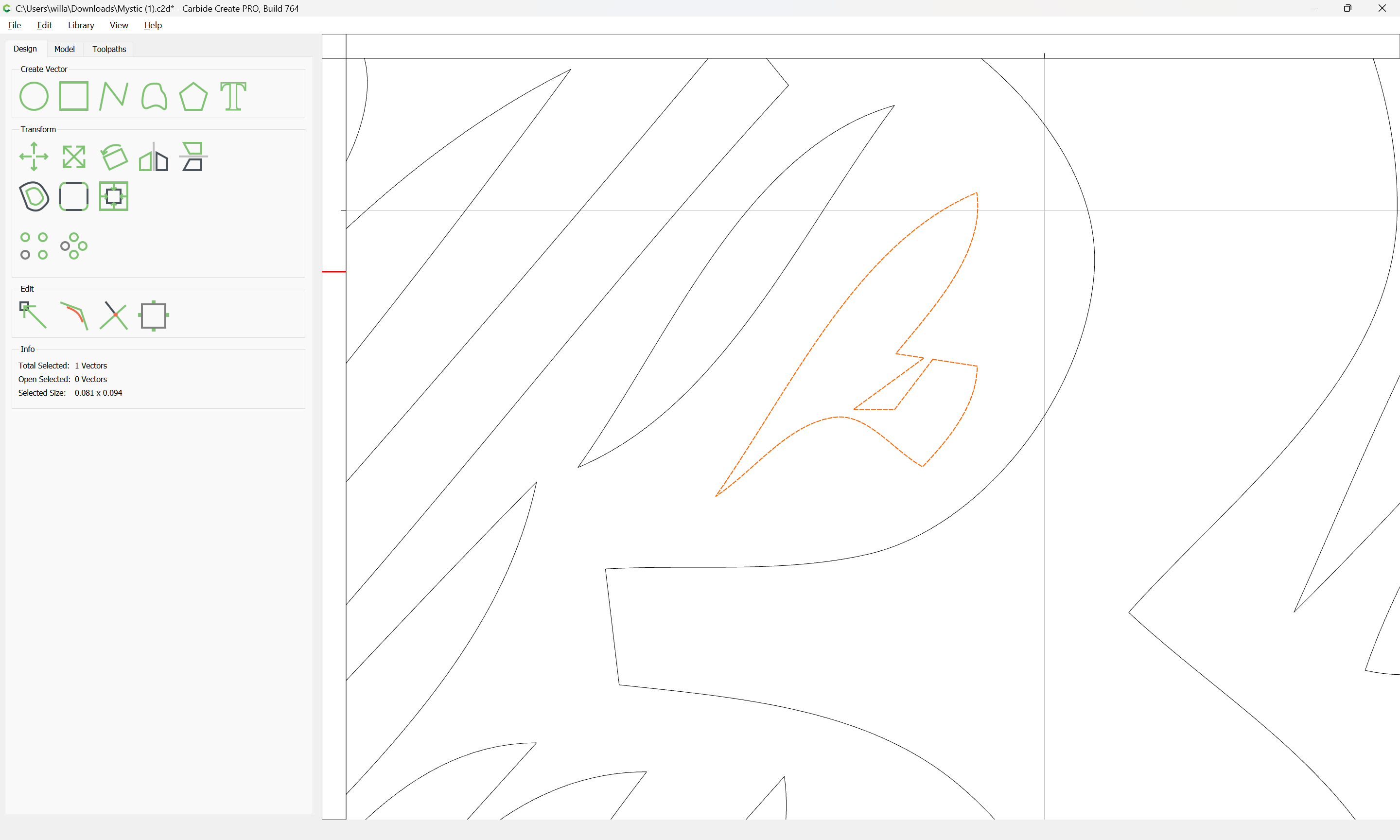

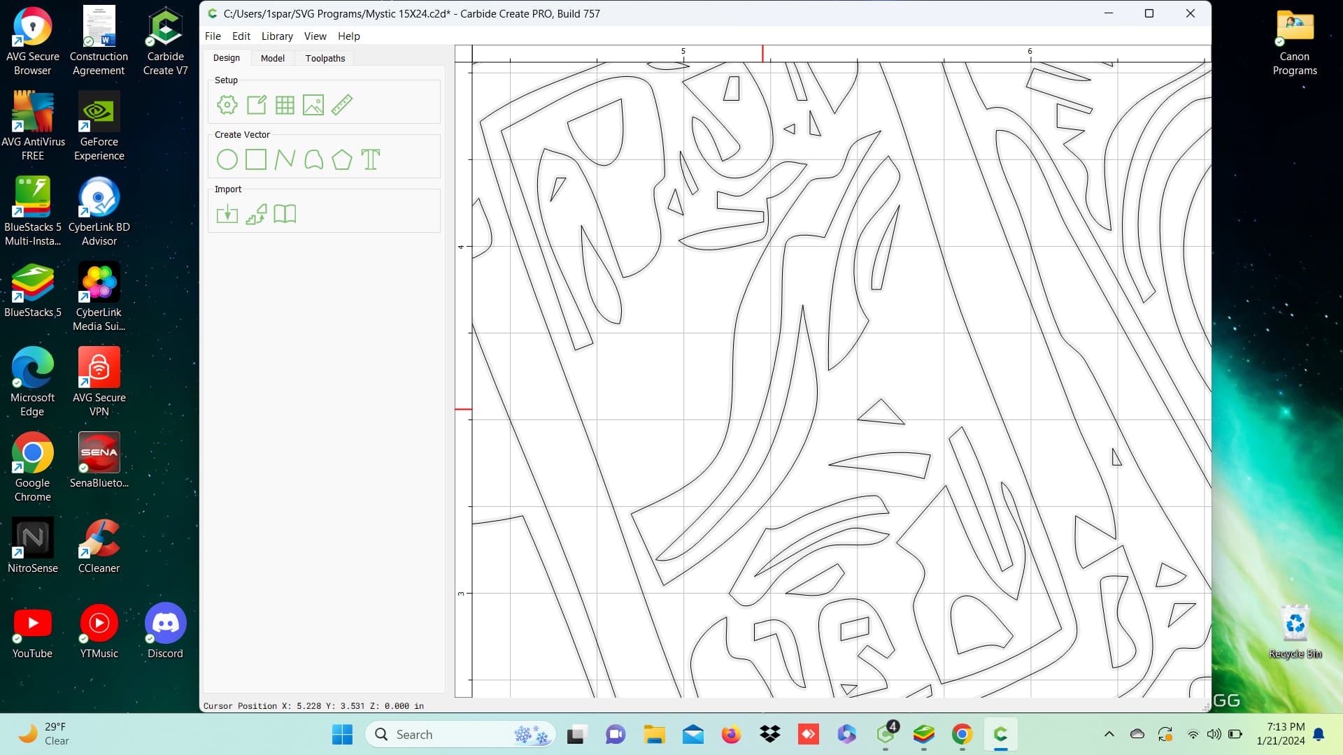

This is the new program. It is the same kind of program from earlier but in a bigger size and I have done a lot of node adjustments. I will go thru and make the screen shots to try to show what is going on.

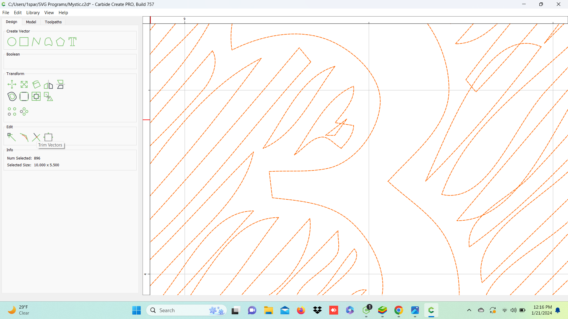

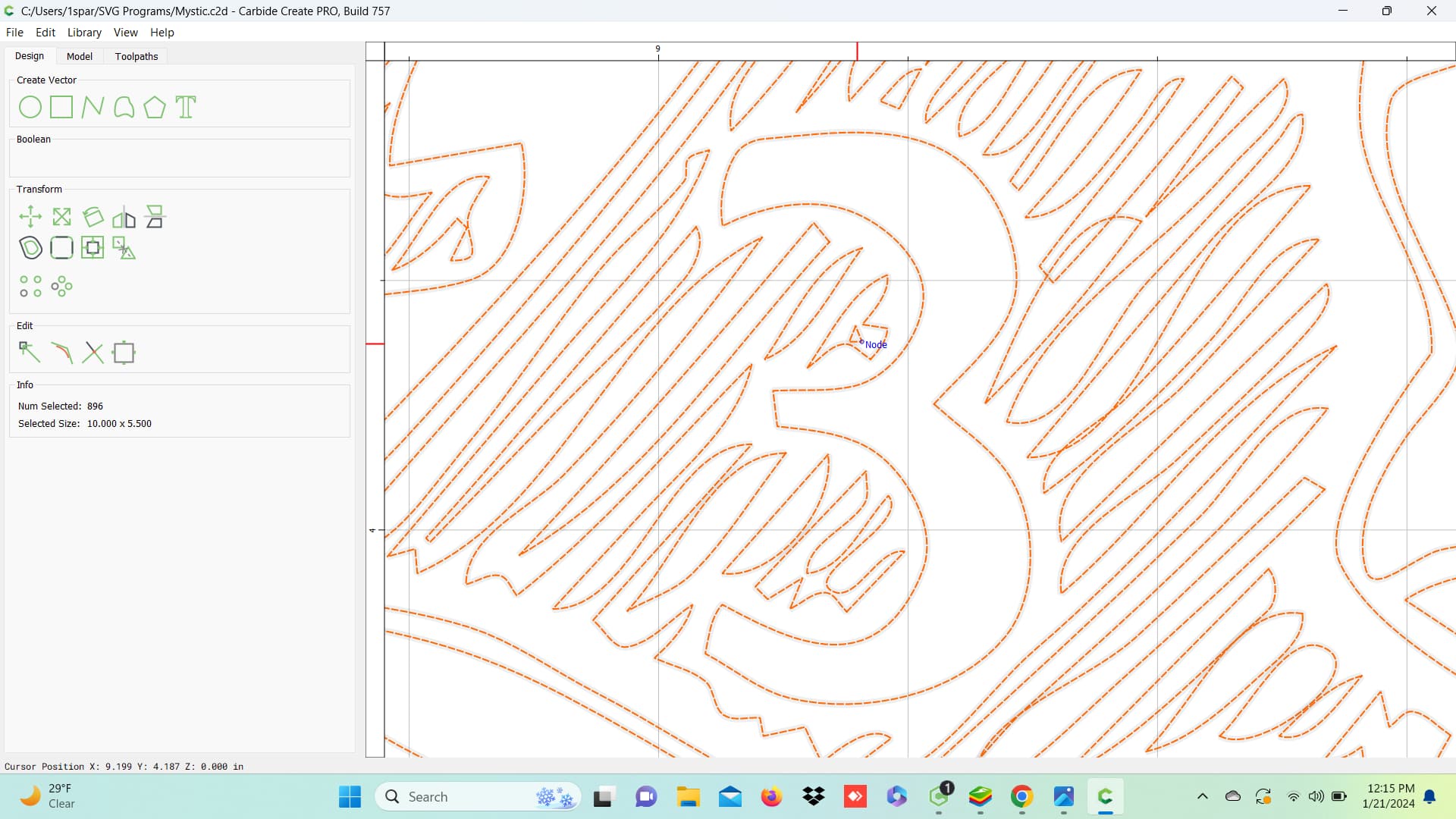

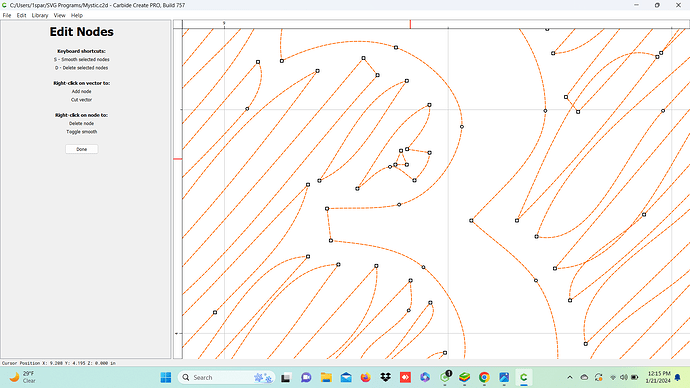

Down at the little red circle is where I am working on this.
This here is a zoomed in part of the Jack of Hearts that is needing work done on it.
Highlighting the picture.

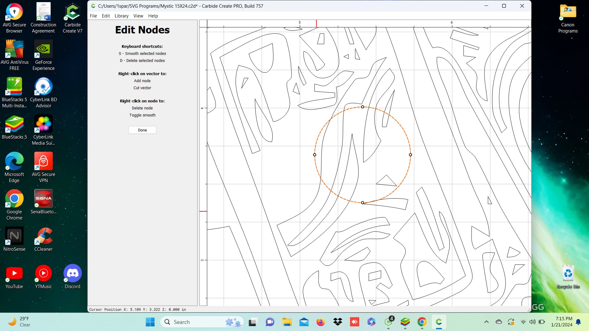

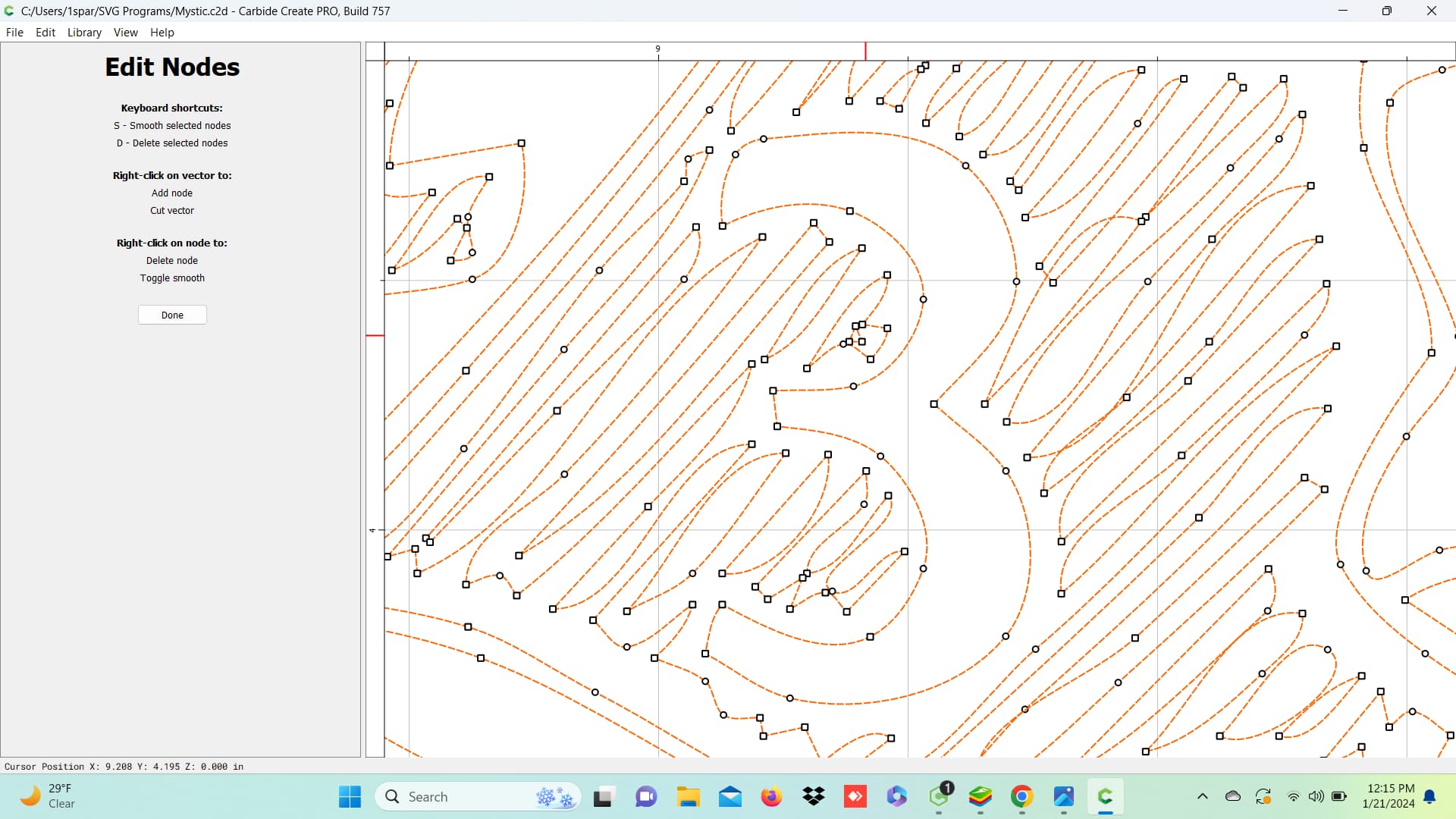

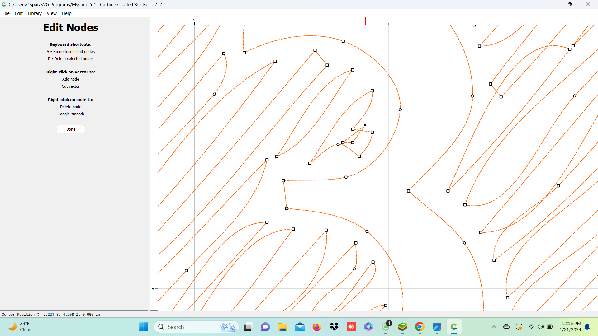

Picking edit nodes.
This red circle is where I am going to be editing the vectors.

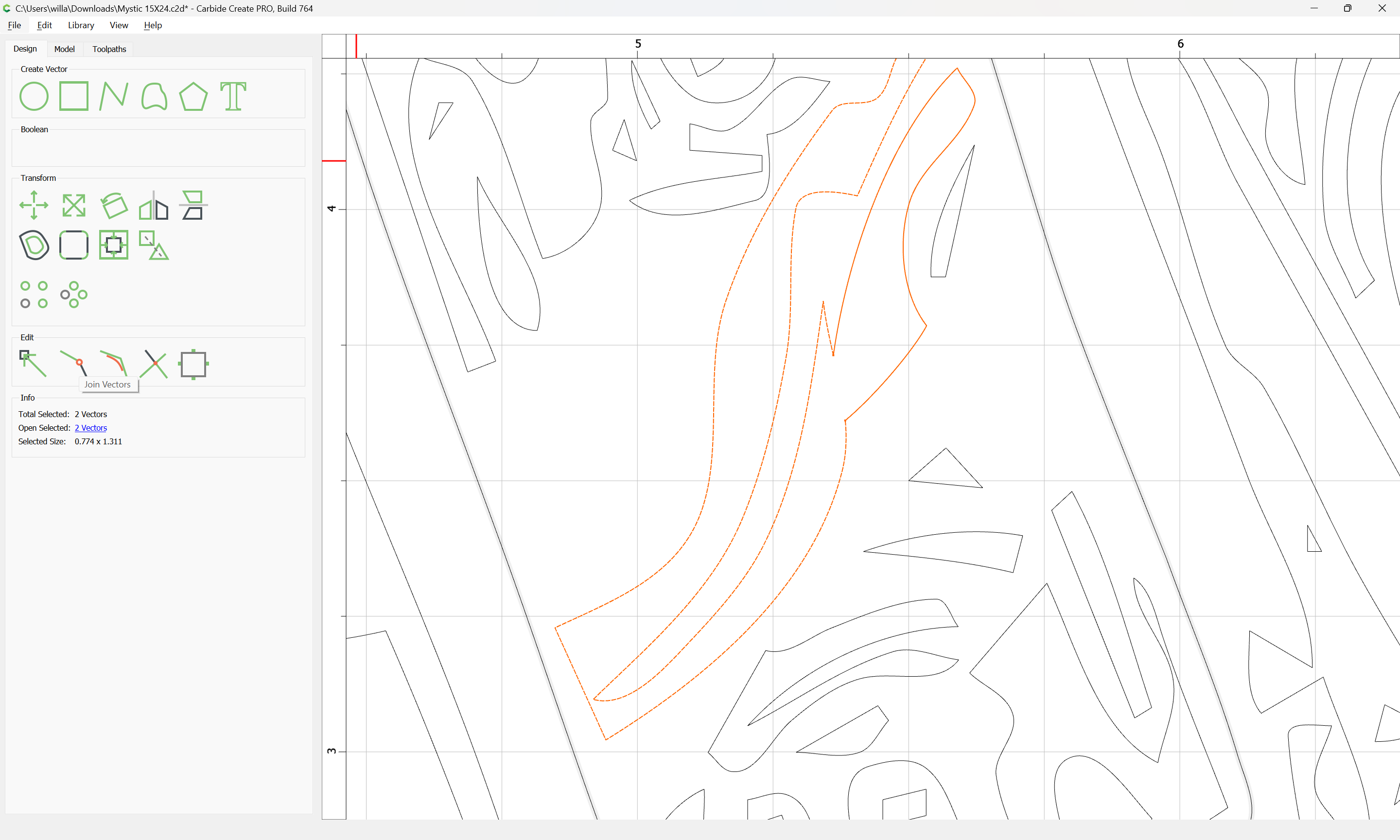

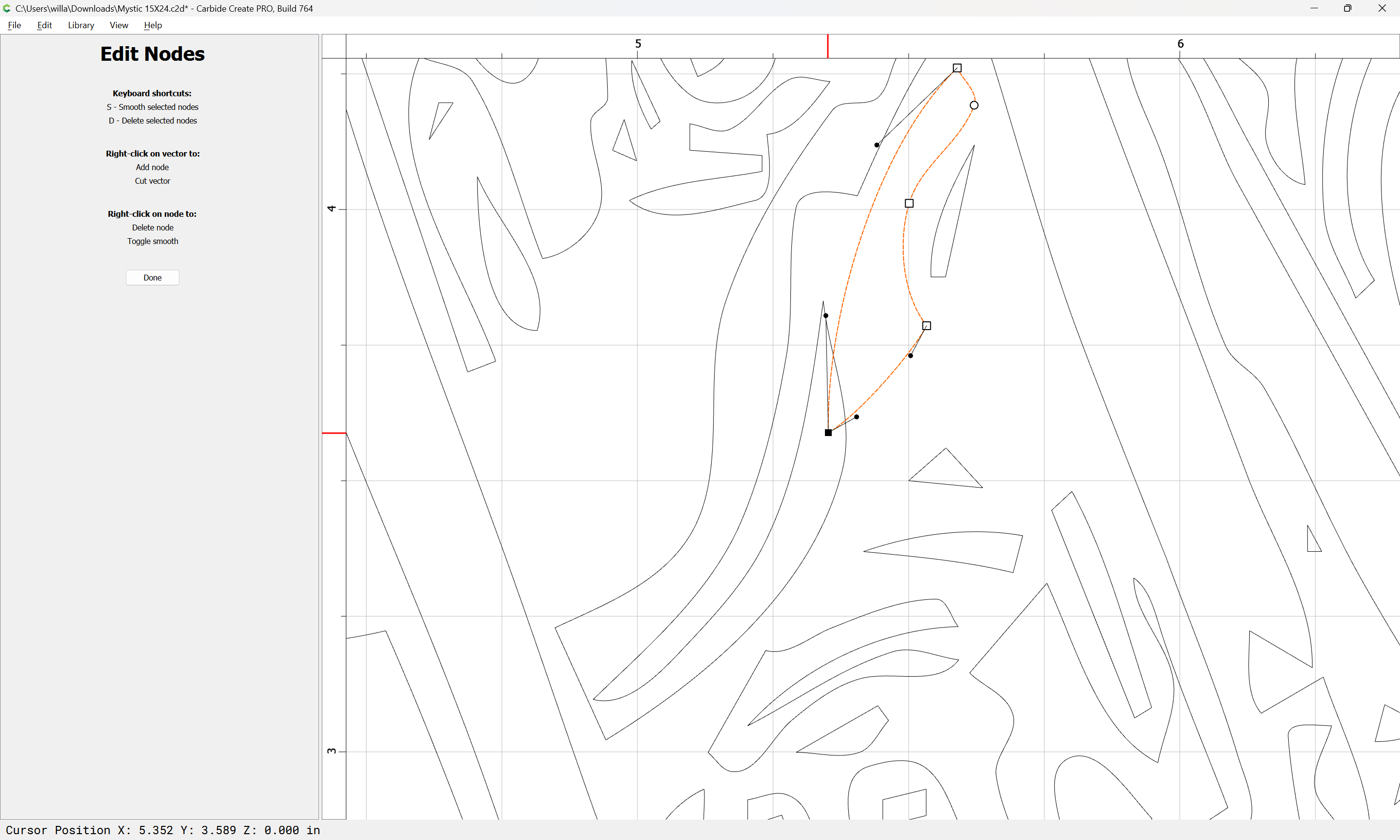

Moved the edge of the one vector across the edge of the second vector.

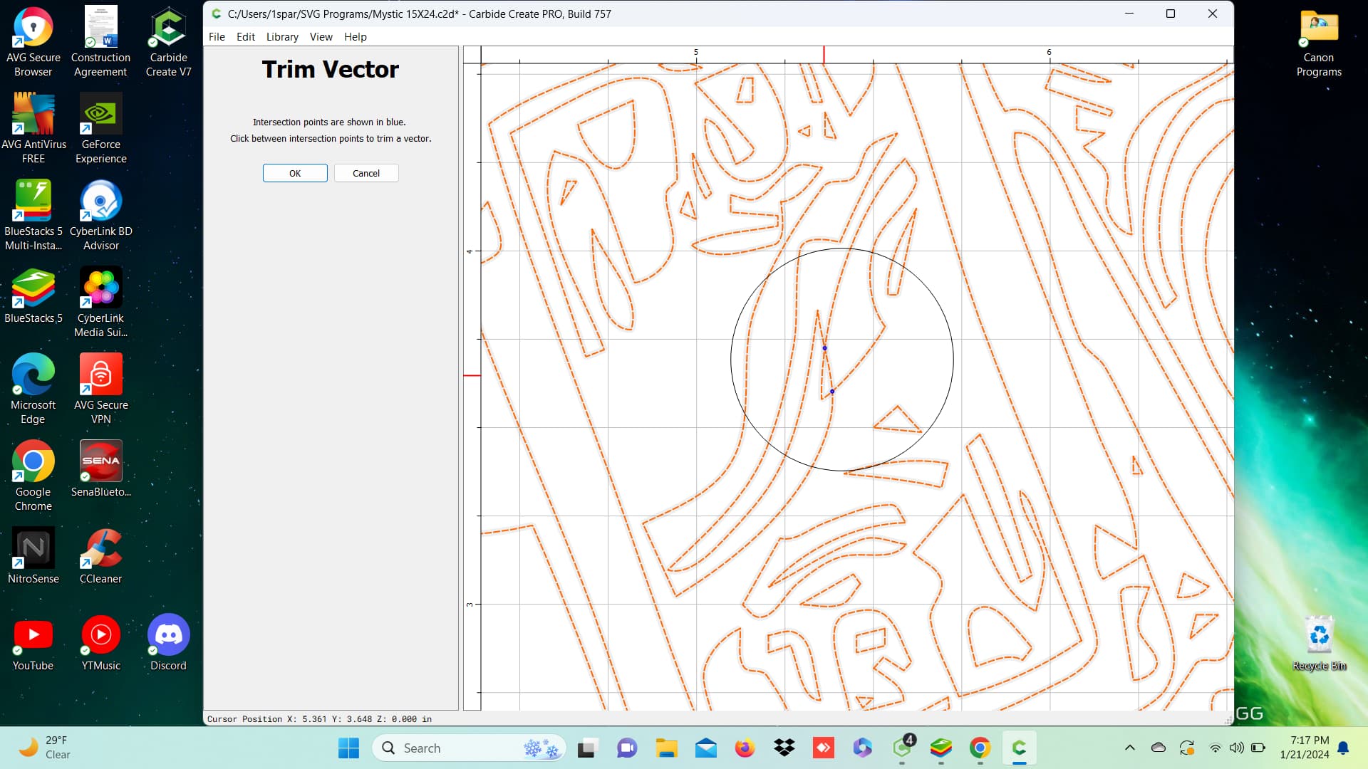

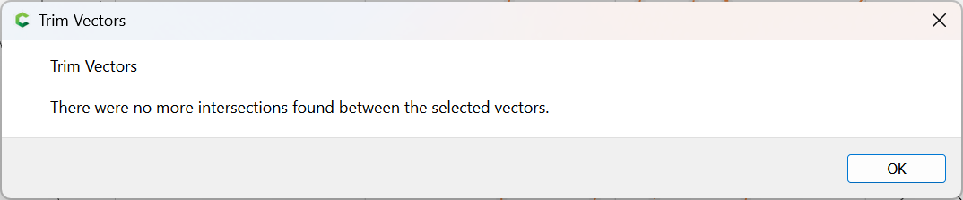

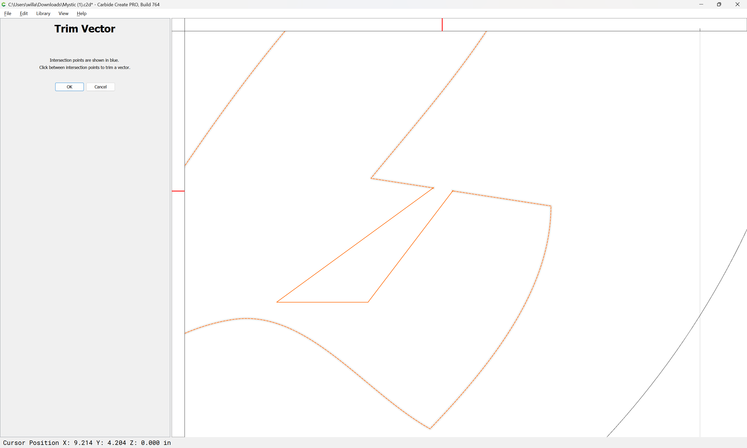

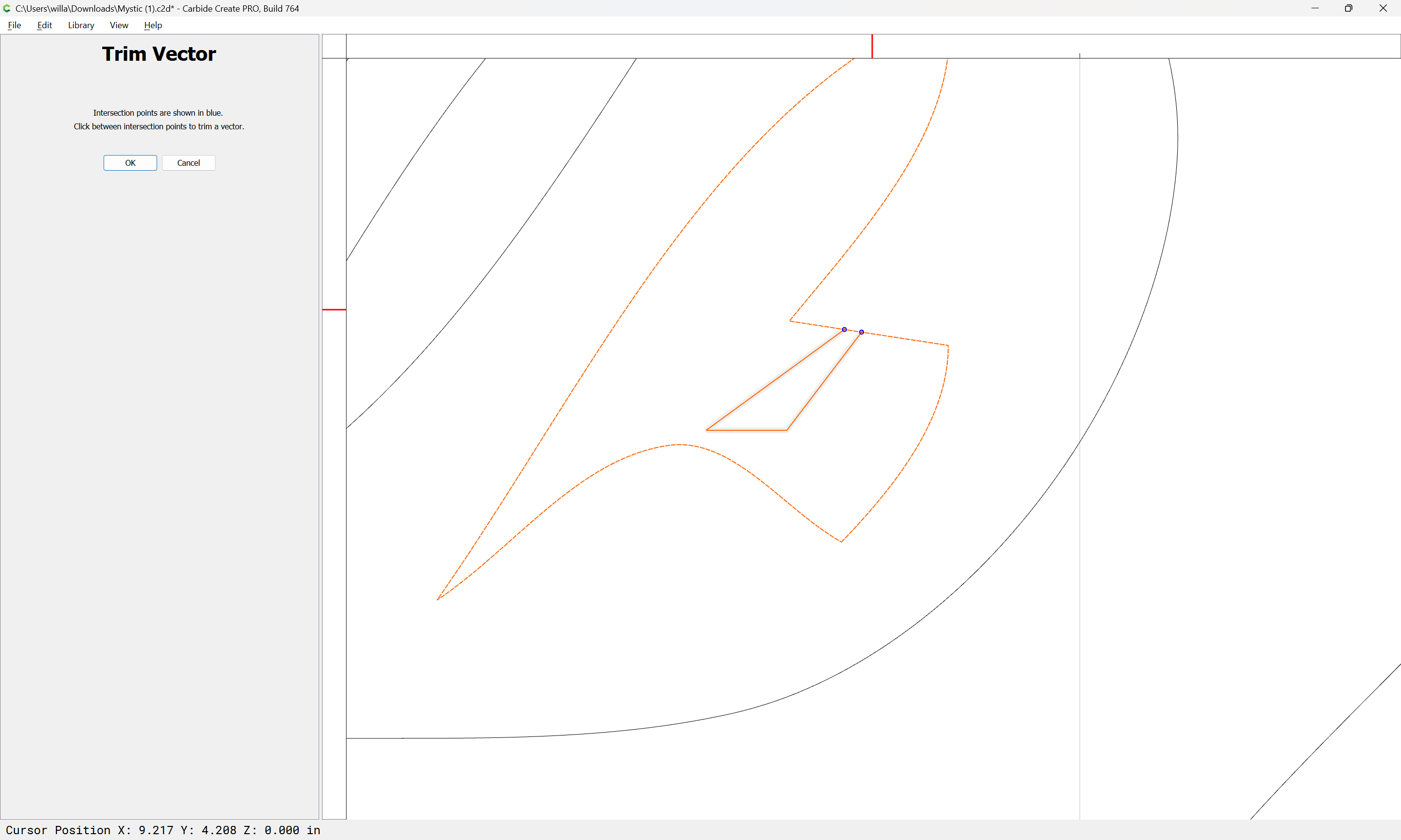

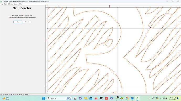

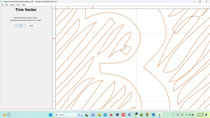

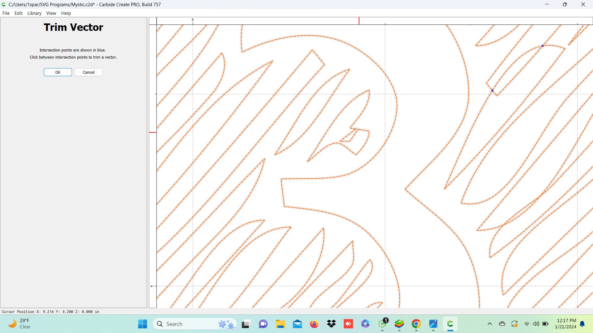

Going into trim vector.
Screenshot 2024-01-21 191647
Screenshot 2024-01-21 191735

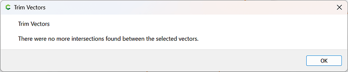

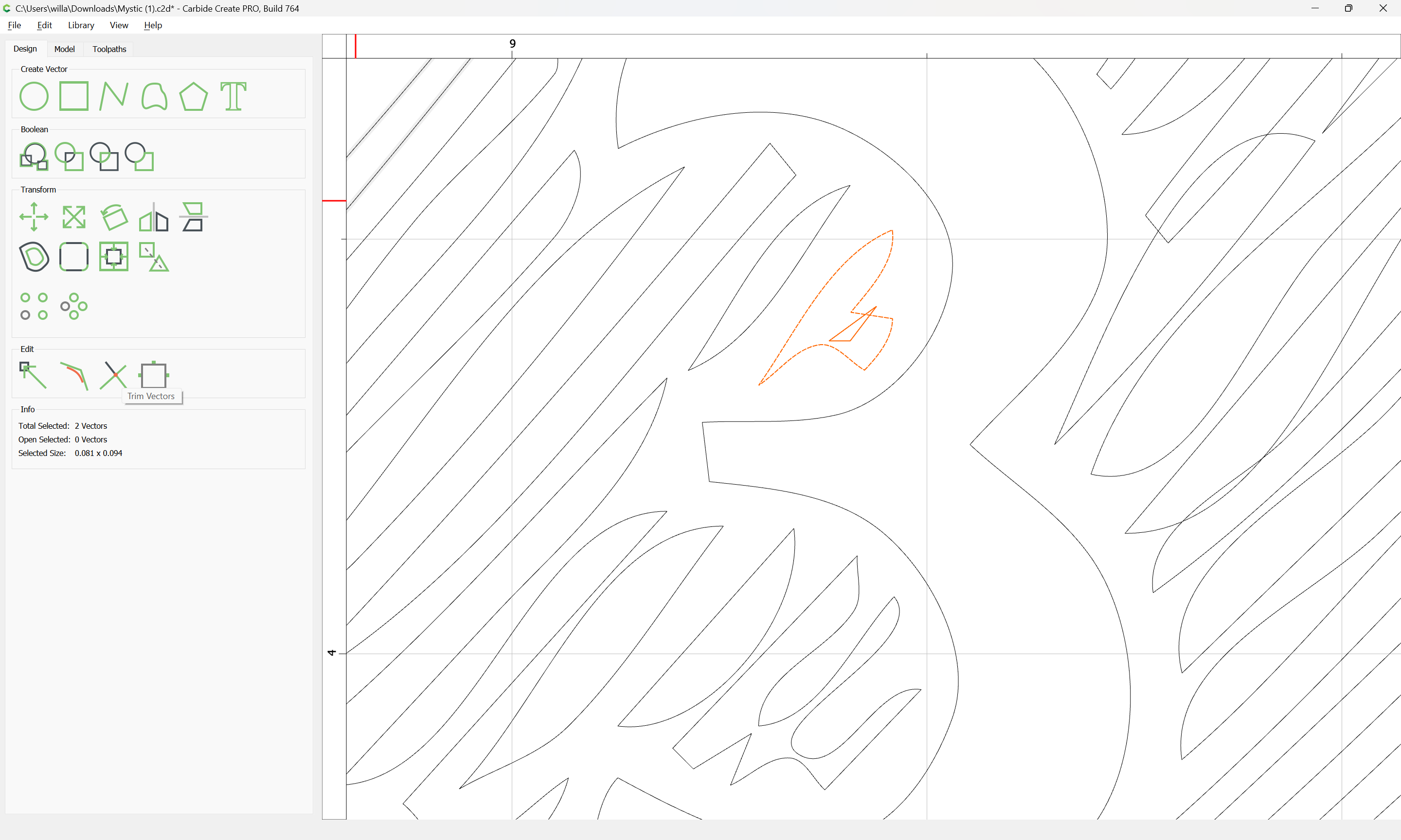

Now you can see the vector is trimmed and still needing to be joined.
Screenshot 2024-01-21 191758

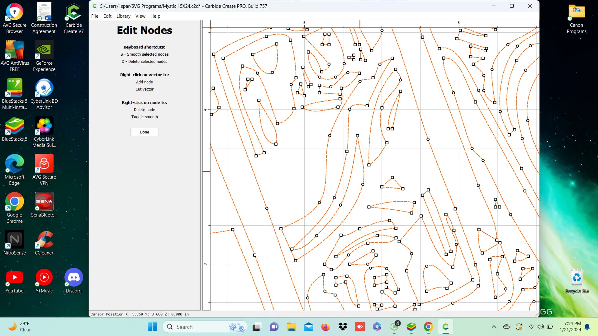

Picked join vector. Then clicked the edit nodes tab and the program crashed again. It maybe a lot of vectors that the program is dealing with and changing into another mood after joining vectors might be overpowering the program and causing it to crash as well. But this is where my problems keep crashing my program.

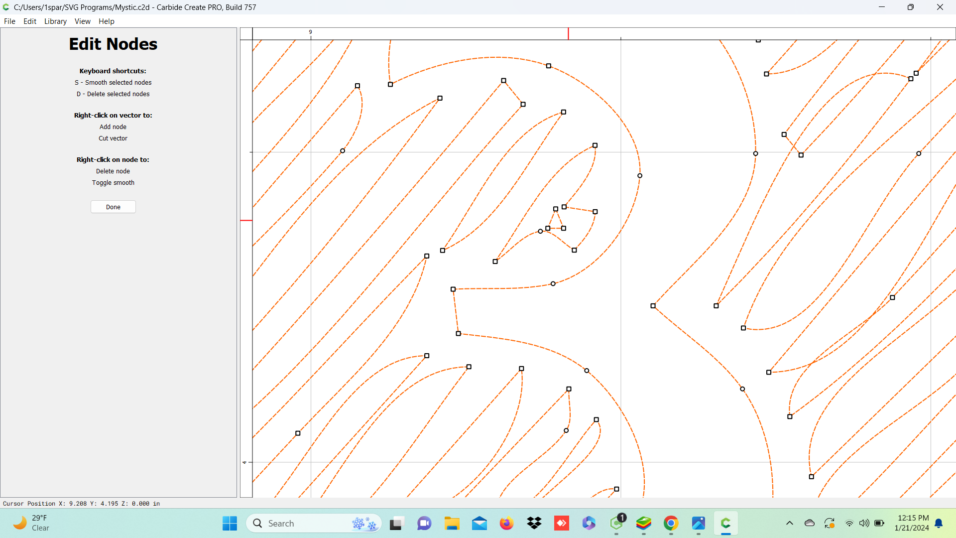

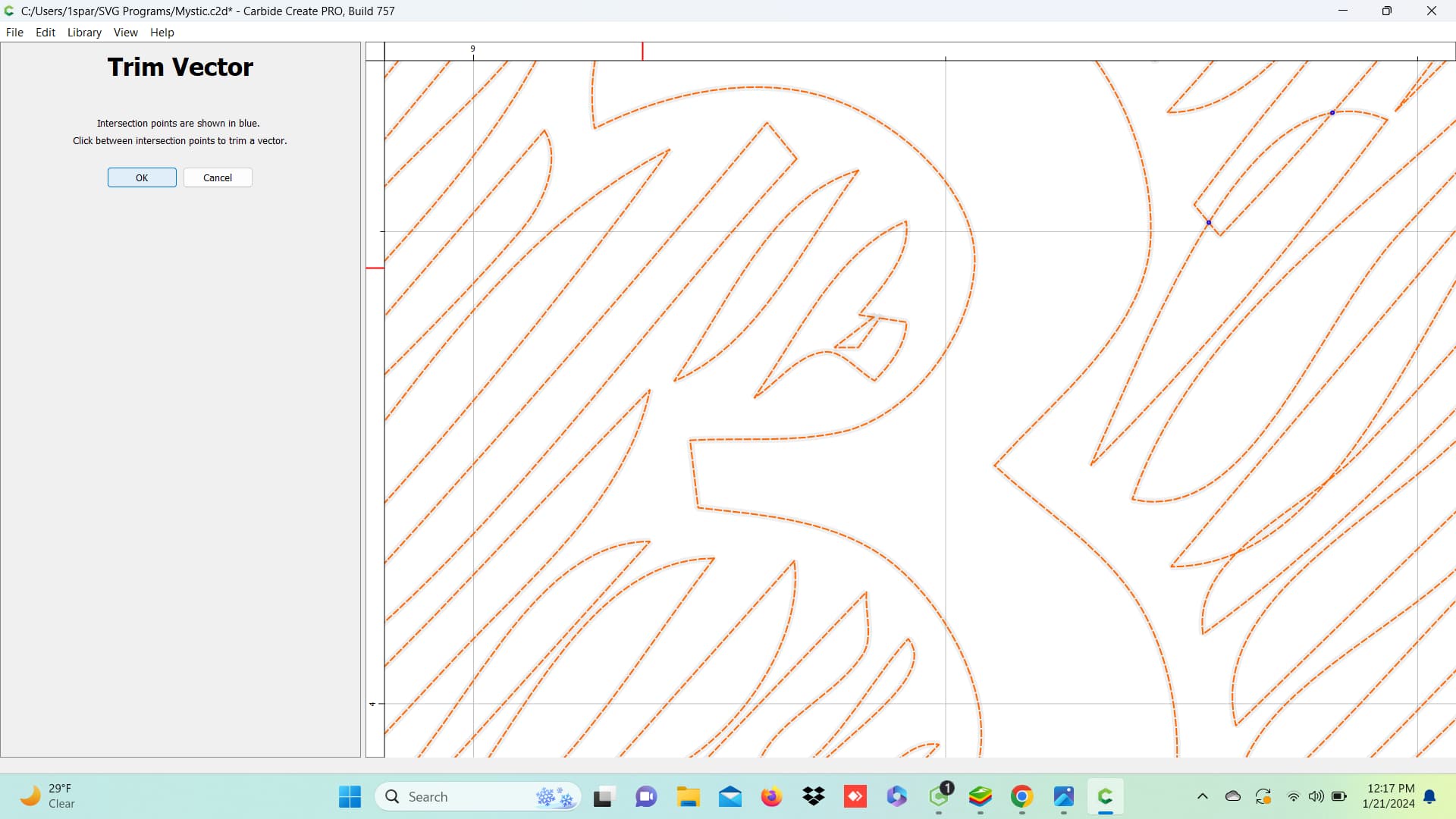

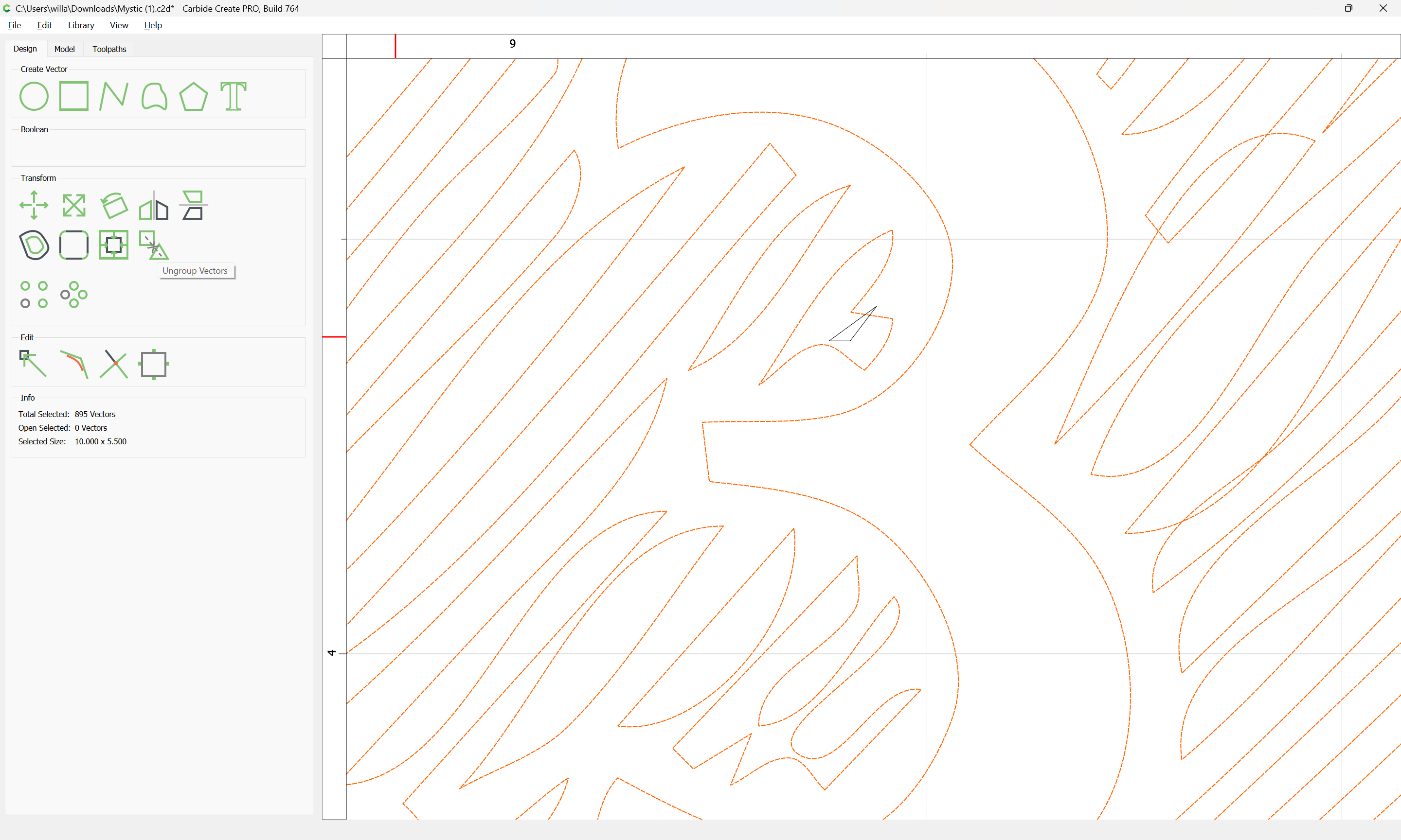

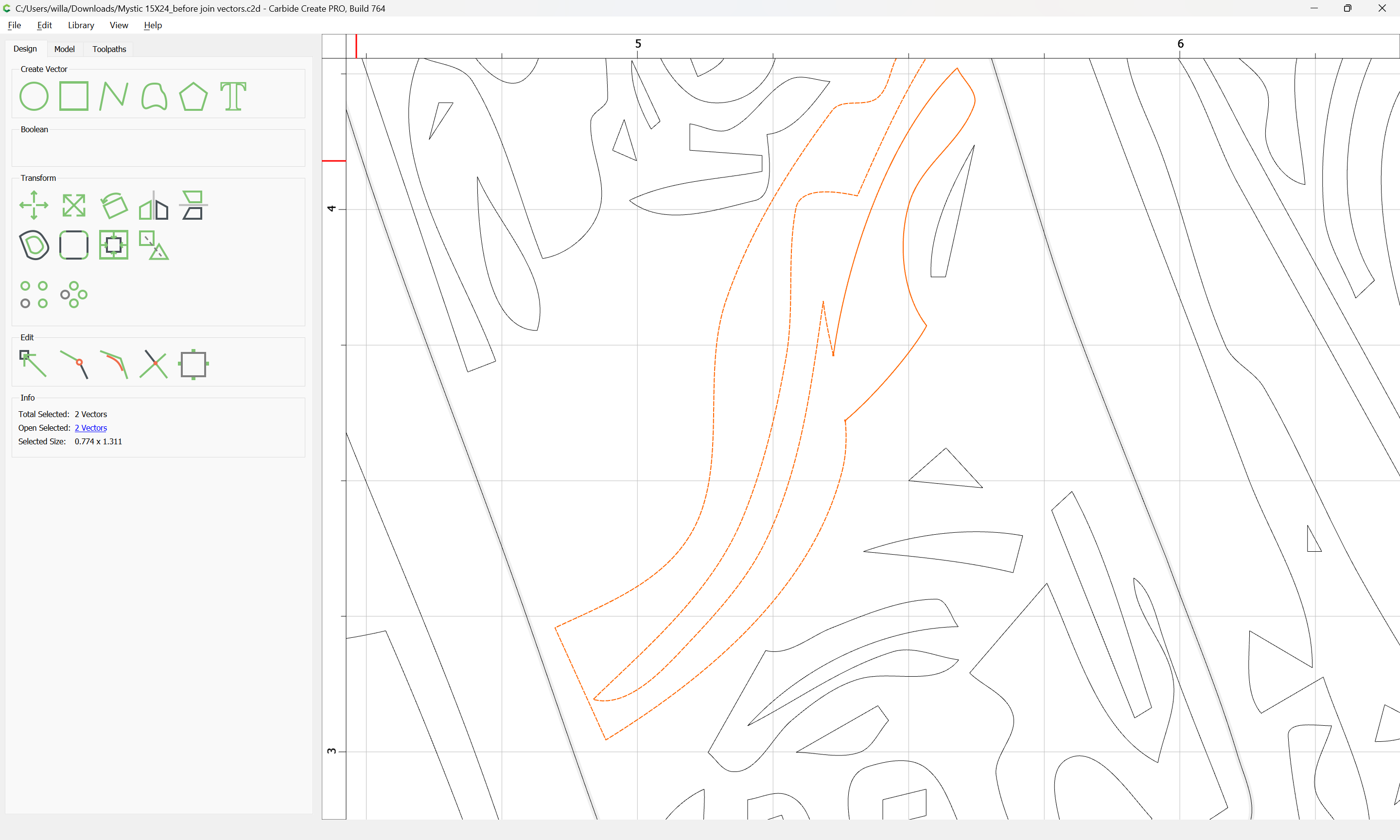

Ungrouped:
Node Edited:
Done

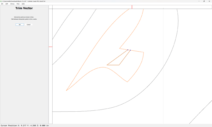

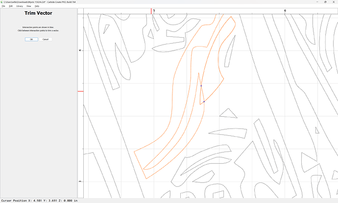

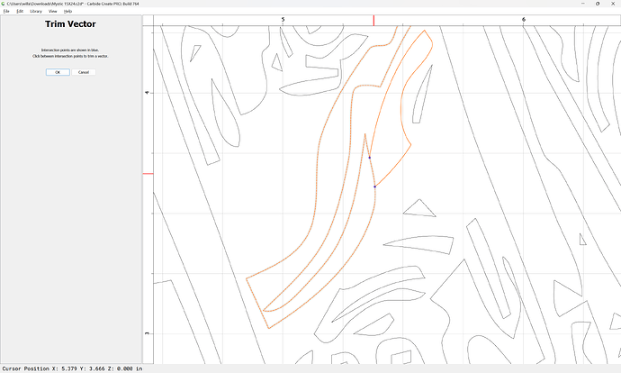

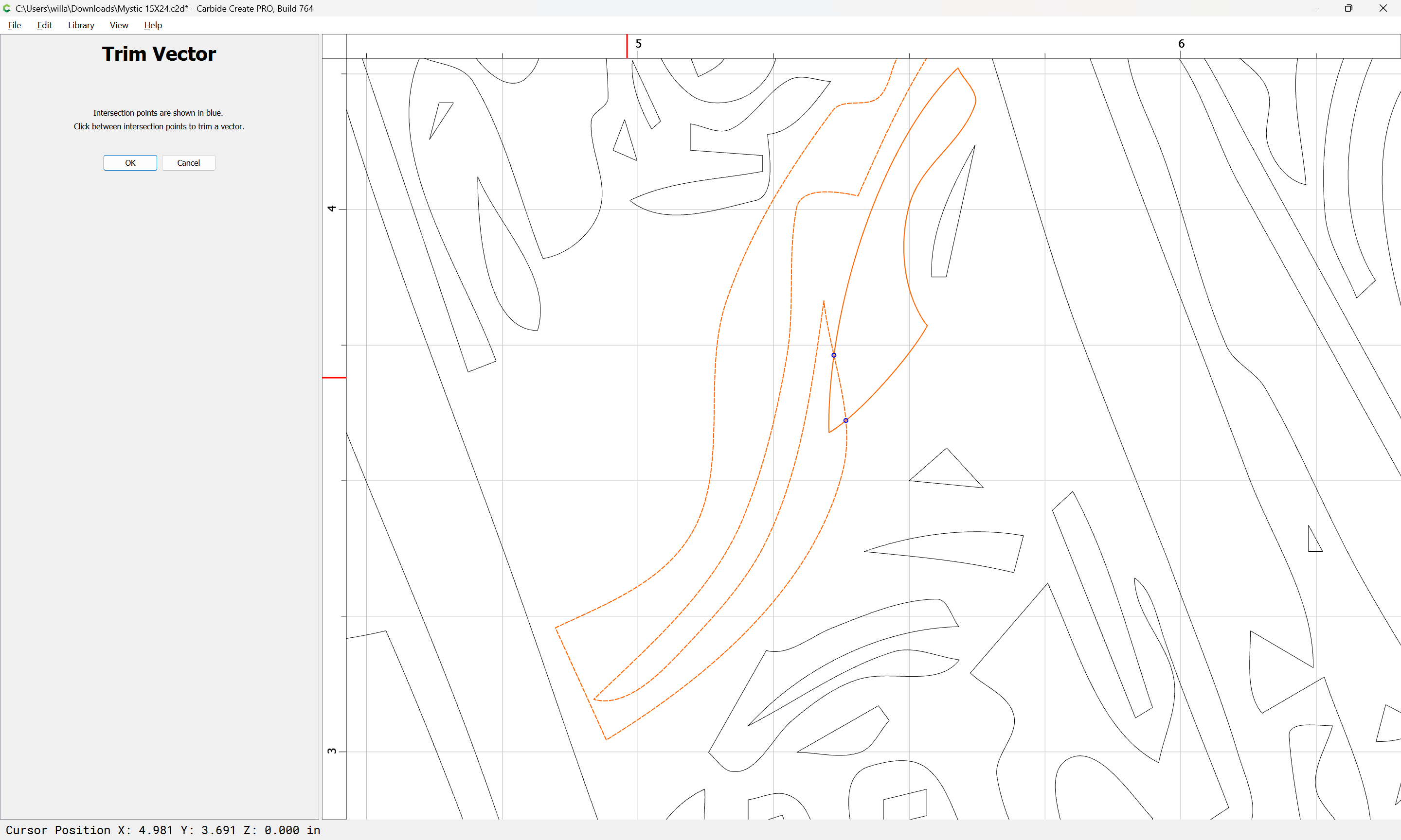

Selected the two overlapping pieces of geometry:
Trim Vectors:
OK
OK
Save the file
Thank you for this information. I ungrouped the who picture and now am able to work on smaller sections of the picture without longer delays. I think I figured out that the main issue of the crashing was the program was becoming overloaded with so many nodes being in the editing process and when I went into the vector trimming and joining, it was causing the program to have to process all of the vectors into the small change of the one joining. This would overload the program and then the program would crash. I have learned a very valuable lesson here though. SAVE OFTEN AND ALWAYS.
