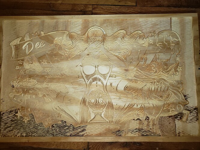

This is a first time run thru of the design carving that I made. It has a few mistakes that I have already addressed and will cut again. But, all in all I am happy with the new design.
I can see the passion that drives you will carry over just fine when you learn another way to capture the designs. You now know a lot the questions that you will re-ask yourself as you try another app.
