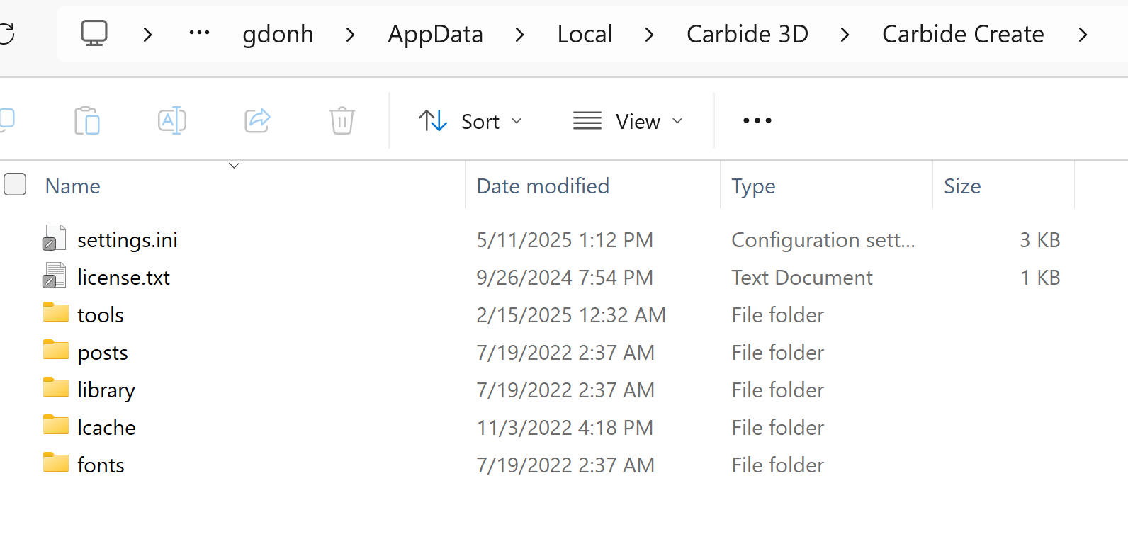

I purchased a Carbide Create Pro license and installed it in my Carbide Create Pro 8 running in wine. The registration works and it tells me to restart CC. The problem is that upon restart, no license is installed and I get the same free version. I can go back to register, paste the license key and not restart CC in order to use the Pro features but that is very annoying.

Can you manually paste a file named license.txt containing all the license info in the Carbide Create folder on your hard drive?
As @Ed.E stated the license is read when CC starts. It is installed at:
Open CC. Go to the Help Menu and About. Click on the Open Data directory. Then open the CC directory. Here is a picture of my directory.
My Pro License is the “license.txt” file. The reason after installing the Pro License to restart CC is because the license file is read at startup of CC. So try as @Ed.E suggested and put your license file in place and restart CC to see if the license comes up.
Hi guys and thank you for your replies. @gdon_2003 the path you shown did the trick. Thanks again for all your help!
