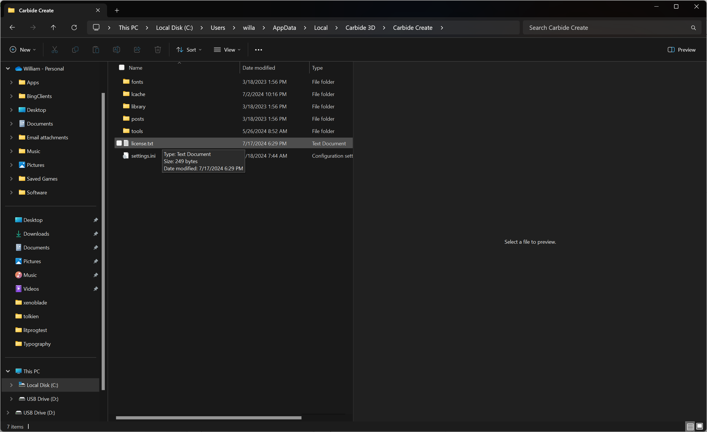

Carbide Create Pro is a licensing mode for Carbide Create, not a separate program.
To remove the license you will need to go to Help | About and click on “Open Data Directory” which will reveal a folder which has a "license.txt file:
Delete that file, then quit and re-start Carbide Create.

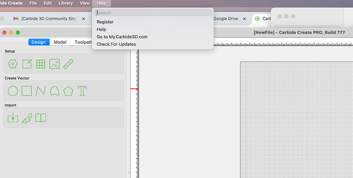

Hi Will,
Thanks for the reply.

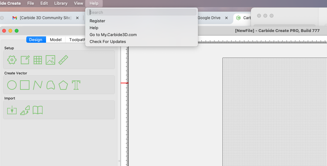

I’m on a Mac and don’t see the ‘About’ option in Help.
Thanks,
Gunter
WillAdams
(William Adams (Carbide 3D))
July 18, 2024, 2:25pm
4
On a Mac it’s Carbide Create (app menu) | About
Great, that worked, thank you Will.
Gunter
