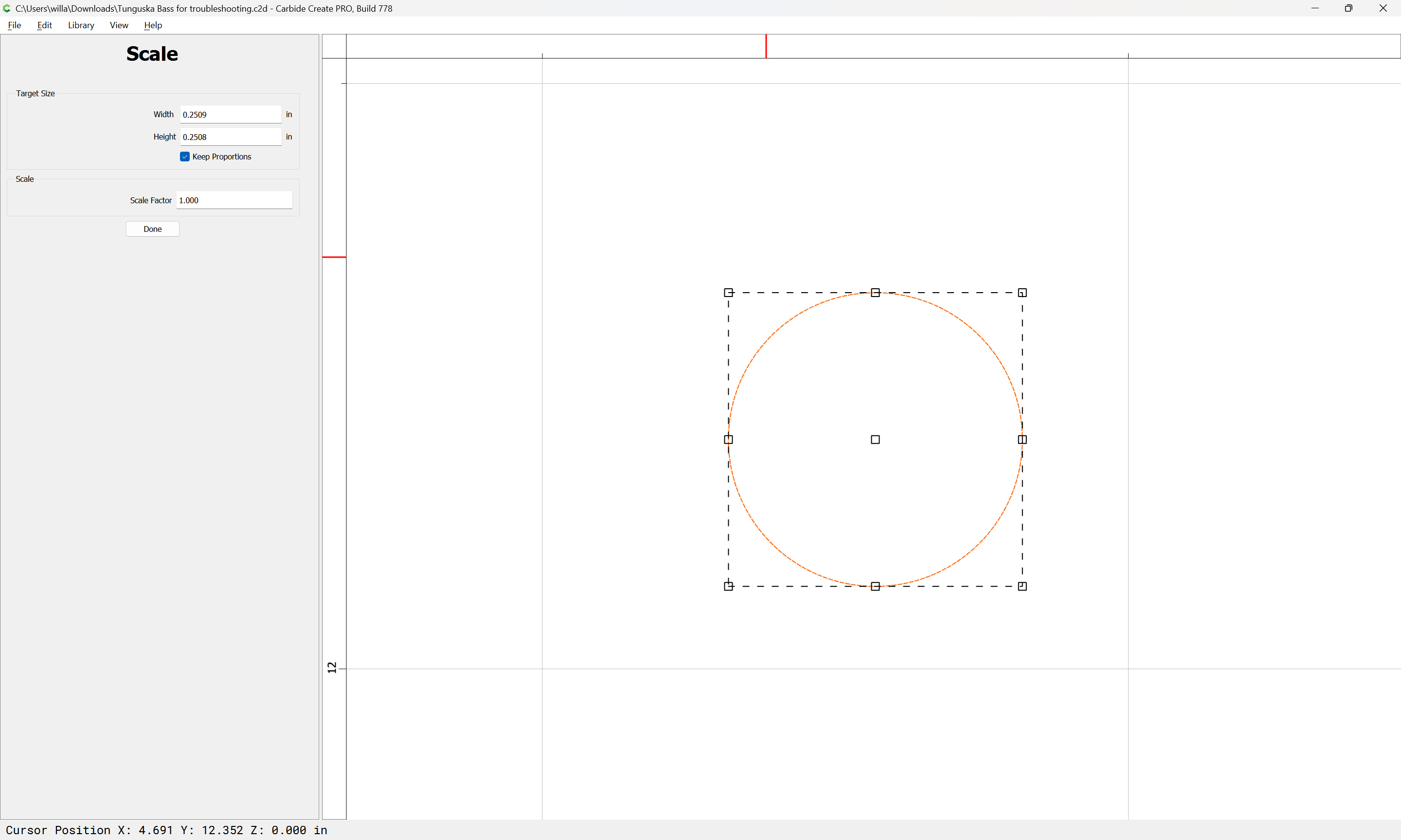

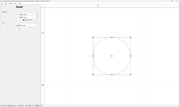

I have a set of indexing holes that align with a specialized wasteboard I made specifically for my guitar shenanigans. What I’m finding though, is my round indexing holes are not coming into Create perfectly (and therefore, I can assume, neither is anything else). For example, an indexing hole in Illustrator set to 0.2508" x 0.2508" will come into Create as 0.2508" x 0.2505", or something like that. I know that we’re talking a few 10,000ths up to a couple 1000ths of an inch, and most likely it will never be a real issue, but I’d still like to understand what might be happening here. Would love for this to be a perfectly 1:1 process from design through implementation. Anyone else run into this and/or have a fix?

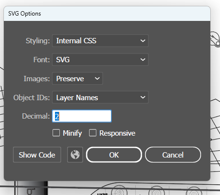

Export as an SVG and be sure to uncheck the “Responsive” checkbox.
I just double-checked, it’s already unchecked. Hmmm.
Here’s the export options I’ve been using:

They seem to be quite close to that dimension:

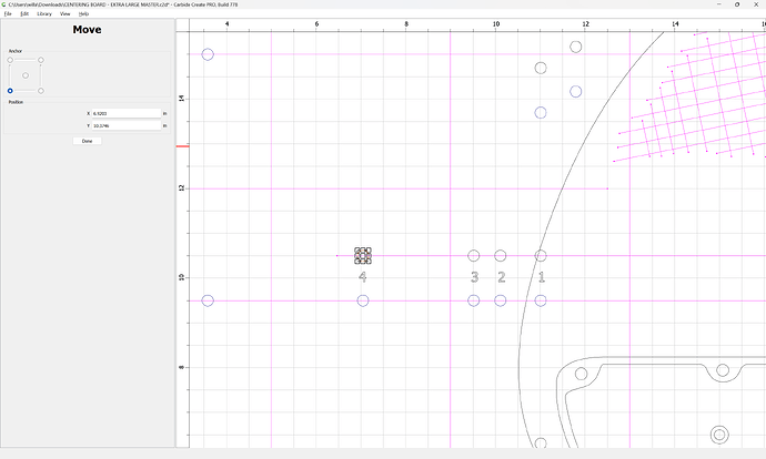

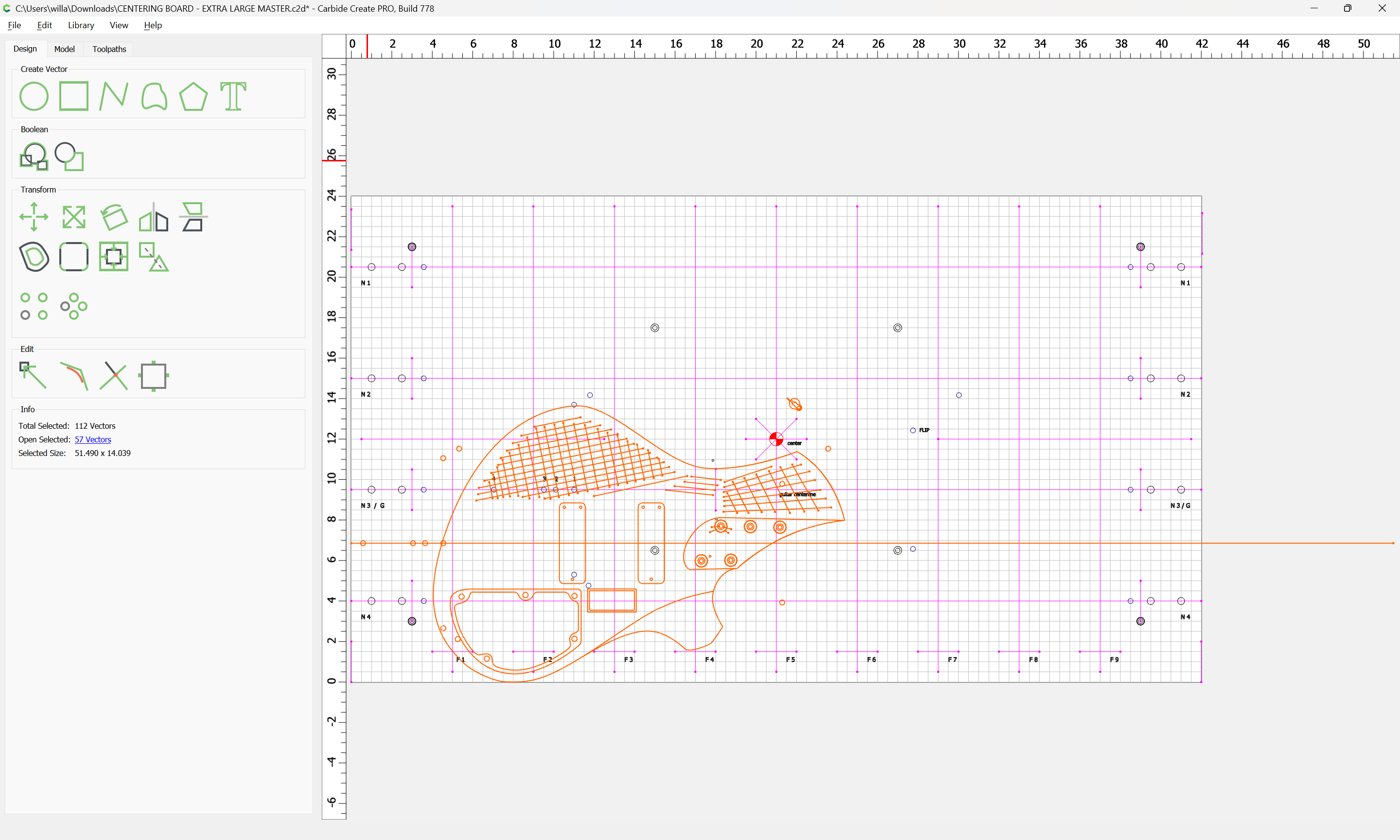

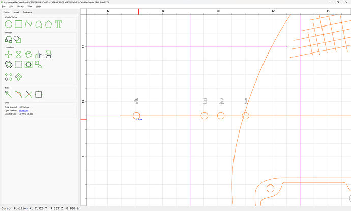

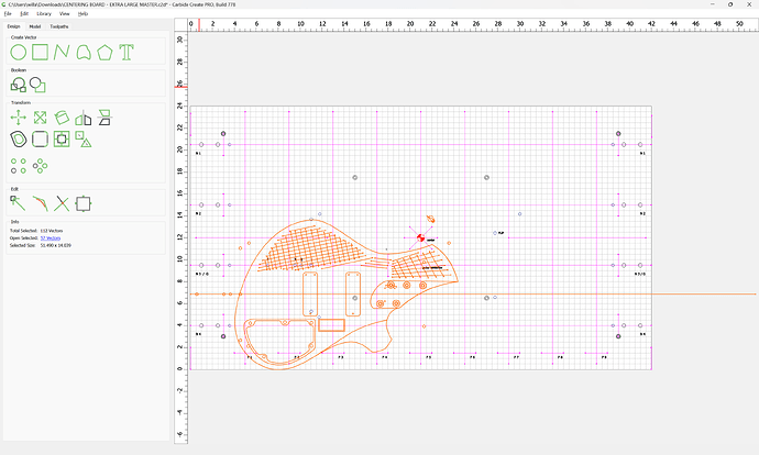

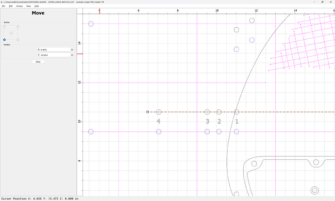

They are, but let me elaborate a little more - I’m attaching the centering board I’ve created that’ll allow me to knock out four necks or nine fretboards in one go, but also allow me to use those indexing holes to precisely align a body and cut pickup cavs/neck pockets, etc, then flip it over and do the control cavities. I know the array of holes seems a little weird, but that’s because before I got the CNC, I used a series of acrylic templates I cut on a laser table and that pattern of holes was ideal for that purpose. I decided to keep the extras in the new design in case I need to revisit something with those old acrylics. Anyways, if you open up the body SVG or Carbide Create file, copy all, then open this baseboard and paste the holes onto a new layer, if you perfectly line up (for example) the farthest left hole on the centerline to hole #4 on the board, then go and look at the lower left hole near the guitar’s lower horn, you’ll see things don’t perfectly line up - it’s off by a tiny bit.
Again, I really don’t think this small amount is ever going to present a problem, but I’d love to know why it’s happening.
CENTERING BOARD - EXTRA LARGE MASTER.c2d (544 KB)
Okay, we get the file:

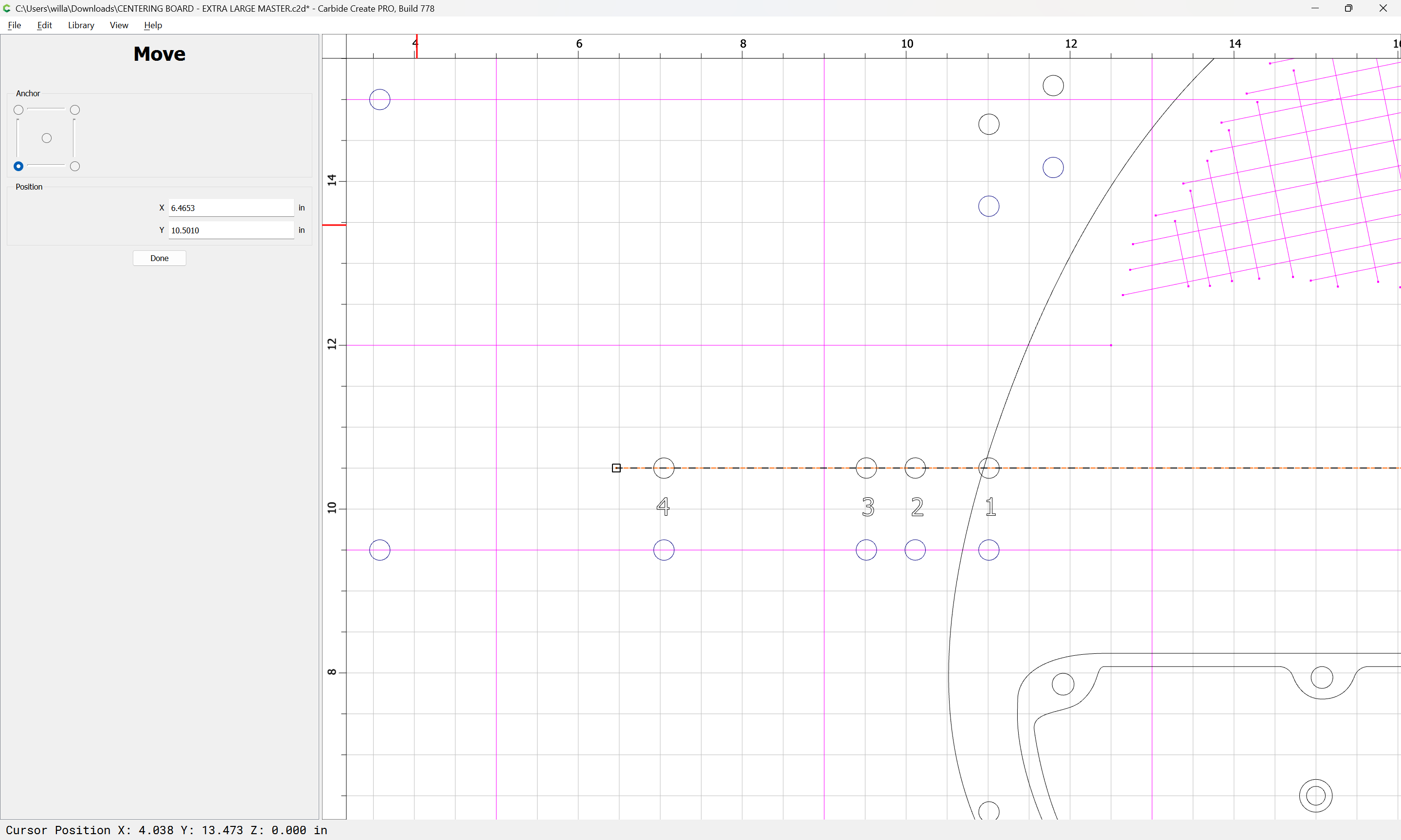

which we line up:

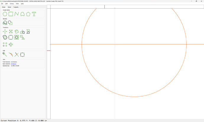

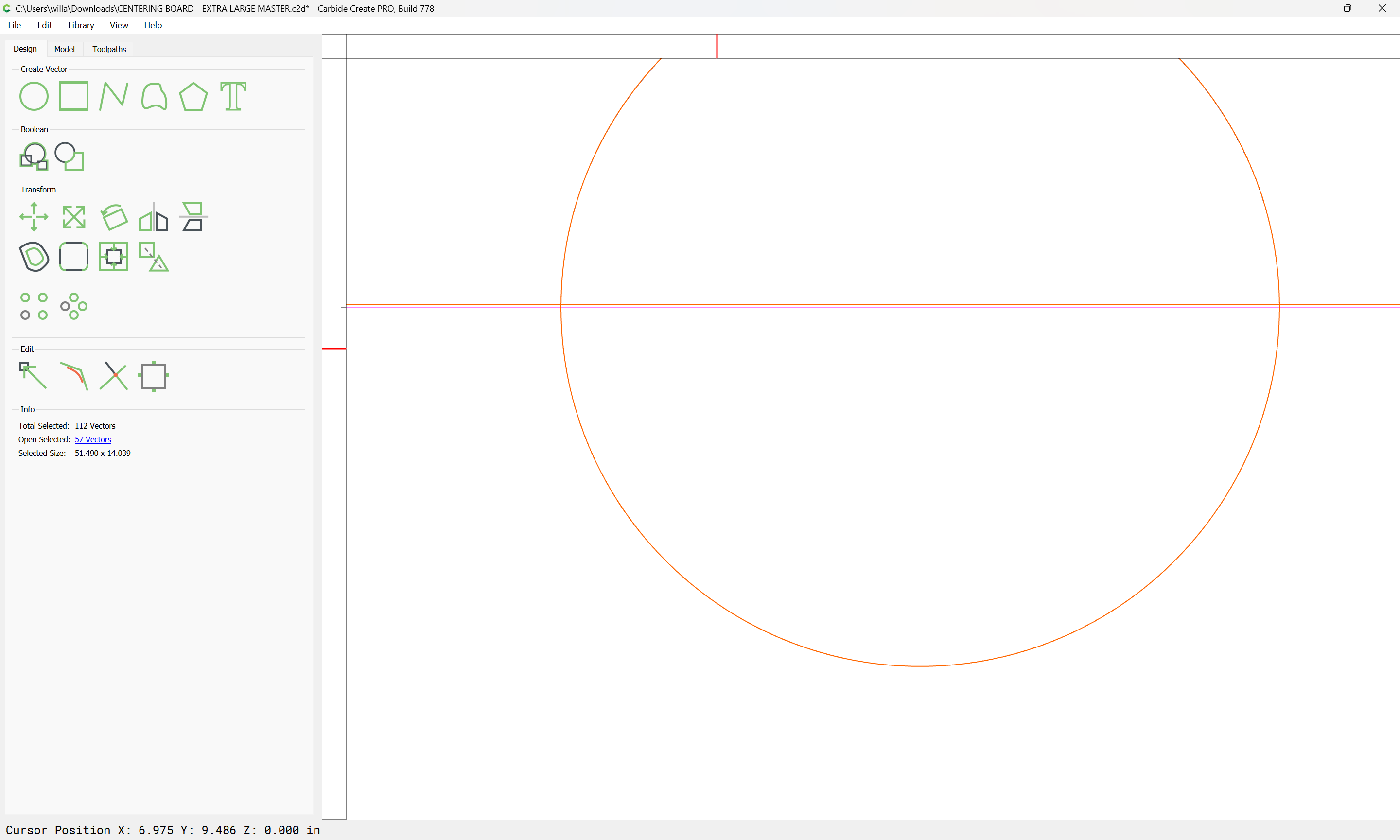

and when we zoom in, the centerline isn’t right:

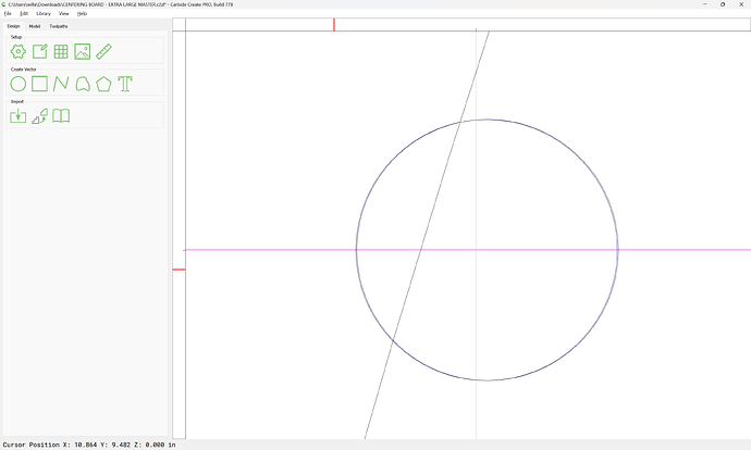

and at hole #1 we get more of a disconnect:

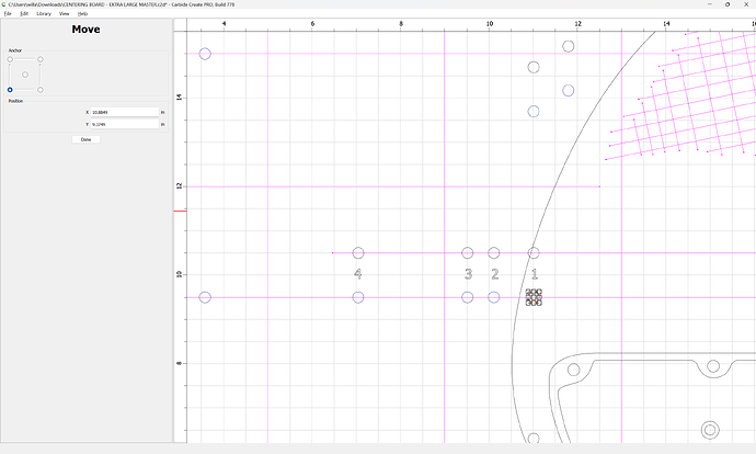

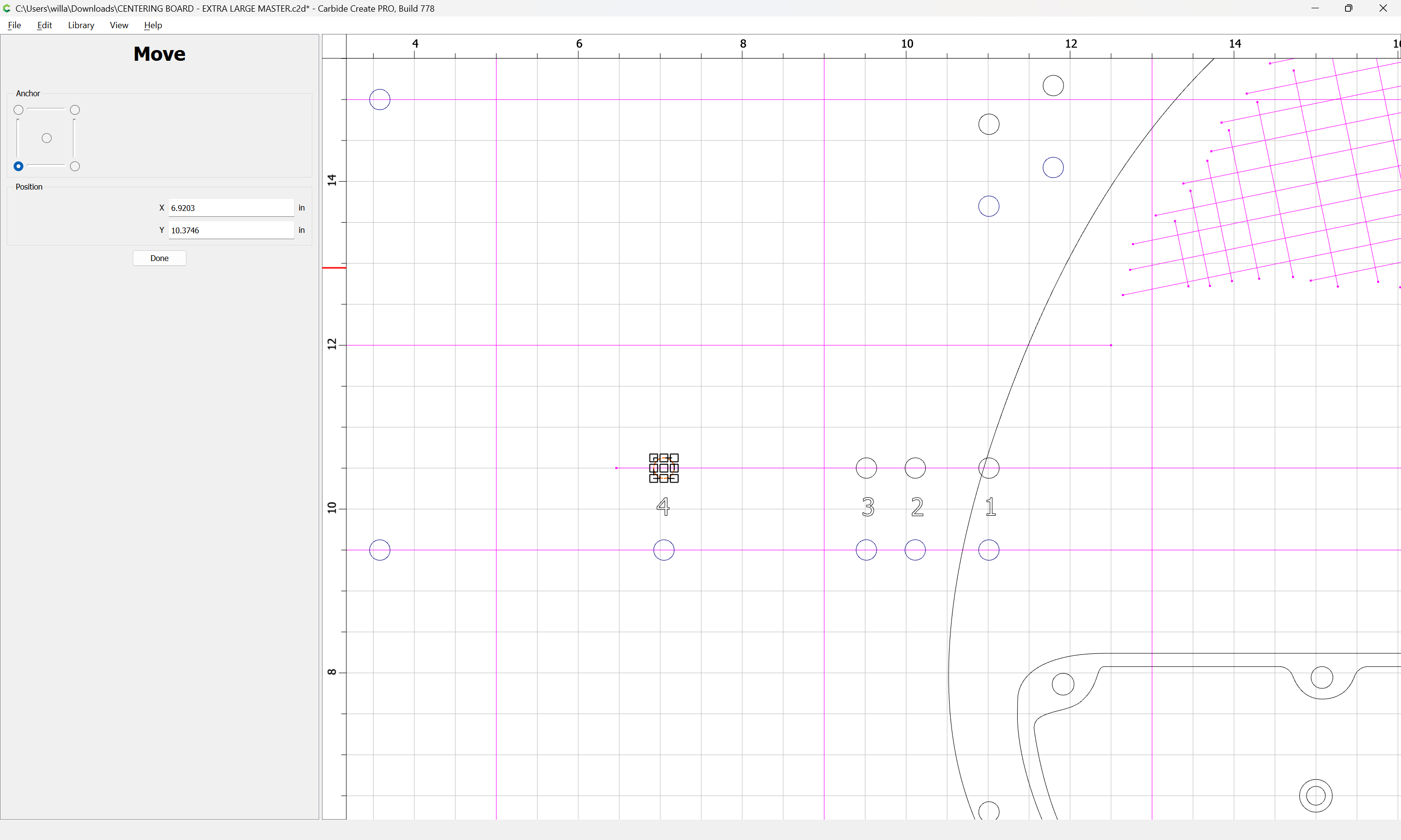

Have you verified the hole positioning/distance/dimension in Adobe Illustrator?

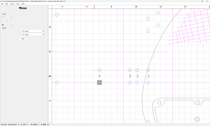

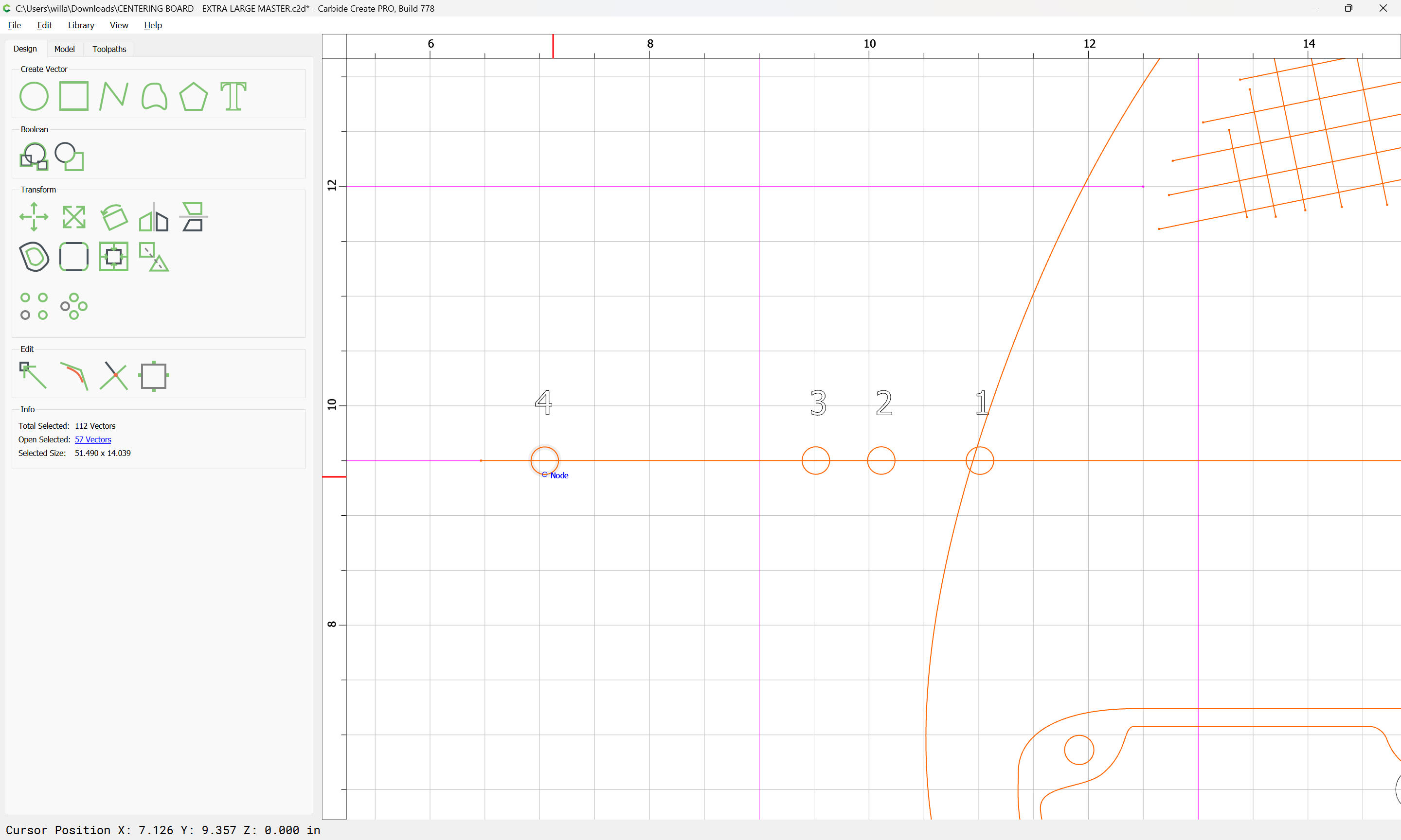

I get hole #4 at 6.9204 inches:

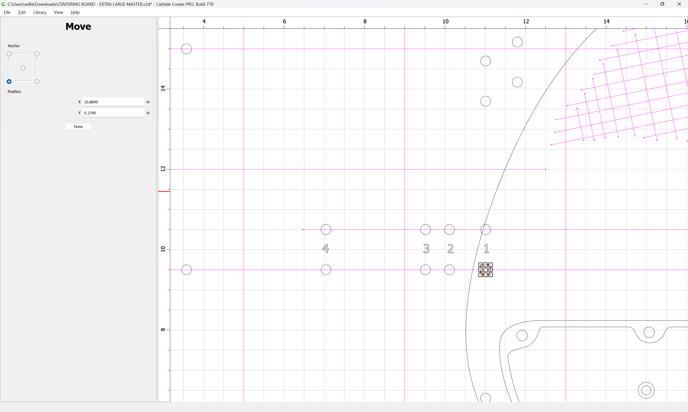

and hole #1 at 10.8849 inches:

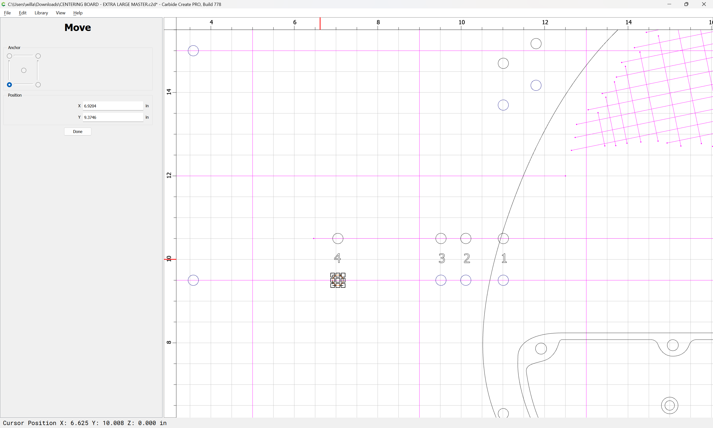

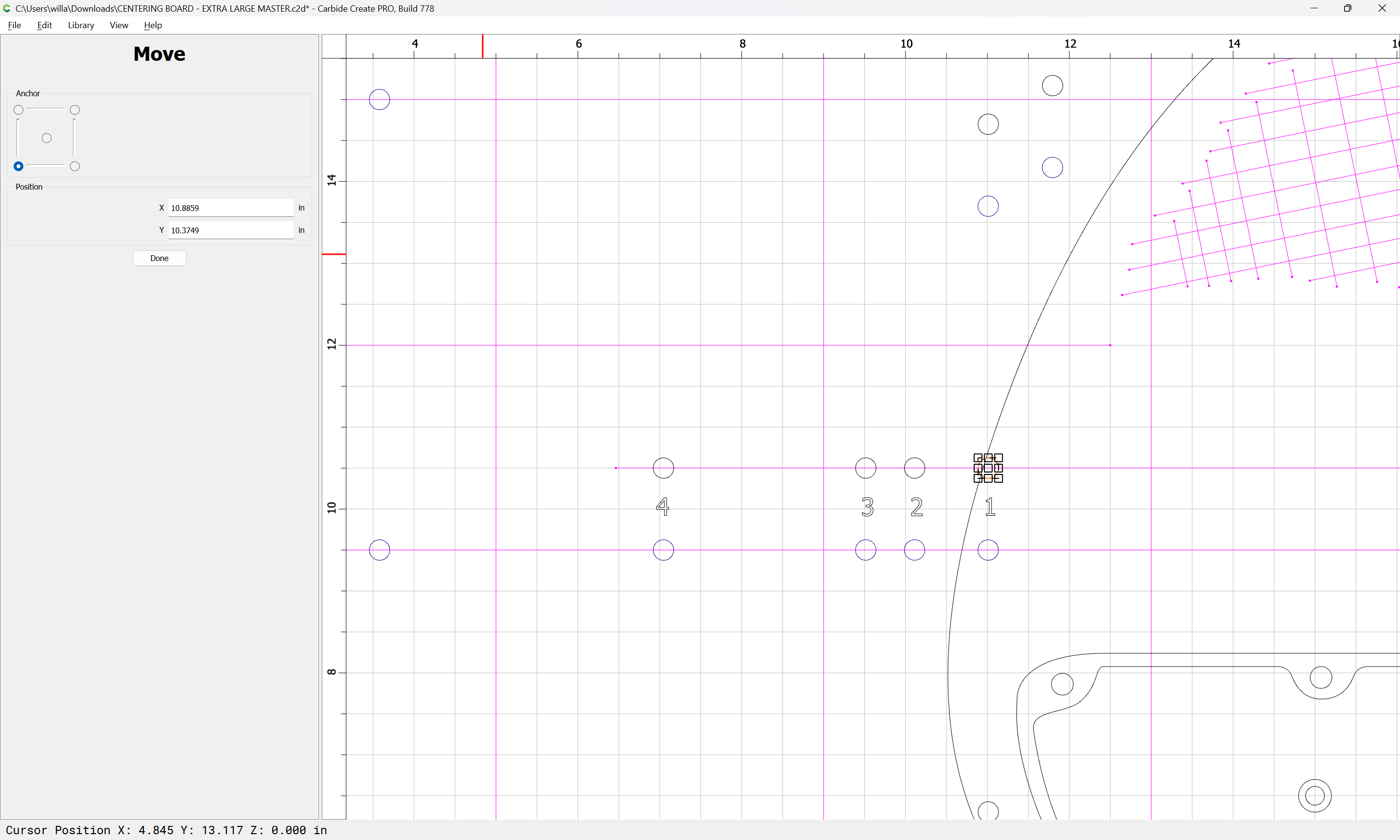

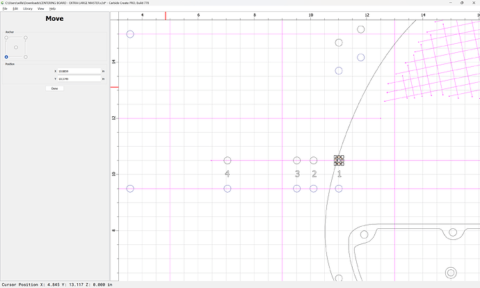

but the corresponding holes from the guitar file are 6.9203:
and 10.8859:
For reference the centerline starts at 6.4653:
Do those dimensions match in the Adobe Illustrator source file?

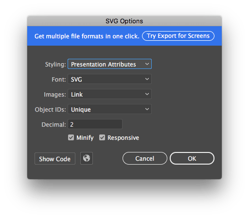

Apparently it is now:
File | Export | Export as...
per:
and that shows the “Responsive” checkbox which needs to be unchecked:

Some of the oddness when zoomed in all the way turned out to be the centerline in my Illustrator drawing was set to .25pt instead of .1 (hairline), and for reasons I don’t fathom, sometimes it would snap the index circles to the top of the line, sometimes the bottom. I was expecting it to always snap to the actual path. Very weird. I’ve fixed all that, but the root issue still persists. It occurred to me, however - as long as all my designs have whichever of the numbered index holes required for that particular design - then I can pull in the .svg file, -just- use the numbered index hole for precise placement, then use that and one or two of the other baseboard index holes which exist on a different dedicated layer and are always consistent.
