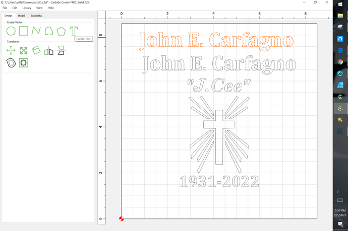

I’m working on a new project that I plan on adding some text. I liked the text I used on an older project, so I opened that project hoping to find out what text I used. When I select the text and then select the text icon all I that happens is new text gets inserted in the project. On the project I’m working on currently, if I click on the last text, I added it lets me see the details of that text but only the last one I added. Am I doing something wrong? Is there a way to edit text after it has been added to a project?

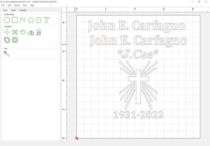

Yes, select the text and then click on the Text icon — if that doesn’t work, then the text has most likely been converted into geometry ---- is the Node Edit icon active when it is selected?

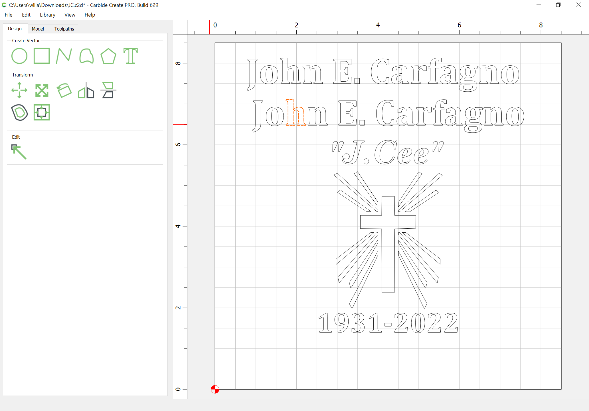

@rnicolson is correct — the text has been converted to curves — you can see this by ungrouping it and observing that the Node Edit icon is active:

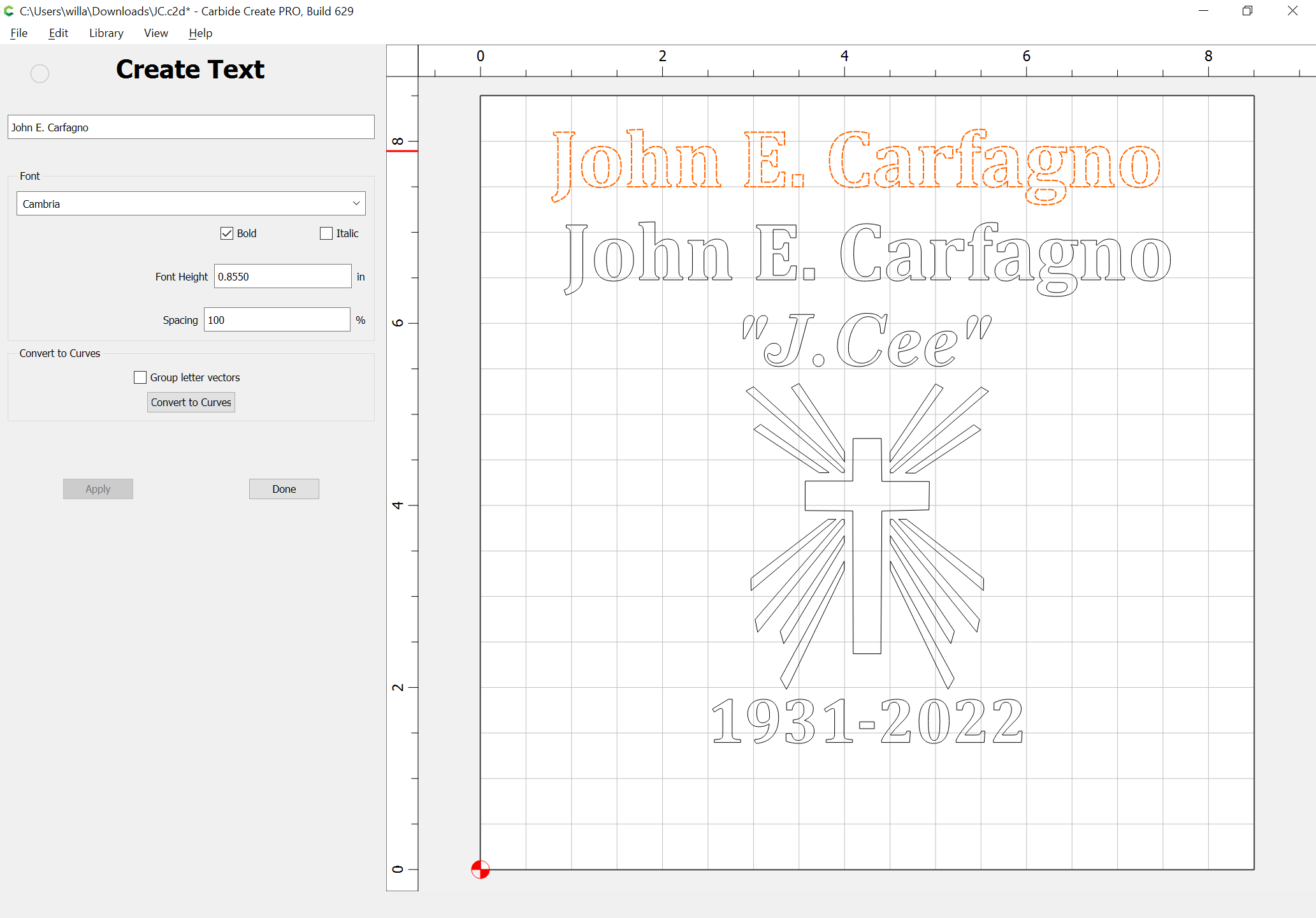

By way of contrast, if you select text:
there is no Node Edit icon, and one can click on the Text icon:

What exactly does the section “Convert to Curves” do to the text? Playing around I created text and clicked on the box “convert to curves” and as you mentioned the edit nodes then became available. It is only available to you when you select "convert to curves. So, with that text I can grab a node point and move it around. What would I need that? When would you use that?
There’s also a box “Group letter vectors” What does that do to the text?

Convert to curves if you need to union the text or manipulate it in other ways, see:
https://carbide3d.com/blog/merging-script-fonts-in-carbide-create/
Grouping combines letterforms which have multiple parts (the tittle on an i, the counter of an o, &c.) so that they will move as a unit.
