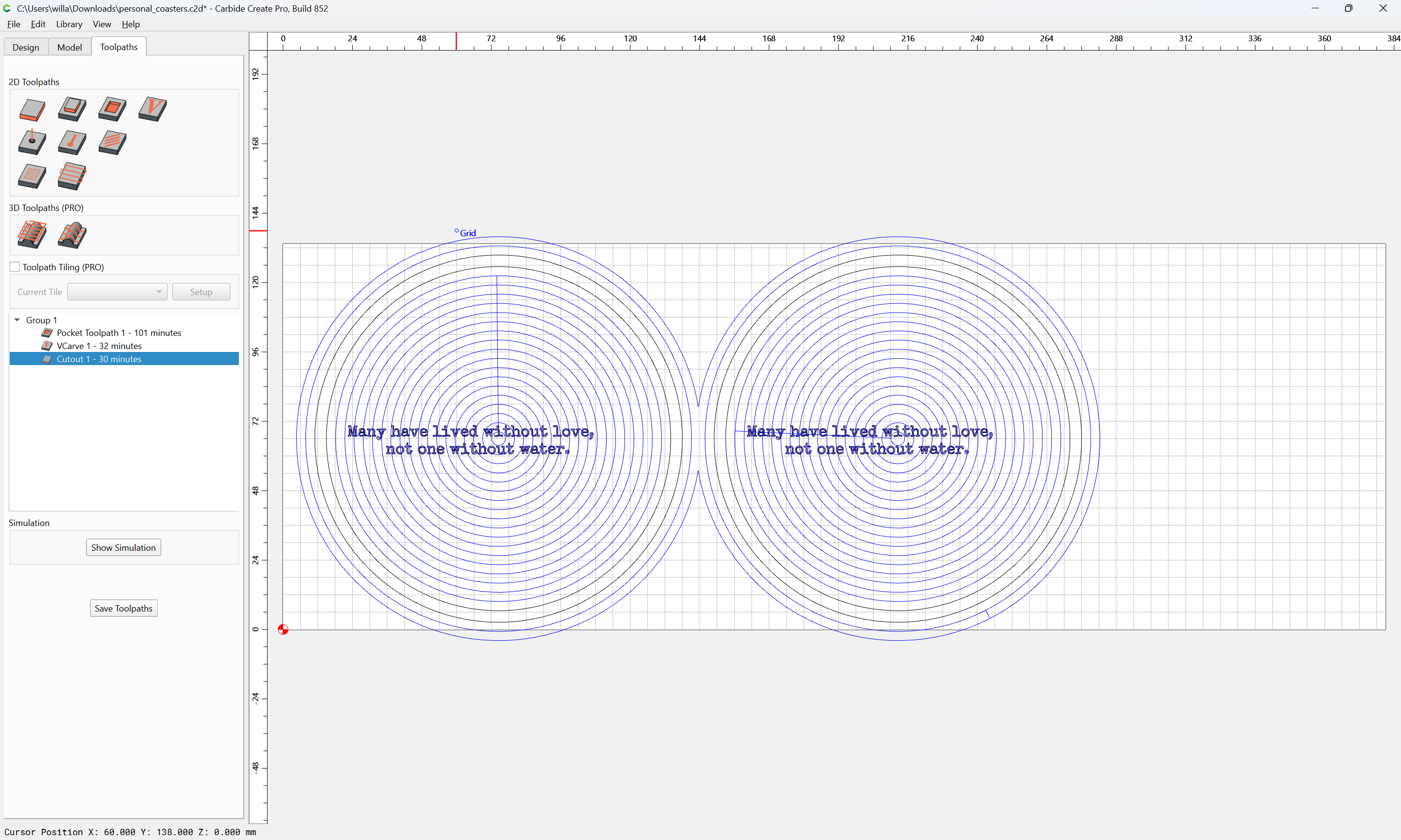

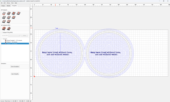

It’s not even a complex file, just some coasters with a bowl and tray bit and a V Carve bit.
personal_coasters.c2d (1.8 MB)

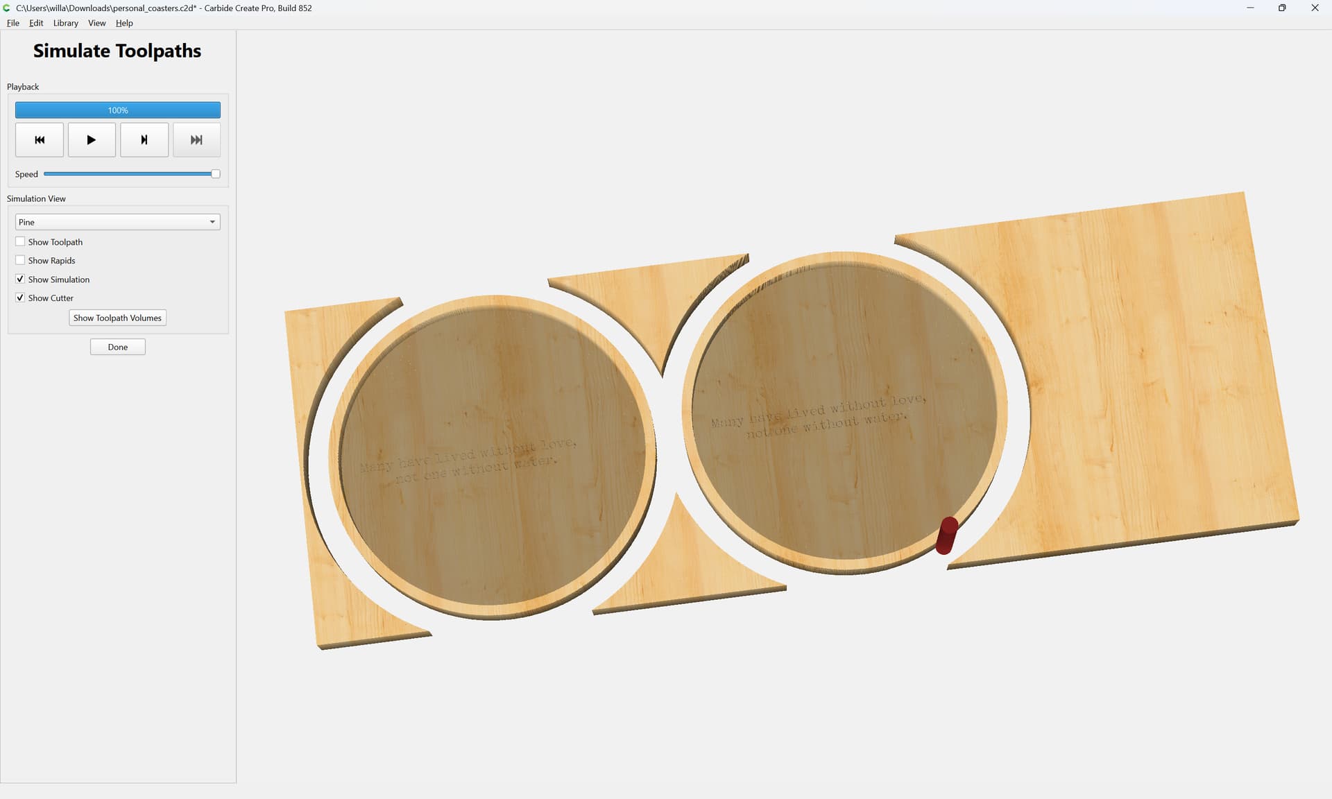

Not sure why you are using #102 DEFAULT — that’d result in some rubbing in such thick stock.
Was able to work up:
which at a guess is what you want.
Did convert some text to paths…
attached as a v8 file.
personal_coasters_v8.c2d (1.8 MB)

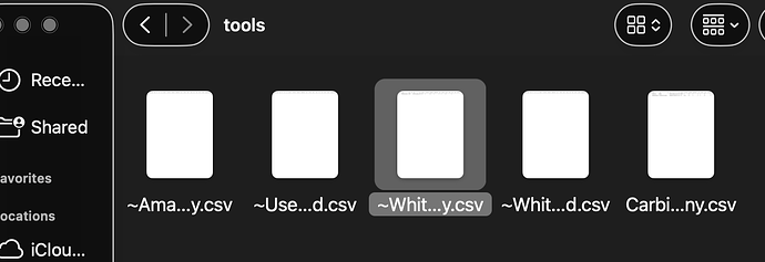

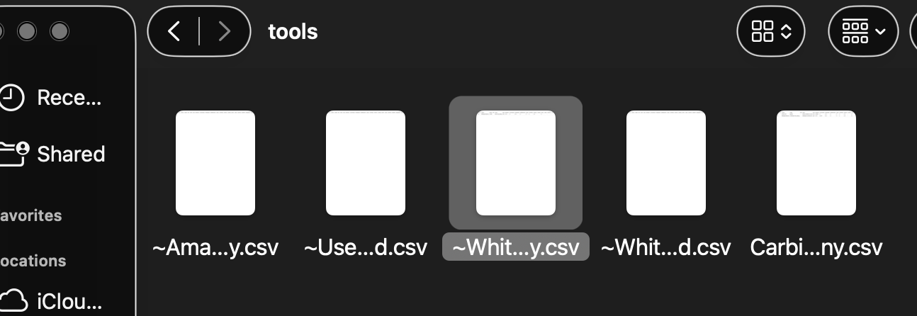

Do you have any custom tool libraries installed?
Any stray files in there?
Do Carbide Create app menu | About Carbide Create and click on “Open Data Directory”, then open up the Carbide Create and then the tools folder — what files are in there?
I do. I added two tools in there and one was a bowl and tray bit by Whiteside that I wanted to use for the pocket. It let me use it in the file you provided?
I will defer to what the folks at support work out w/ you on this.
My understanding iles w/ a ~ at the beginning have been deleted in the UI and won’t show.
