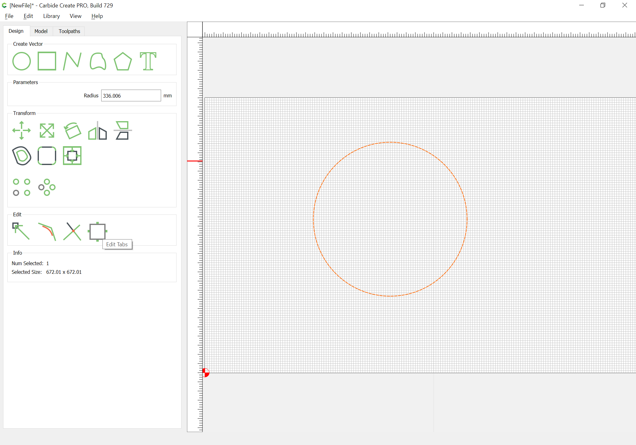

  1. A file saved in the v6 format from v7 should load into either v6 or v7 — if you have such a file, please post it. Please try making a very simple file in v7, say just a circle, then saving it — if it crashes, let us know at support@carbide3d.com
  2. First, create tabs:
OK
It should then work to set the size:
Thanks for the follow-up. The tab adjustment has been right in front of me all day, need to sit backfrom the screen.
