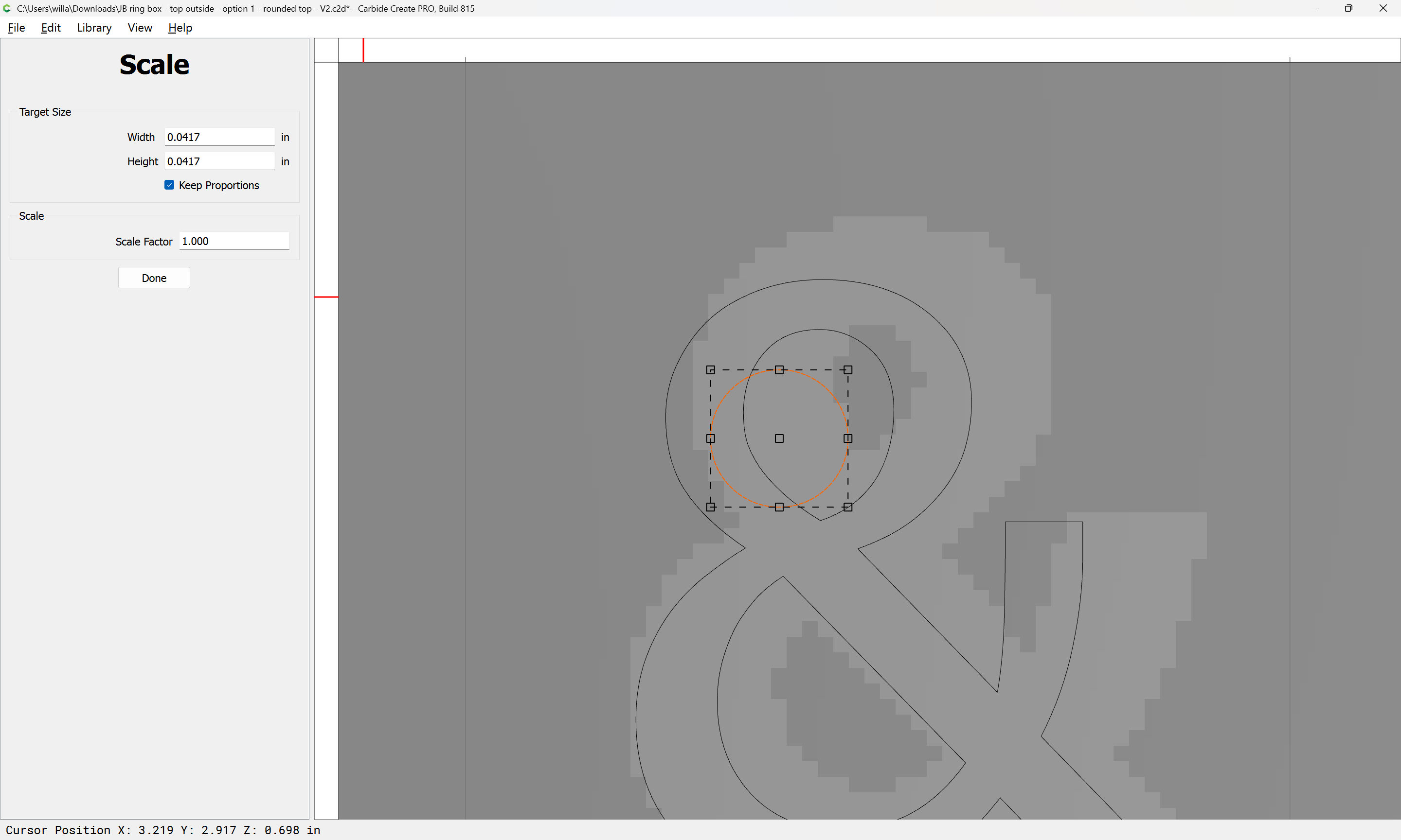

Looks like the smallest part of the lettering, the smallest part of the Ampersand (&) is about 0.035" (0.85mm). You’ll need a tool smaller than that to finish it.

Your design has letters which will require a tool smaller than 0.04":

As noted, you will need a tool smaller than 1/32" to reach into the ampersand.

You will need a tiny tool which is able to fit into this — you will also need for the tool to have feeds and speeds such that it will not break plunging into the narrow recess.

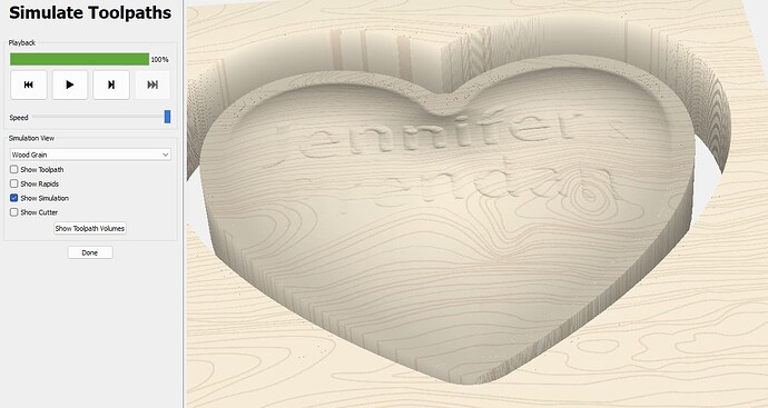

So I’ve gone back to a previous iteration for a couple of reasons but it elicits a big question. The text is done in the Model tab and here is the 3D preview of it.
Good depth of text apparently. I am using a 1/8 bit for roughing and a 1/32 tapered ball for finishing. Here is the 3D simulation in toolpaths.
The text is barely visible. Certainly not the depth it shows in the Model tab preview. I ran the file and the text is as it appears in toolpaths.
Any ideas why I do not get the depths as shown in the Model preview?
Thanks.
Are you using a tool which is small enough to fit into the recesses of the 3D text?
Yes. I tried doing a 2D version of the text and used a 1/16 bit then a 1/32 for the Rest machining. No issue going the depth or width of the text. Very curious results, or lack thereof. :slight_smile: The current version uses a 1/32 finishing bit as I mentioned.
1/32" is not small enough.
With an 0.04mm diameter (~1/64") tool one gets:
Eureka!
Attached is a photo showing you what I did. I contacted Carbide Support for any thoughts they might have. A number of them helped with one suggestion to reduce the height of the model. Flemming sent me his version of the file which worked, the one change was his use of a straight 1/32 round bit. I took Flemming’s advice and changed the material thickness, then ran the file again but used the tapered bit I had been using. The result was the sample on the left. Nothing had changed. Then it hit me. I made all the changes he suggested including choosing the straight bit, but when it came time to insert the bit, I substituted my tapered bit. Result was the sample on the right.
William pointed out that Carbide Create does not support tapered ball geometry so the 3D preview would not be accurate. Unfortunately, the end result (sample left) was exactly what Carbide preview showed. Somehow, substituting the tapered bit while having picked the straight bit made all the difference.
