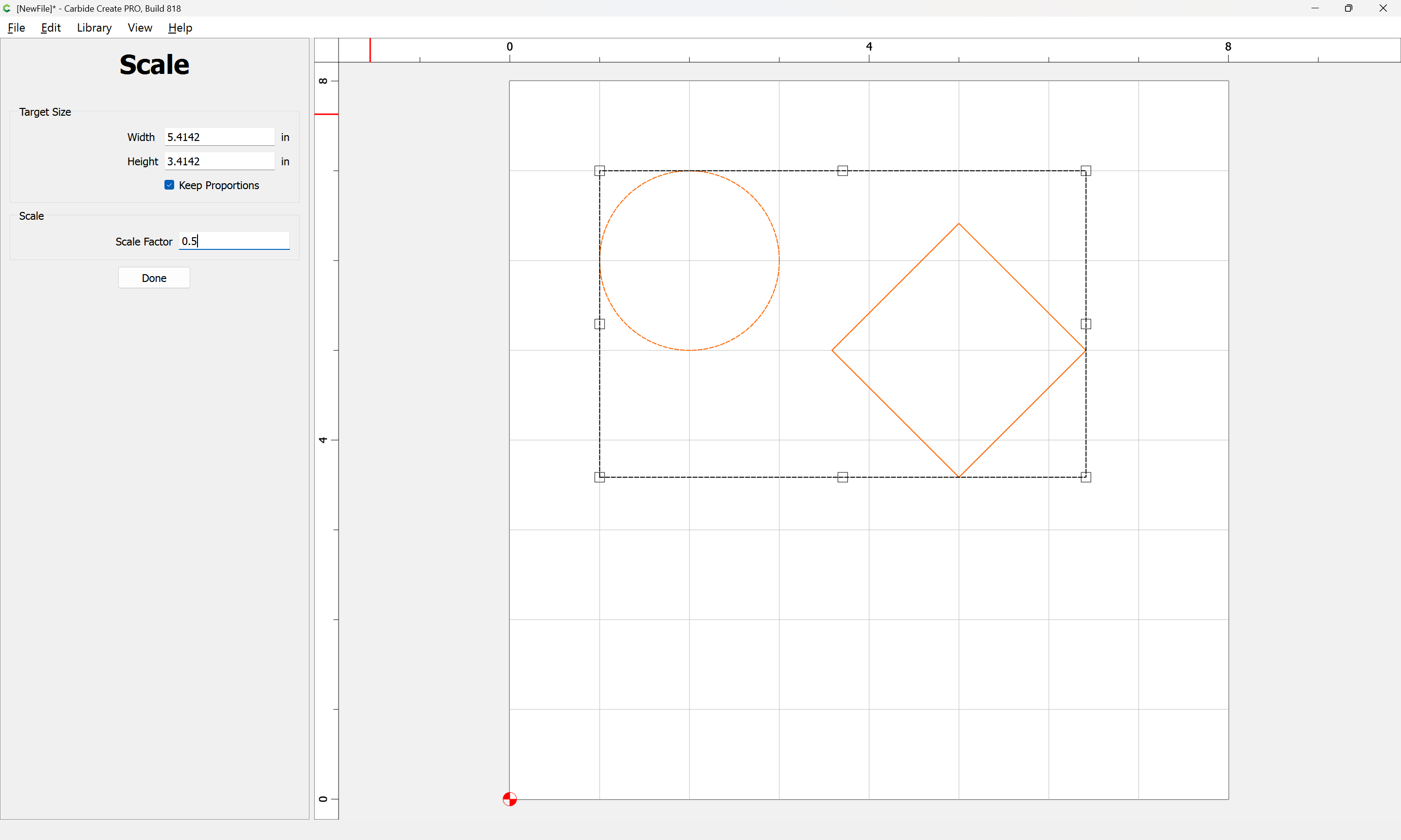

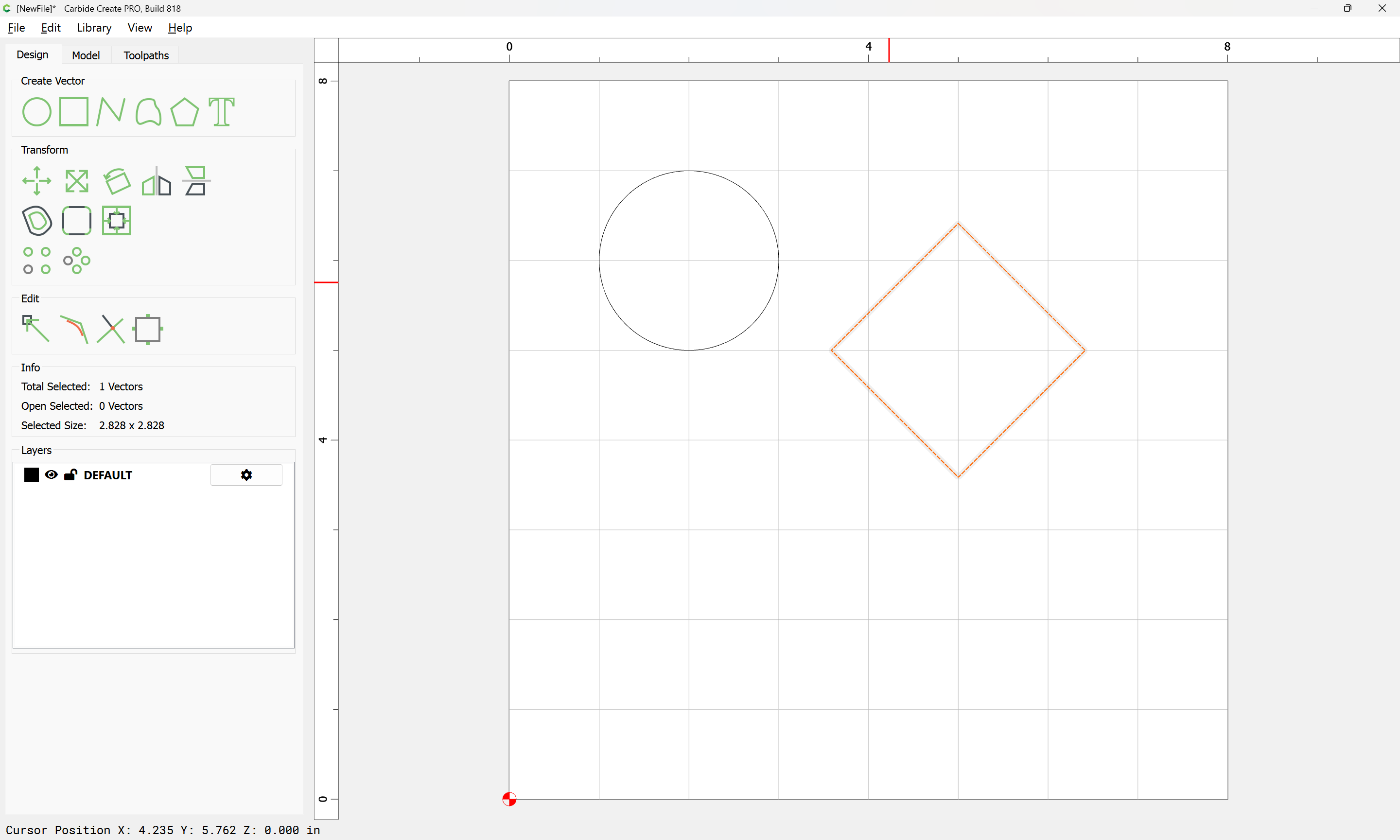

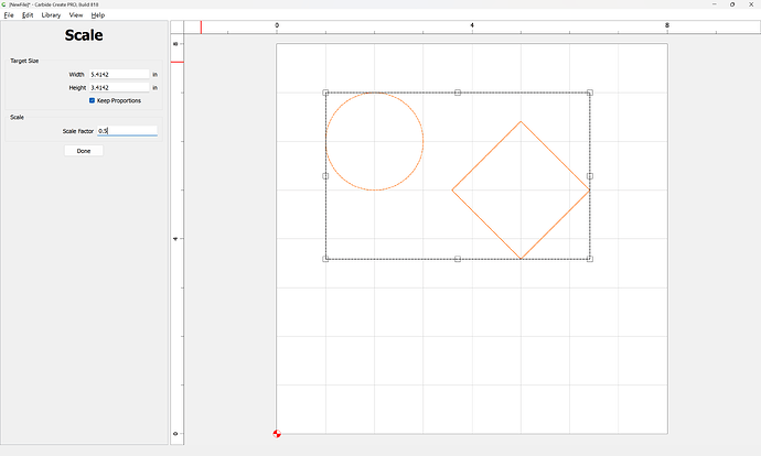

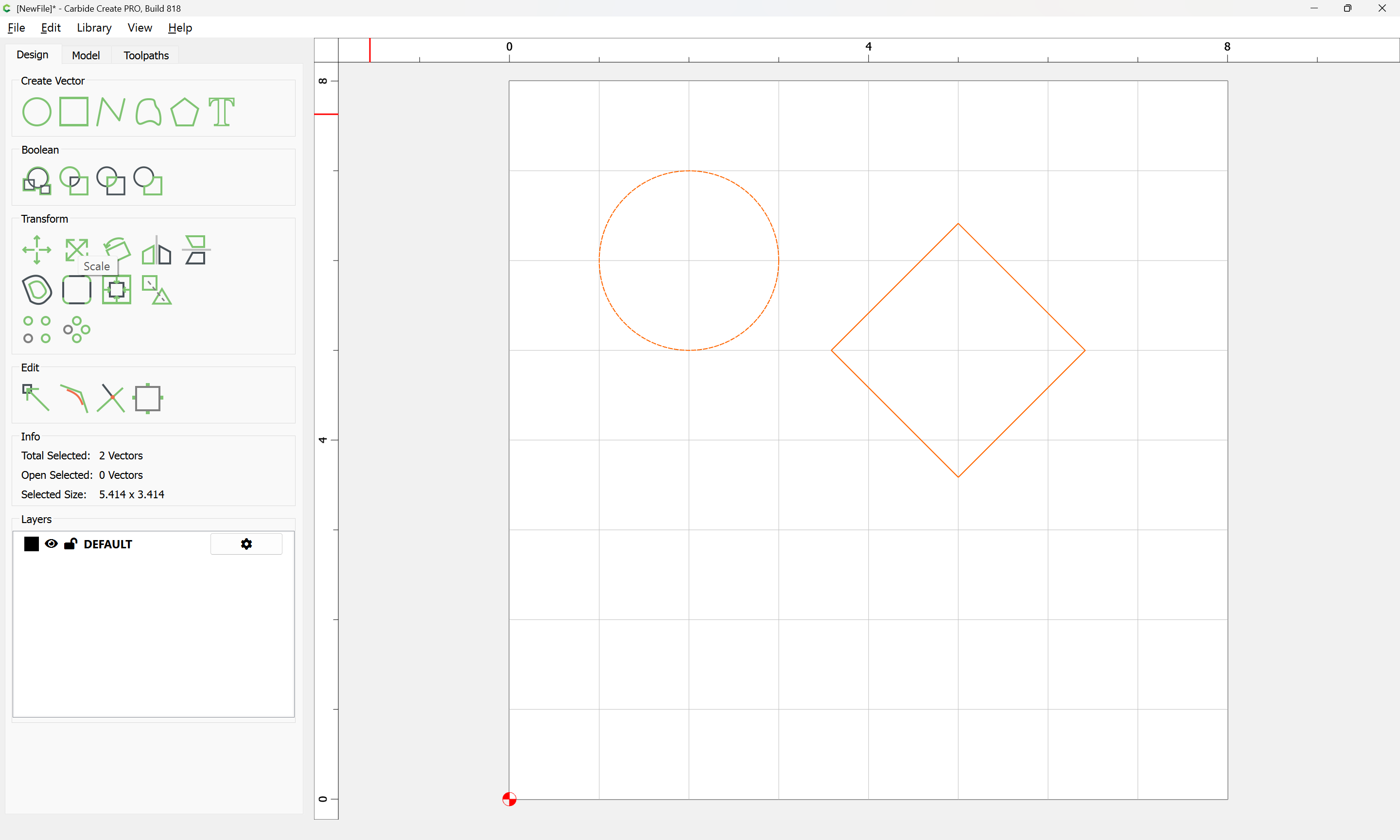

Draw a rectangle:

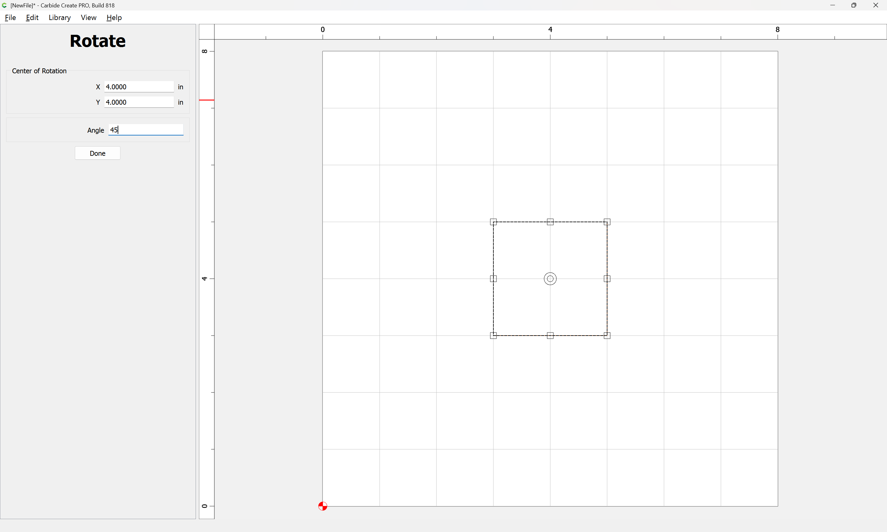

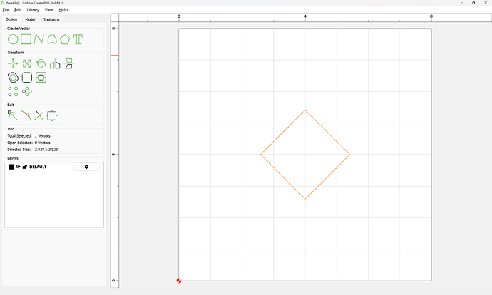

rotate it:

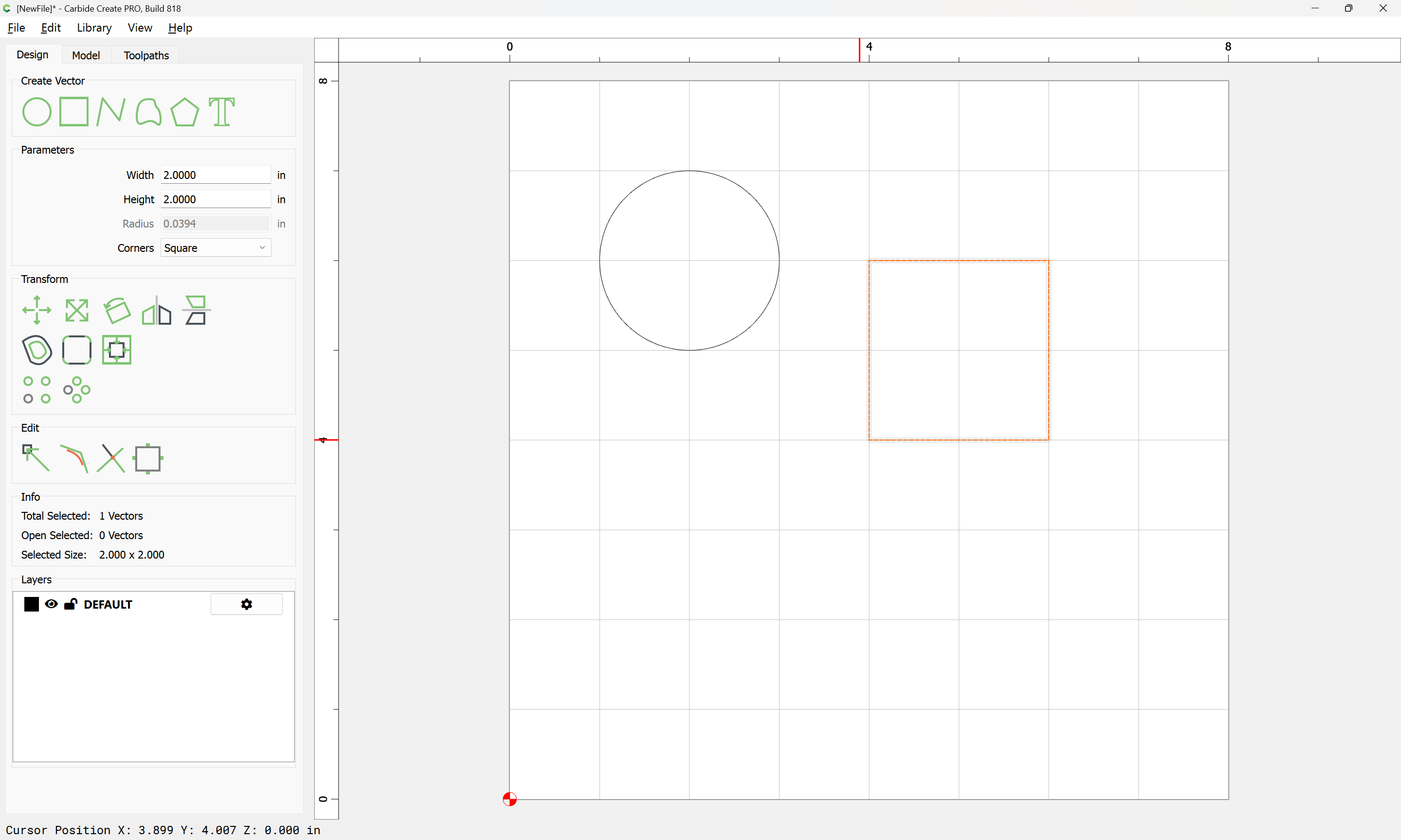

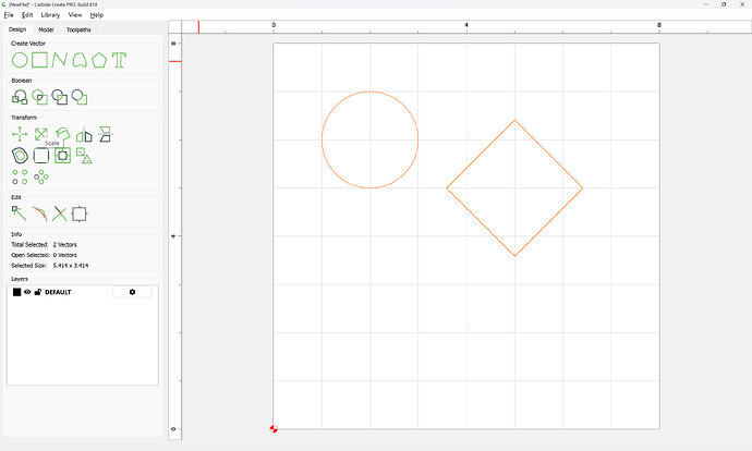

add a circle to the selection:
re-size:

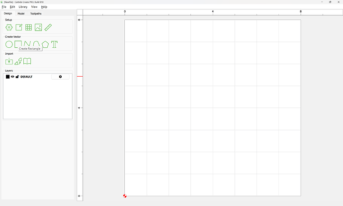

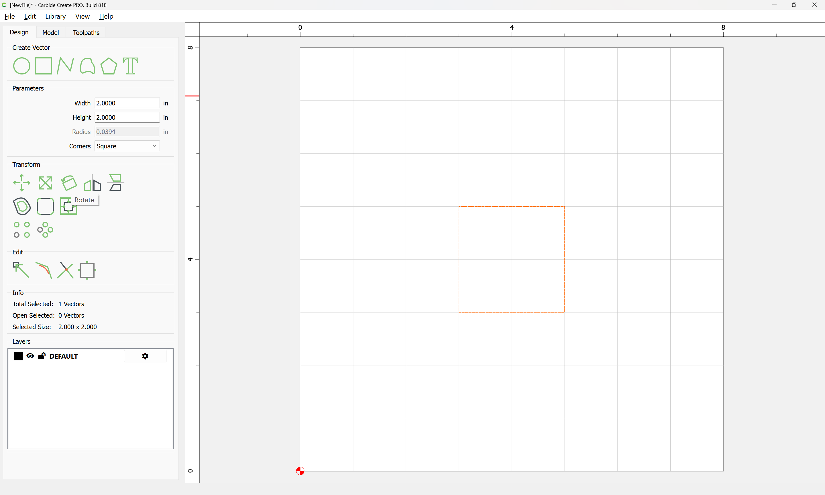

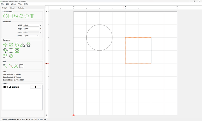

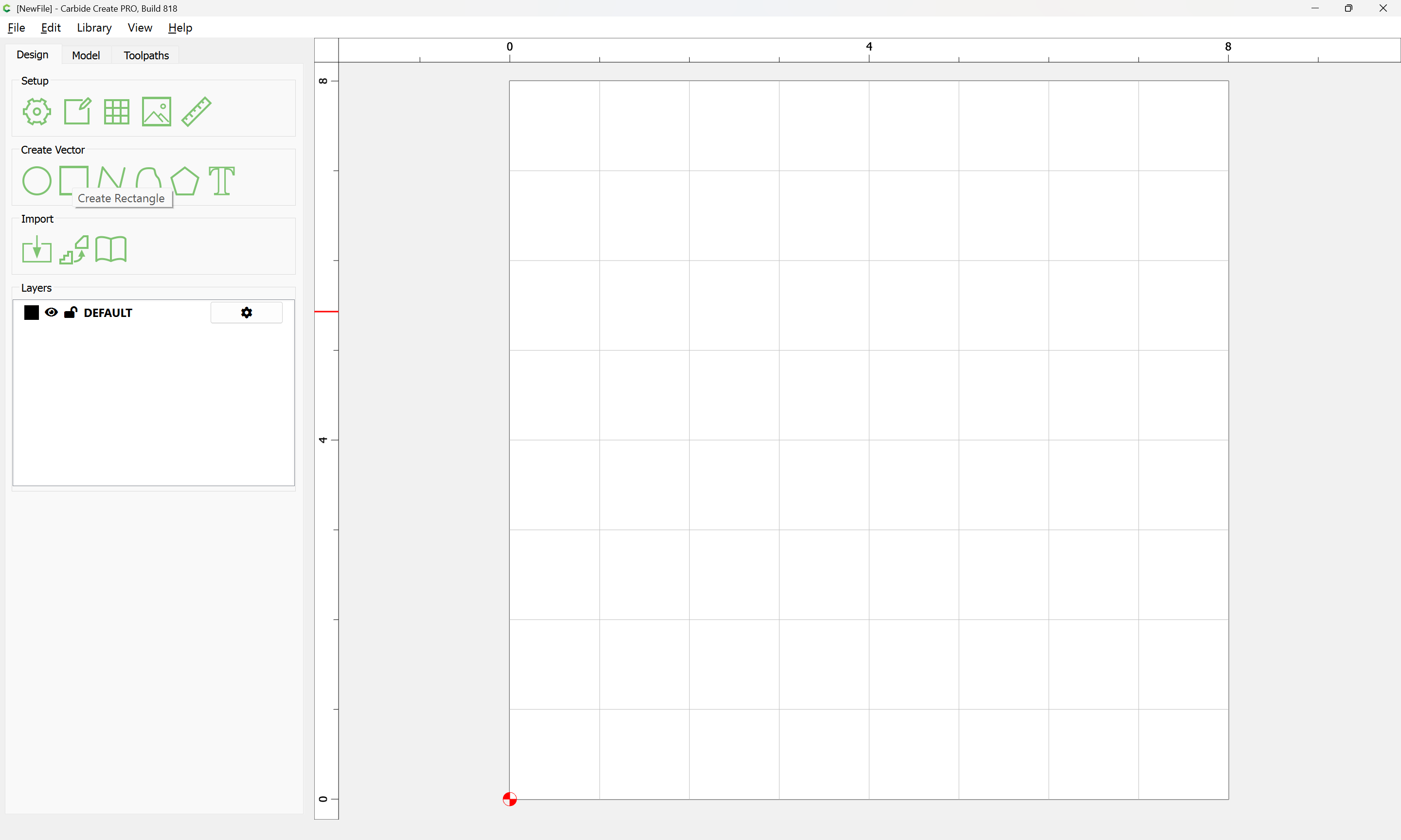

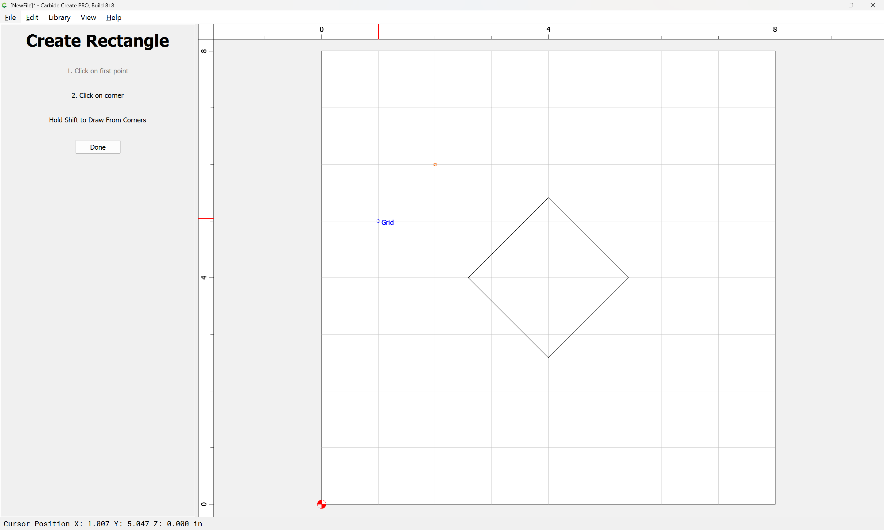

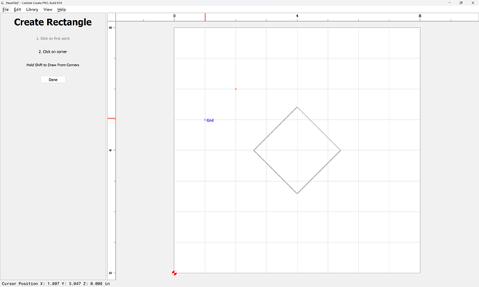

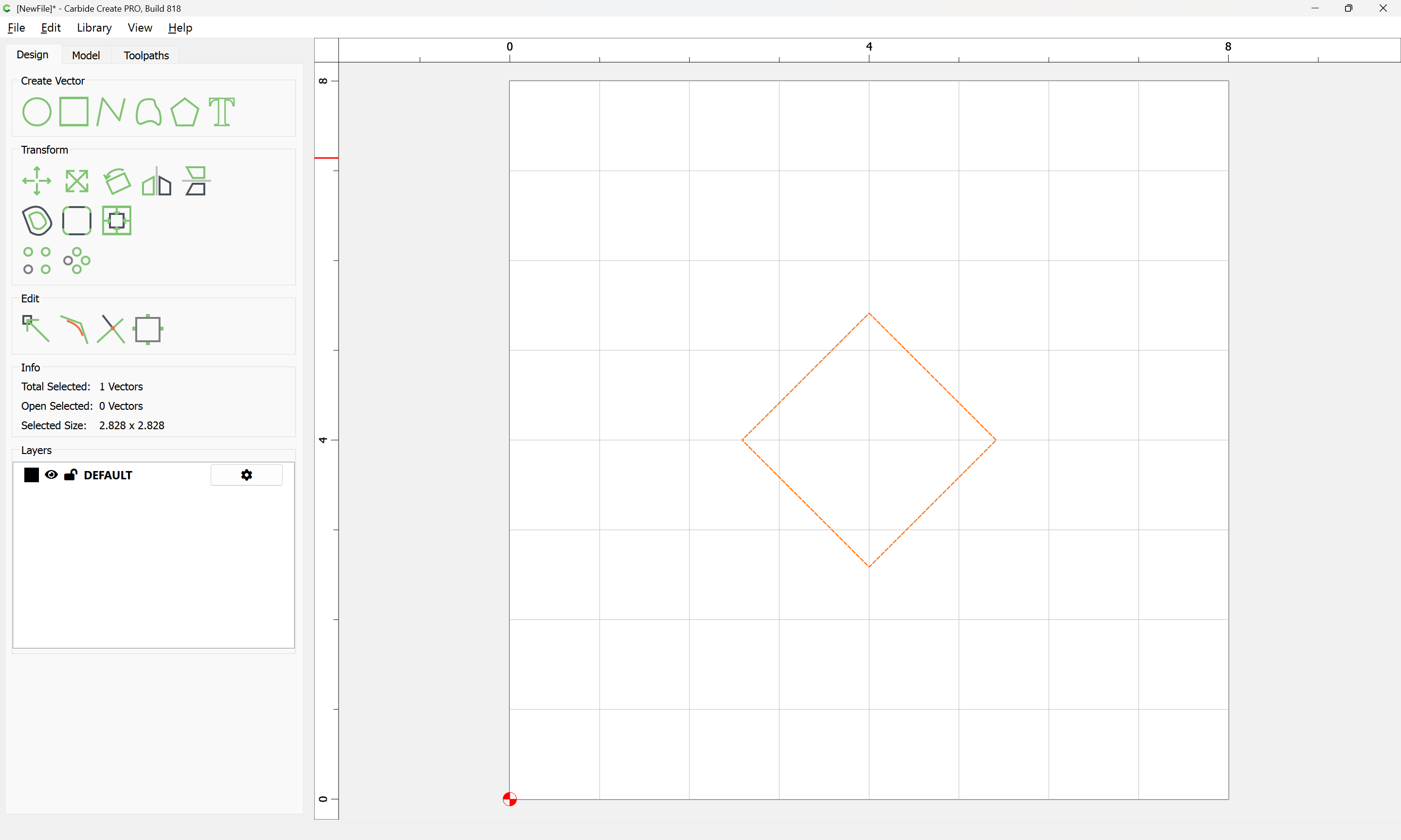

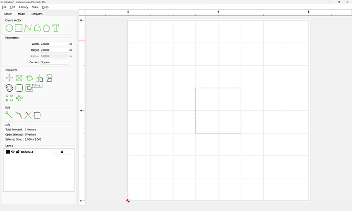

I believe the problem which you wish to report is:
  • launch Carbide Create
  • draw a rectangle (or possibly other object)

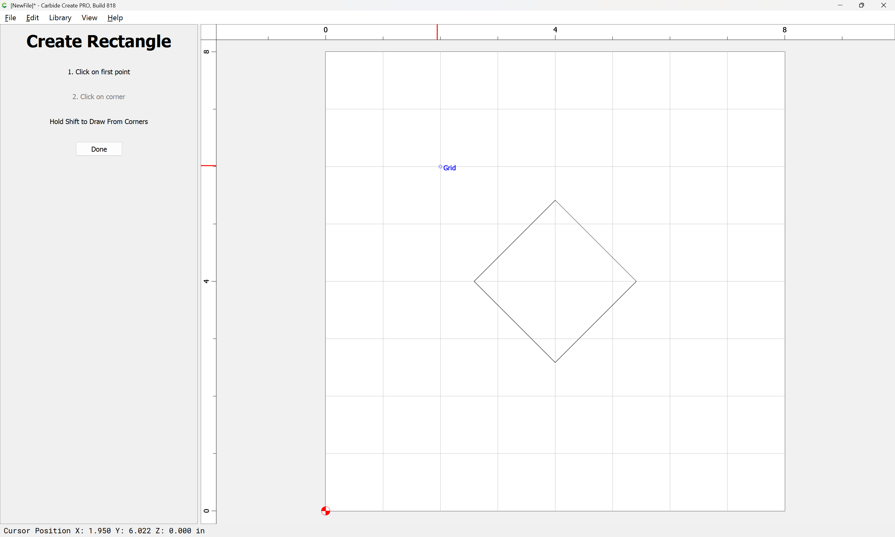

  • rotate it:

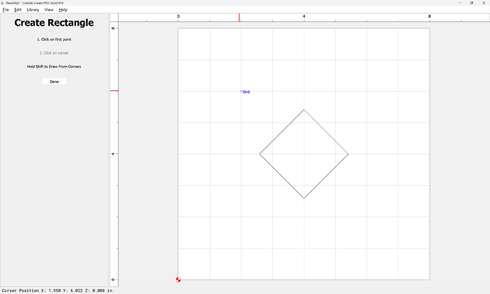

  • try to create a new object (rectangle was selected):
It is impossible to finish drawing the new object.

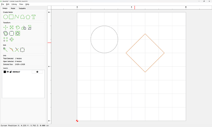

Further testing shows:
  • creating a circle
  • “rotating” it (since circles cannot be rotated)
  • attempting to create a rectangle
also evinces this difficulty.
EDIT: I’ve been able to re-create this with various other sequences and trigger a crash, and am testing all possibilities and sending in Bugsplat reports which should allow investigation.
The last 2 screenshots of your reply is what my post is describing. I too got the bugsplat when I tried doing it. Thanks for confirming.

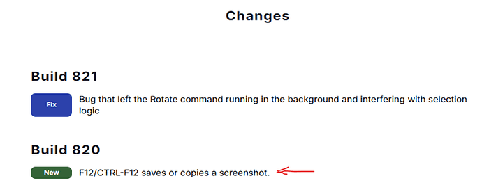

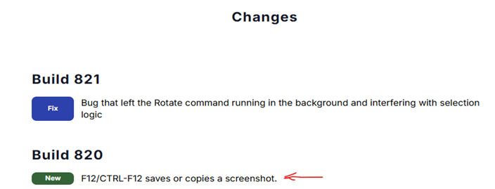

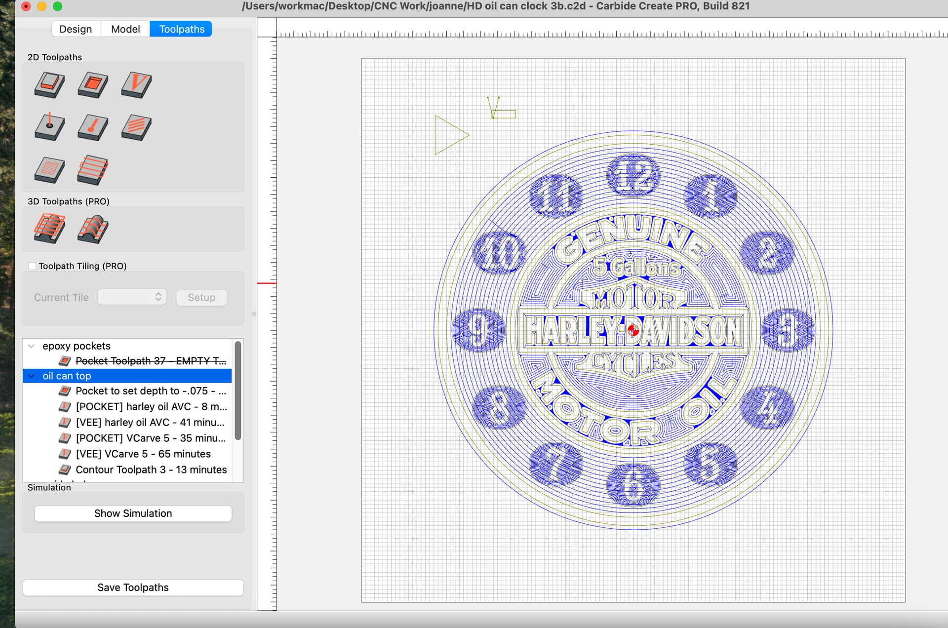

Screenshot new feature mentioned from 820 beta release note doesn’t work.

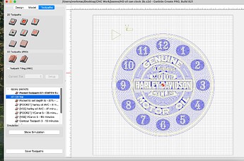

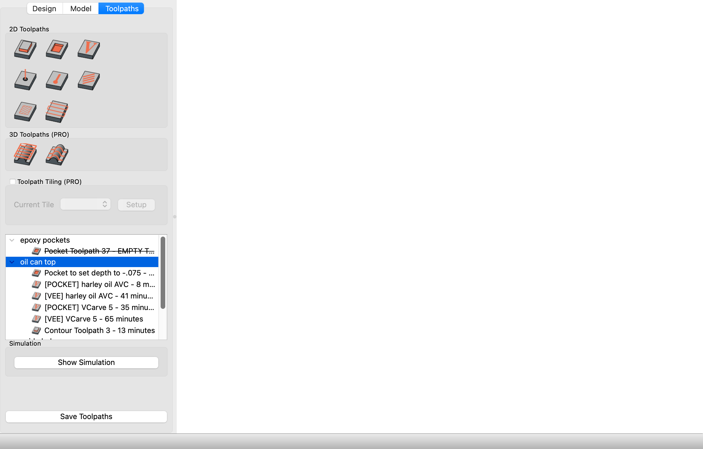

I like the idea of being able to capture a screenshot from CC. However, it doesn’t work. Here is what happened when I tried it.
I want a screenshot of this:
I pressed the F12 key to take the screenshot and save to a filename on the desktop. Here is what appears when the screenshot file that I saved is opened.
Definitely needs to be revisited!
I can not get the copy function to work on Mac,all it does is put the sound up.
Is your keyboard in Function key or media mode?
Not working on my MacBook either. The first screenshot is using the Mac screenshot method. The second is using the Function / F12 keys in Carbide Create 821.
Edit: MacBook Air running Sequoia 15.6.1
