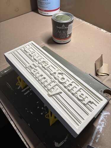

I’m at a 3 steps forward 2 steps back impasse with Woodgrain. I got what I want but it’s too shallow and the paint roller hits the grain when going over it. As I go deeper things get screws up. Training with Tyler tonight to see if we can get beyond it, else doing a deep dive into textures to see what I can come up with.

Actually, Tyler gave me the tools I needed. Produced my fist sign start to finish with woodgrain today.
file:///var/mobile/Library/SMS/Attachments/cb/11/442FAB5C-0236-47F8-BA08-24CF4A6DF0D1/IMG_9935.
Paint today and tomorrow, deliver Monday. That is the end game I’ve been heading towards. Now…the world opens up on the other side.

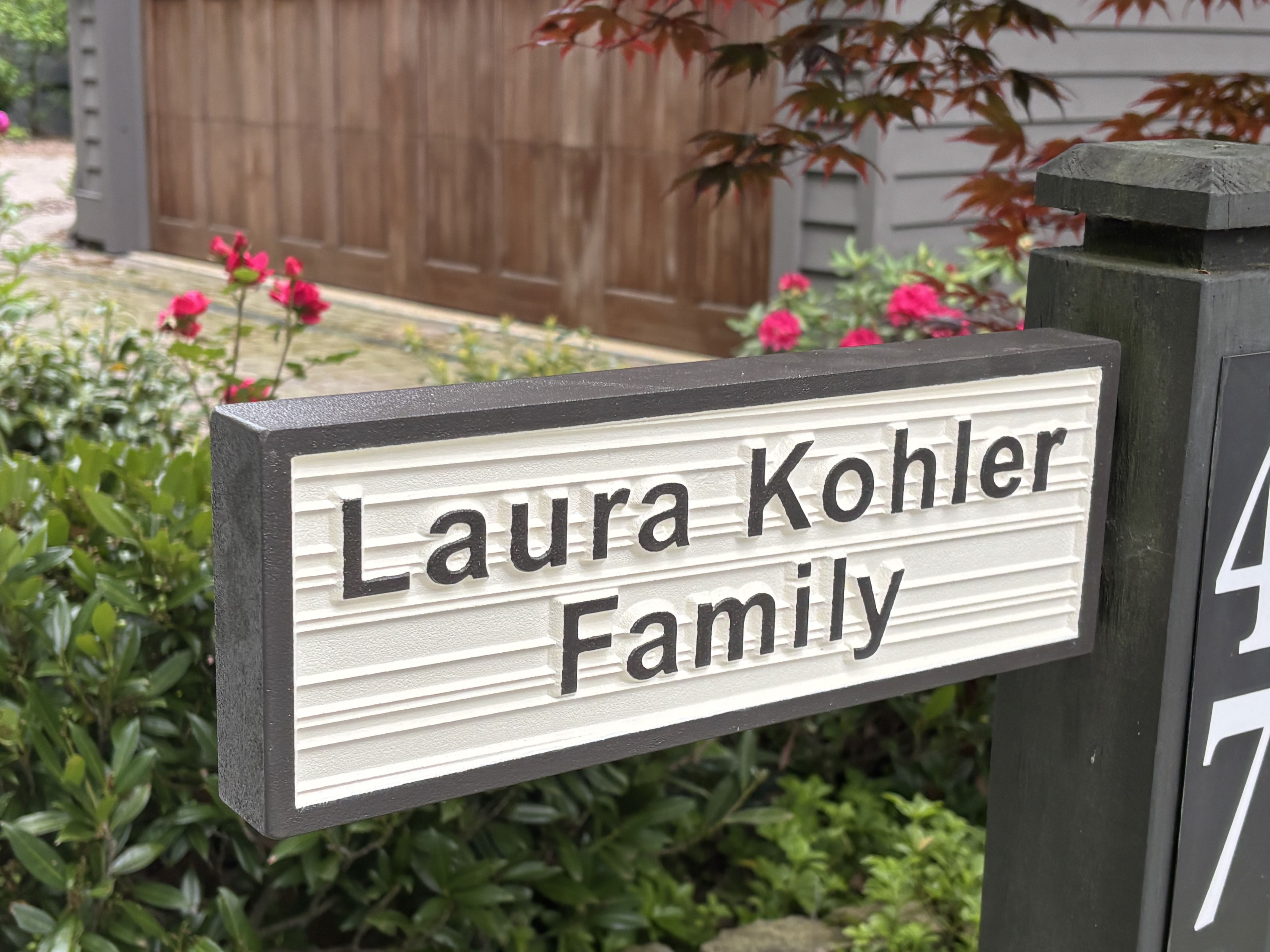

Awesome! Now lets see it!
Installed today. Billed today. Another 8 waiting to get done!
A few small tweaks. ALWAYS there are tweaks! But beyond this bottleneck!!

Looks great. Is that PVC or HDU?
It’s HDU and thank you!

Very, very nice! Excellent finished look. Good job.

If you zoom in to the fist pic I posted of the sign you can see the “texture” of the HDU.
