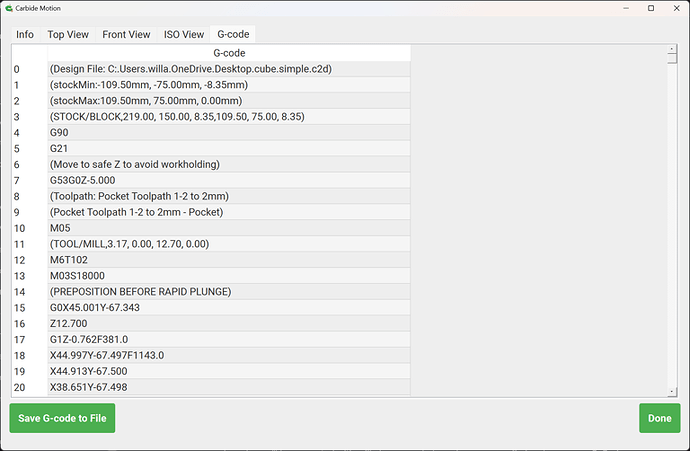

Carbide GCode extractor not loading
Anyone else having this issue? Page gets stuck on “uploading file”.
Do you own a Carbide 3D machine?
Note that you can connect to your machine w/ Carbide Motion, then save the G-code to a file after Carbide Create extracts it and shows a preview.
I have a shapeoko 3XXL, using CC build 757. I thought the only option was to go to Carbide site and use the gcode extractor, thats where it’s hanging up. how do I extract within CC?
click “Save G-code to File”
Just to note…the Save G-Code to File is available from Carbide Motion, not Carbide Create (CC)…not correcting anyone, just making sure it’s clear where this option exist.
I may be an idiot but where do I find this in CM? I am using build 566. EDIT: Just updated CM to build 640.
Ok, doing this from memory since I’m not in front of my machine…
  • Load desired file into Carbide Motion
  • You get a screen (Job Info) that will show tool order and how long the cut for each tool will take
  • I think at this point you will see options/tabs across the top of this screen for Top View, Front View, ISO View, Gcode
  • Click on tap “Gcode”
    Again, doing this from memory…hope that helps.
