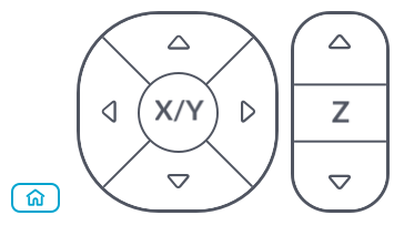

I have found the Repetier Host UI much better than the CM UI. I have explained this before, but I guess progress is slow. You can see the RH UI here.
What is not obvious from the image is that each of the six motion areas (X+, X-, Y+, Y-, Z+, Z-) is divided into 3 different bands, from .1 mm to 1 mm to 10 mm. As you move the mouse over the areas, the bands light up to show you what motion would result were you to click at that instant. This is MUCH faster and easier than having to set and reset the Increment values in the CM UI. I hope that some day CM can move forward to where RH was 8 years ago.
