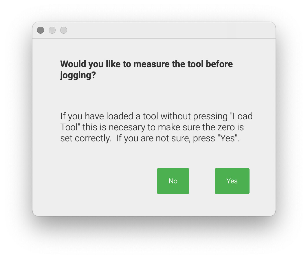

Switching to the Jog pane now results in a prompt to inform about measuring the tool:

Developer/designer critical mode turned on:
  • Choice of when to use bold fonts is not a good choice of when to use bold fonts.
  • Font sizes seem inconsistent.
  • “Necesary” needs a spelling check.
  • UI spacing is terrible. You need a designer’s eyes. They are often different to developer’s eyes.
  • “If you are not sure, press yes” … unexpected.
  • “choose” is probably better that “press” here
  • Stop is always red and ugly in the bottom of the screen even when it’s clear it won’t stop anything.
  • “MM” as a unit is wrong. It’s “mm”. Always.

If ‘press’ is not used any more what word is in vogue these days ?
Just a curious old guy - or should I say gracefully aging gentleman :slight_smile:
Bill

I probably overstated the importance of the word in my over-zealous critique… using "press "is okay. Typically if a mouse was detected/typical it would still be “click” or if a touch screen was there it would be “tap”.
Open mouth, insert foot. Yes, I was not reading correctly.
