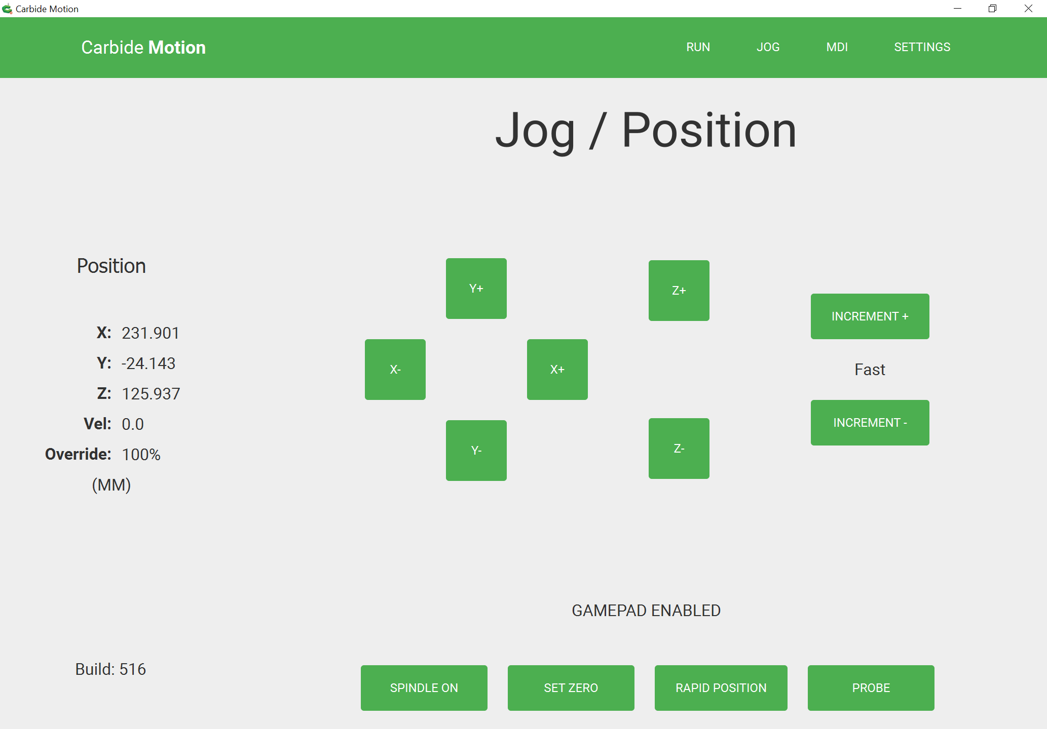

It should just work — do you see the “Game Controller Enabled” message at the bottom?
Bottom of what?
I see no message Game Controller Enabled.

At the bottom of the application window.

I was able to verify this — works in build 516:
but doesn’t in 560 and 563 — we’ll see if we can get someone to look into it.
