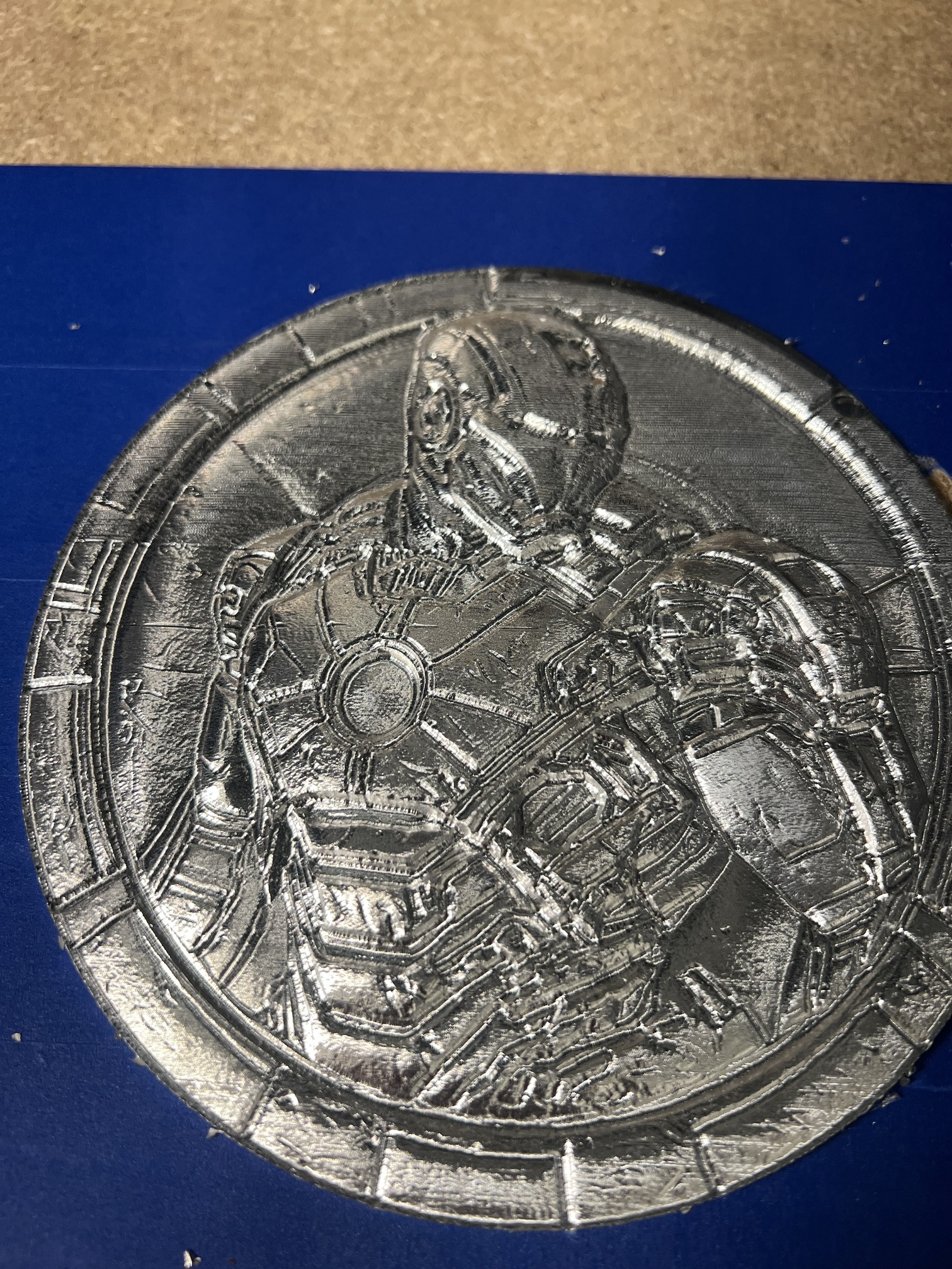

I had a 4 hour program loose connection and freeze. I followed the restart and picked a point several lines before where it had stopped so there would be no material to remove.
It went to the bit setter the prompted to turn on the router. Everything seemed fine, but some how the z must have been off a few thousands, because the bit started removing material and before I could stop it the .0625 ball end mill snapped off. Is there anything else I should verify before sacrificing another bit ?
Do you have a photo of the section where the recut began and the cutter snapped?

Theres not a lot to see, but the pass was from right to left above the center of the chest. About 3/4 of an inch above is where it froze.
As someone new to the hobby what are your thoughts on the surface finish? I don’t really know what I can expect. This is a .003 step over as well as a .003 depth of cut. Feedrate around 70 ipm at 20,000 rpms.
The tool path is one direction as well.
Thanks for your time.

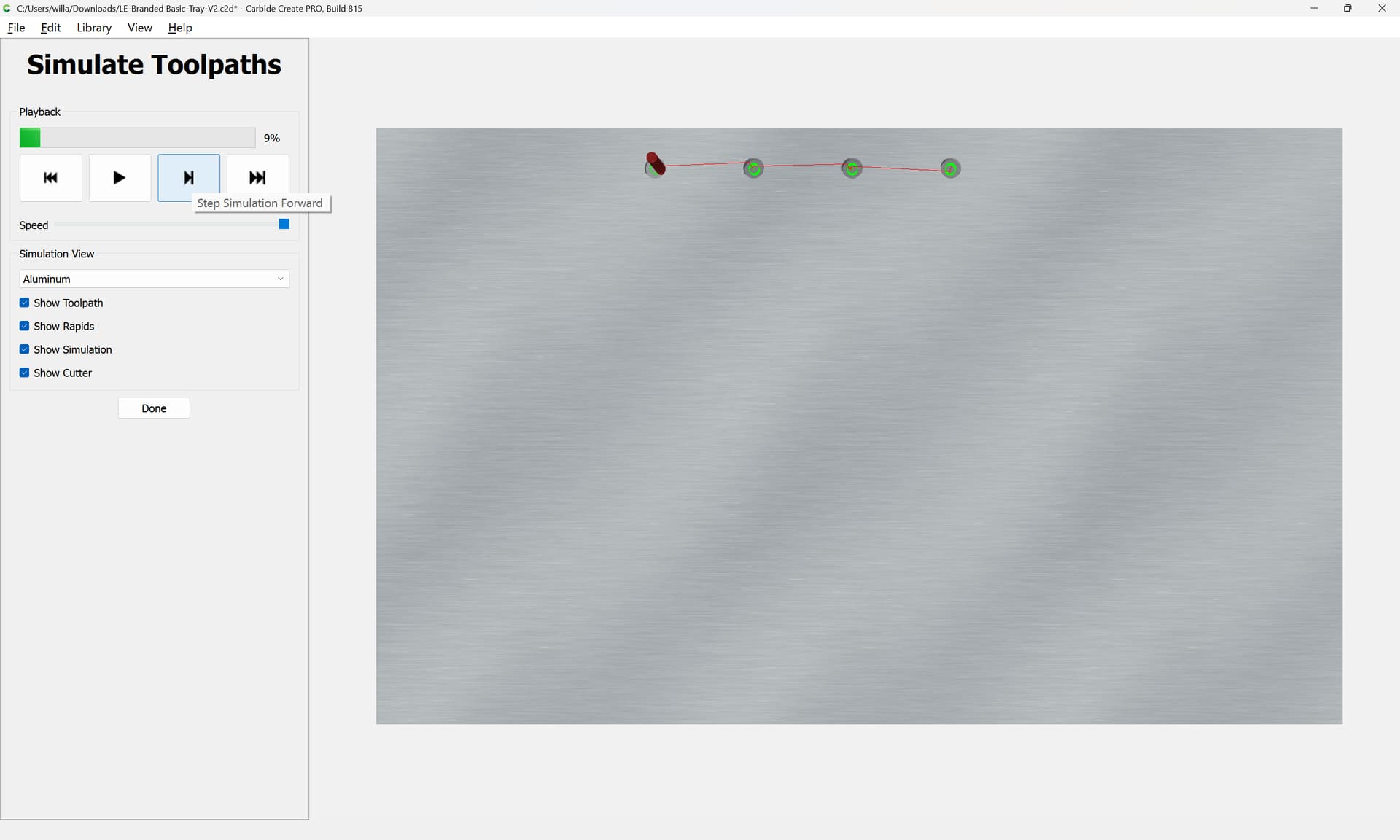

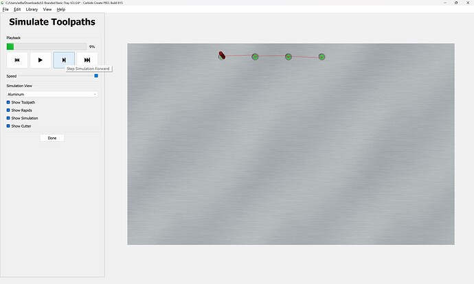

Are the Simulate Toolpath controls for G-code Preview not sufficient?
Using the “Step Forward” button, one can do just that:
