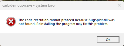

Hello,
I ran into the same problem when doing a clean install (uninstall previous version before installing a newer version) of this new beta version CM 644. The error message shown in the screenshot blow says there is a missing .dll file (Bugsplat.dll) in the installation file set. This same problem I noted in the forum with the earlier beta CM 642 version.
If one does an install of CM 644 overwriting (don’t uninstall) the previous released version CM 640, the Bugsplat.dll remains in the installation folder from CM 640. Then the error message doesn’t appear because the .dll file is present. I think anyone installing CM 644 with this issue of the missing .dll file in the installation file set on a new PC will run into this error message. The software team may want to rebuild the installation file to assure Bugsplat.dll is included.

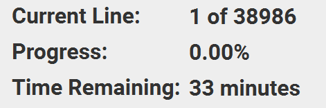

Well, if you pause the program, you can see what line it was on.

“Restart Program” doesn’t actually restart it. It prepares for a restart, you have to hit the ‘Start’ button to make it go.
Once it’s been prepared, there’s no indication that it’s in the ‘Prepared’ state.
The ‘Start’ button text should be more dynamic. After a ‘Pause’ or a ‘Restart Program’, the button is really a ‘Resume Program’. When I see the word ‘Start’, my first expectation is that it starts - i.e., the program runs from line 1. I know better now, but it wasn’t clear when I first started using CM.
