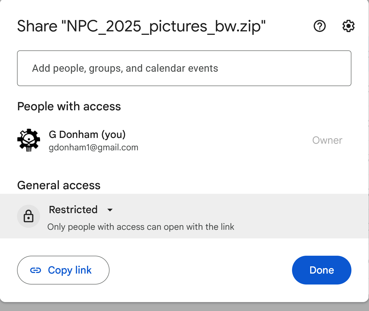

I ( think I ) fixed the access a while ago when I got a message you were trying to get to the files. Please try again. I need to confirm I am allowing access as I expected.

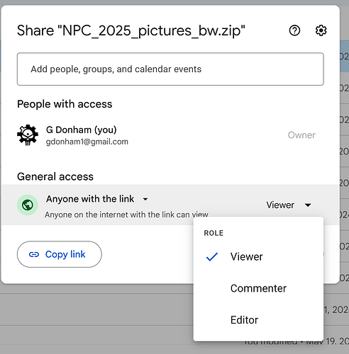

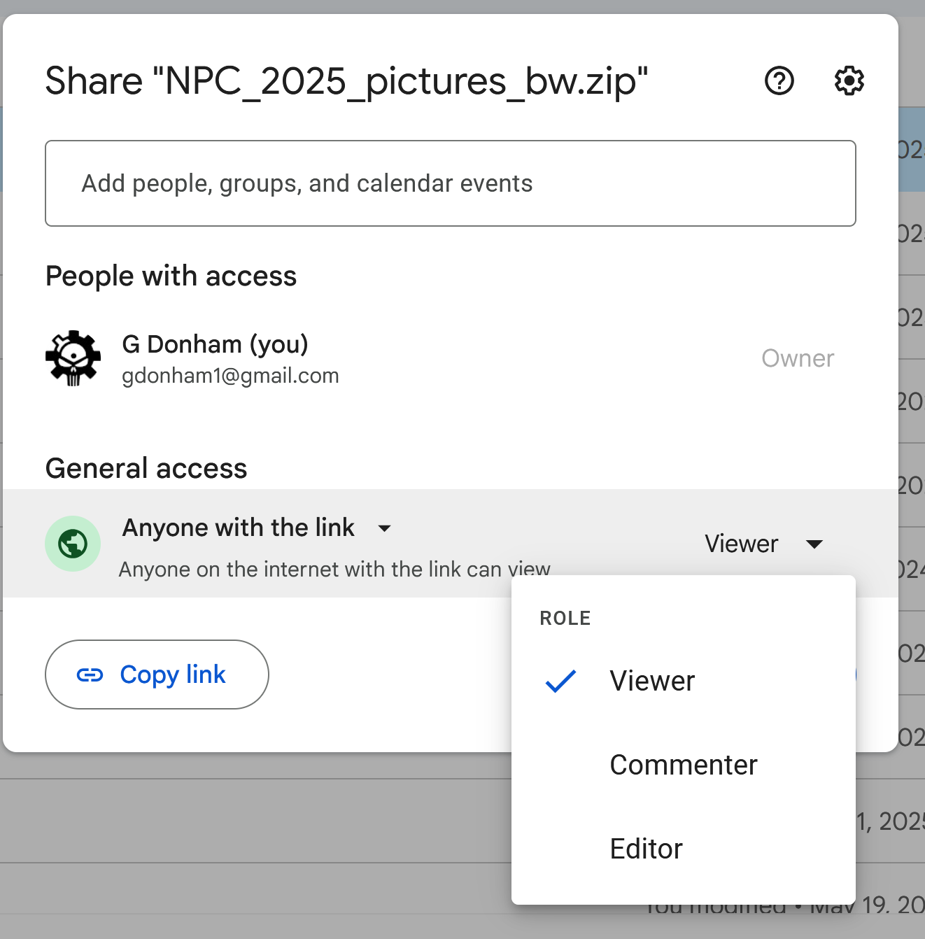

There are multiple options in Google Drive
Then under General Access you can specify a specific person. You can still restrict access to only view, comment or Edit.
I generally use Anyone with the link because I am emailing a specific person. They could share the link but my files are not super secret. However to only allow a certain person choose only view.
