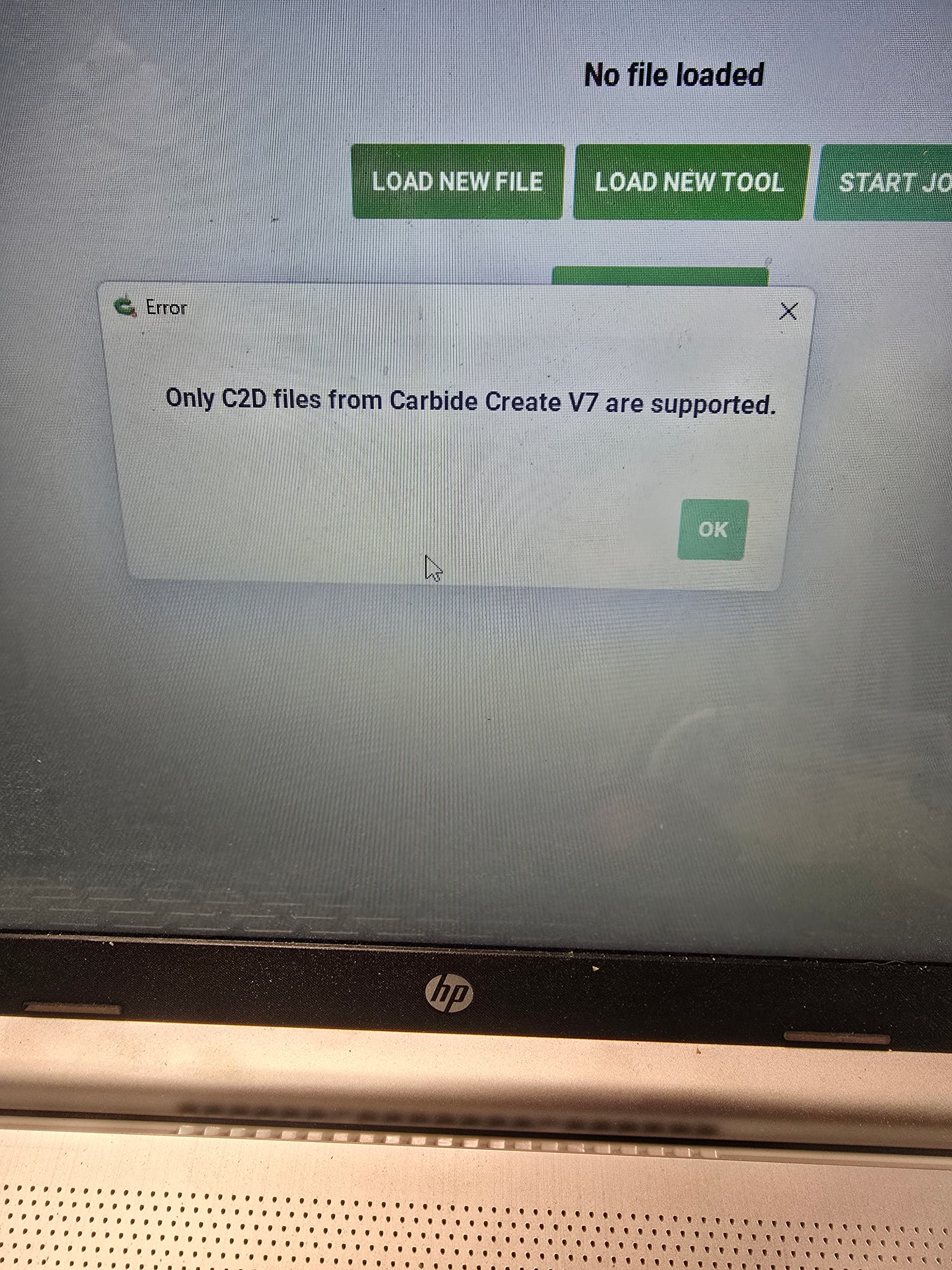

I am trying to run my 1st 3d file today and this is what I get when I try it. Any suggestions?

If you have Carbide Create v6, write out a G-code file.
See:
https://carbide3d.com/blog/carbide-create-v7/

What version of Carbide Create was used to make the file?
Was the file saved as a v7 file, or a v6 file?
Upload it here?
