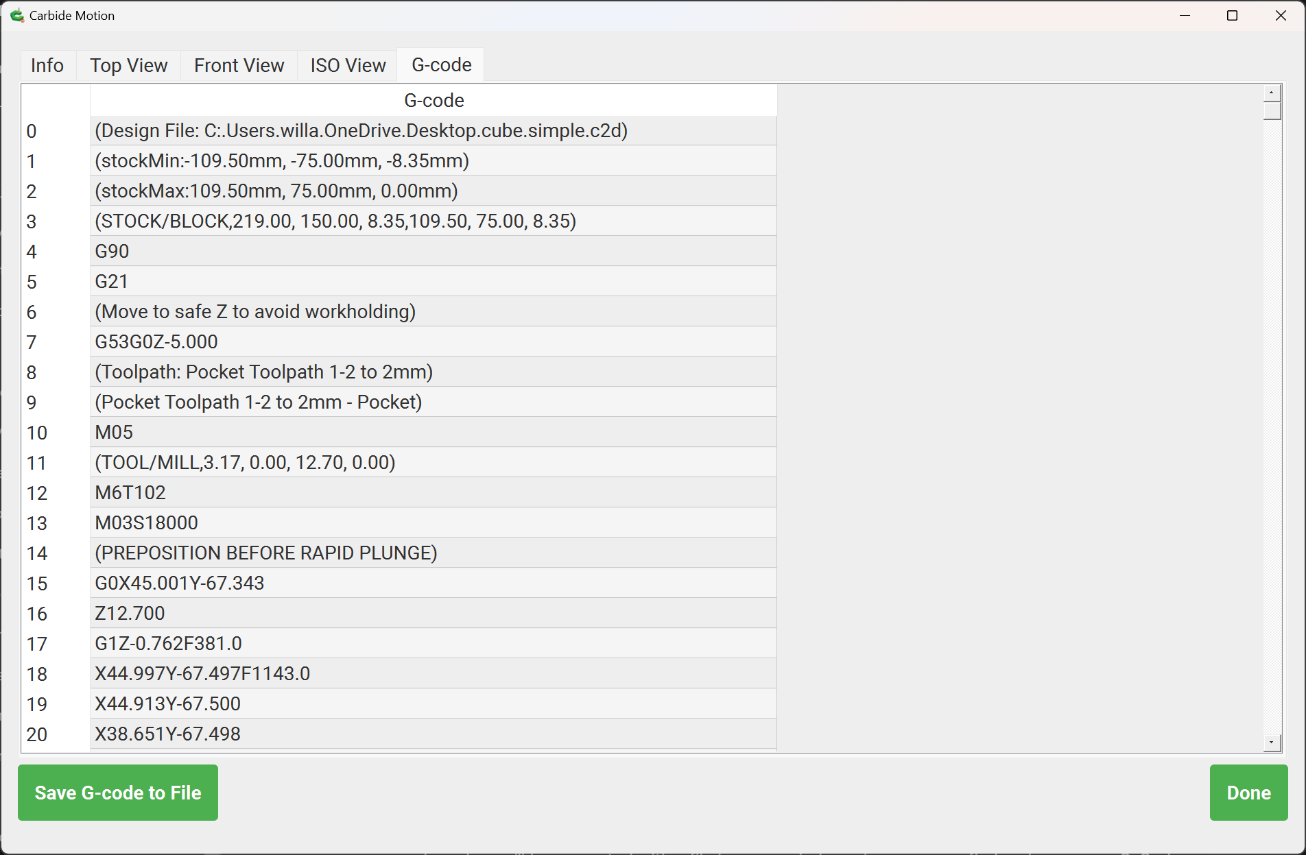

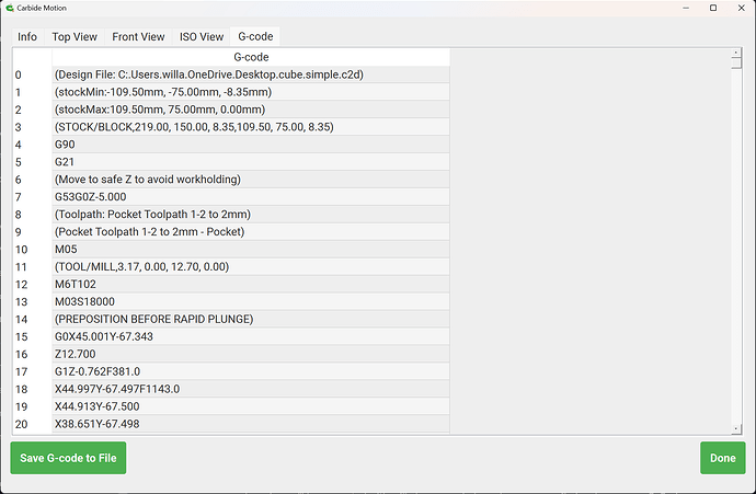

Thanks Will, I use Carbide Create Build 815 to create my content and in the case of today call it up in Motion. Is there a “window” or drop down in either of the 2 softwares where I could edit the g-code? If its really easy I’d be open to learning but all the same I can re-load Motion Build 622 just the same. tnx.
You would need a Carbide Create Pro license:
and then to modify a custom post-processor:
https://carbide3d.com/hub/faq/create-pro-custom-post-processor/
then, each time you wished to do this, write out G-code and send that file rather than a .c2d
Or, load a .c2d file into Carbide Motion, then use the option to write out G-code:
edit the G-code in a text editor, then save it, then re-load the modified G-code file.
