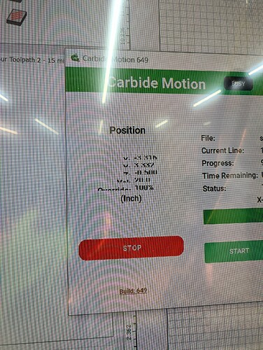

Does anyone have this issue with 649? The position settings are cut off unless I run the window in fullscreen. Was wondering if it were just me or does someone else sees it too. Im running windows 11 for what it is worth.orry about the reflection…
What is your effective screen resolution set to?
I’m able to run it in a pretty small window, but I reduced my screen scaling from the suggested default.
It is set on 1920 by 1080. The setting above it where windows allows you to adjust the screen for text size and so forth is at the recommended setting of 125 percent. I changed it to 100 percent and it was better. I changed it back to 125 percent and it fixed itself. Im guessing maybe bug in windows? Either way, it is working now…go figure.All other text was fine it just seemed to be the position area.
Screen scaling in windows is quite odd.
The System Requirements are 1280 x 1024.
At 125%, I suspect that the effective resolution is at or just below the System Requirements on a device w/ 1920 x 1080 physical pixels for vertical.
Yep…it is beyond me. It is a 65 inch Samsung flat screen. It is nice for old eyes. I was running it at windows recommended settings. I just thought that it was funny that I did not have the issue with the last version of carbide motion. All is good now…thanks Will…
