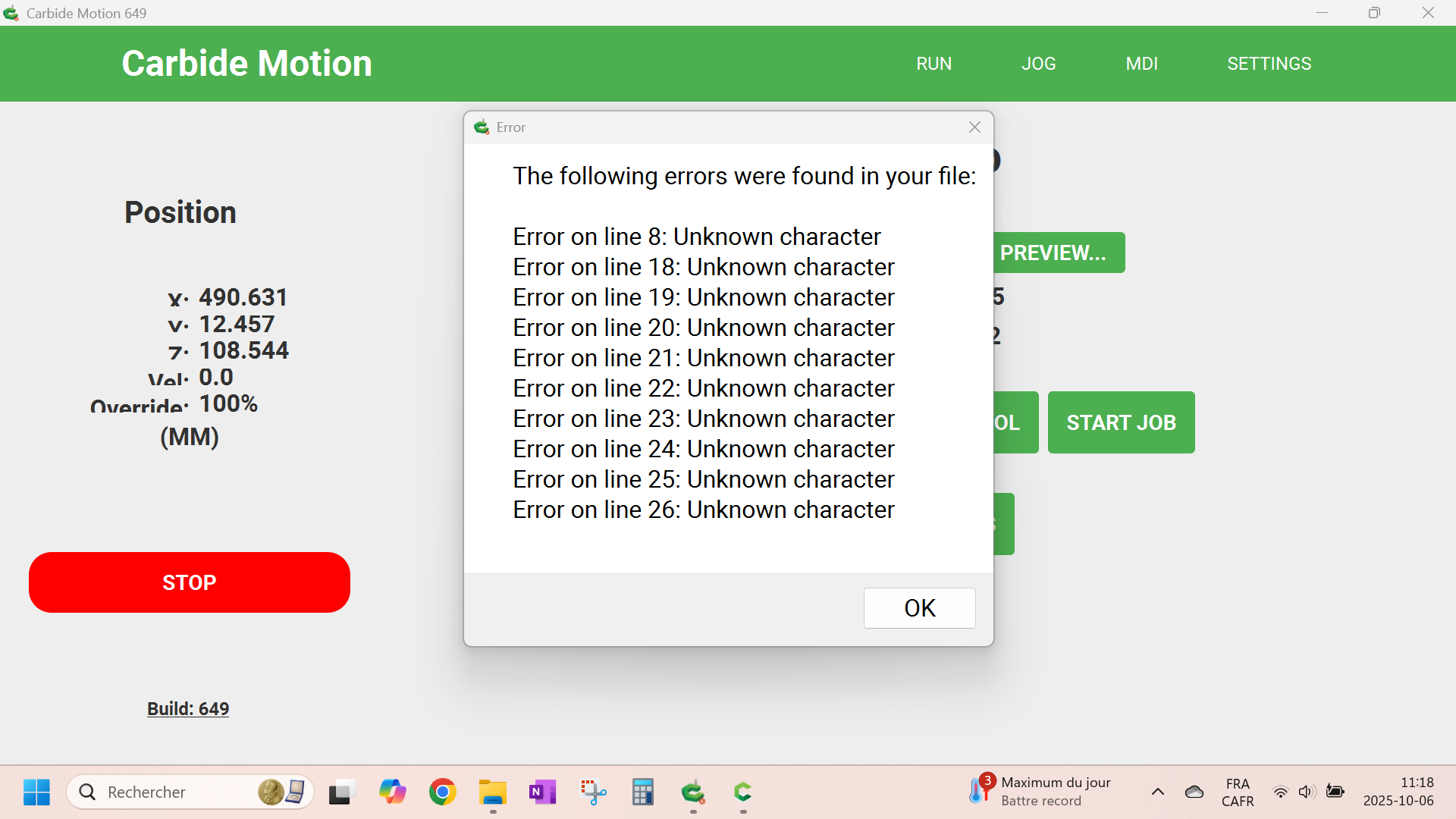

Carbide motion crash on CC 831 file
Here is the CC file and image of error message.
If I open the CC file in version 815 in motion 649, no problem
If I open the same file in CC, change nothing but resave it, it crash

Ok, I found it.
The word “Commas” guide me in the right direction.
I am in Quebec Canada. We speak french overhere. The Regional setup on my computer change the Decimal from “.” to “,”. I put it back to “.”, close and reopen everything and now its working.
I did not try the 832 version since it solve my problem and that I prefer to deal with decimal with the “.”.
Thank for the guidance.
Ah once again internationalization strikes again. CC and CM are written for US English. People outside the US have your kind of problems because their localization is not compatible with US English symbols. The good news is you found the problem.
