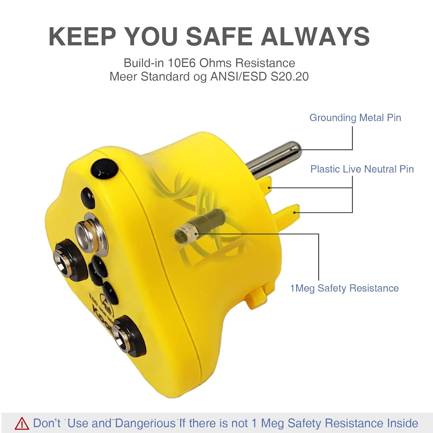

Don’t know what Brandon recommended, one oft the team once recommended to ground every single piece properly. Solved some issues for me. Nice side effect: don’t need the 2nd wire for the bitzero any more, (although C3D does not recommend to use the bitzero w/o the 2nd wire.)
Check how to do, there are some recommendations in the World Library, also C3D will help very nicely, bring all metal parts together to one point, and connect that point to ground over a 1MOhm resistor, there are special grounding plugs for the power outlet ground
what I think I needed because I do not know in my 80yo house what pipe is really grounded and what is not.
The 1MOhm is needed IMO to avoid current spikes for grounding voltage spikes from induction or static electricity, what again would cause some magnetic field inducting a voltage in certain circuits.
However: works fine in my shop.
