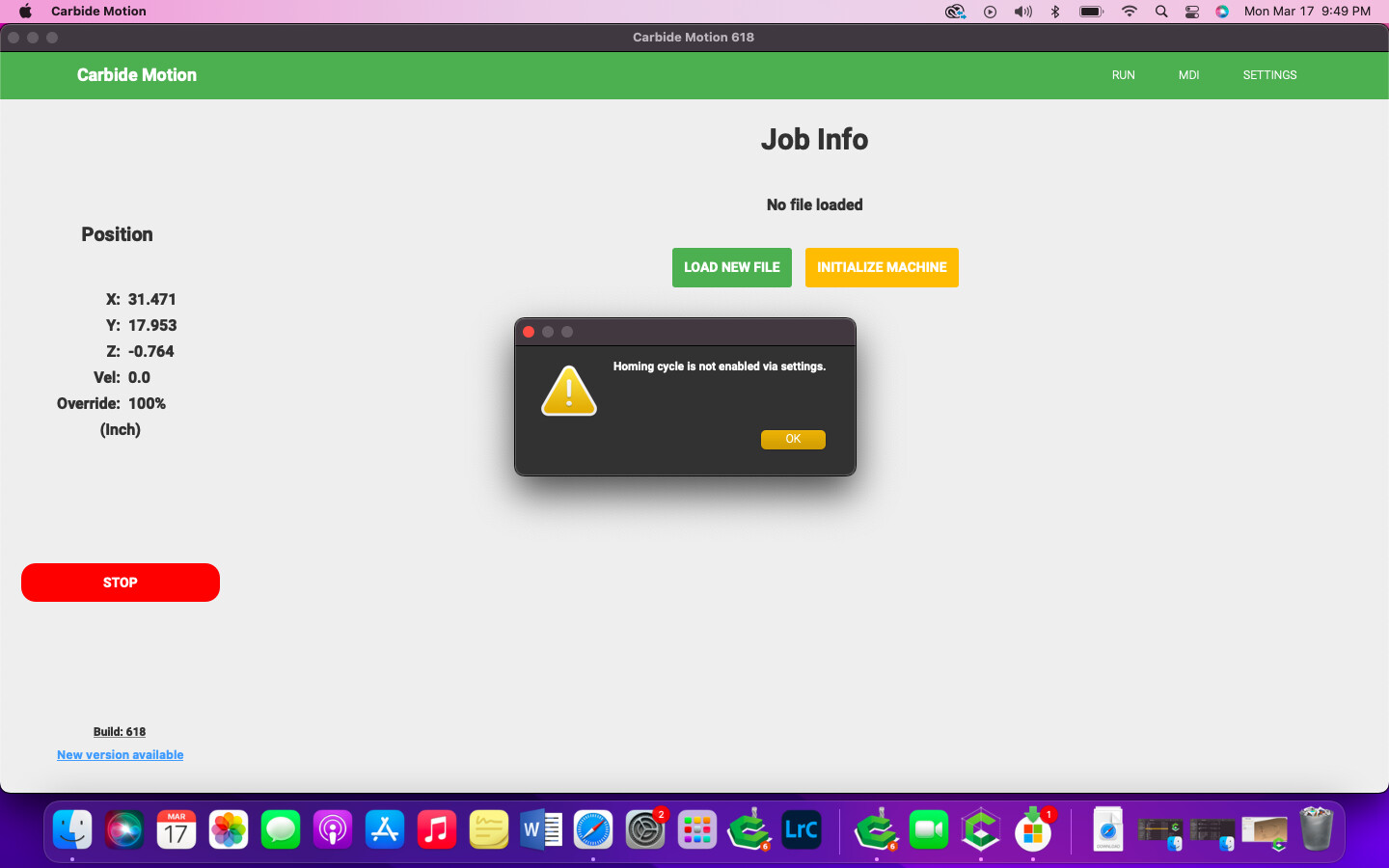

“Homing cycle is not enable via settings.”
Anyone know how to fix this? I’m not seeing anything in the settings about the homing cycle.
OK, step back a bit.
What kind of machine?
Is it new to you? If so, have you completed the setup wizard?
Did your setup work as expected previous to this? If so, has anything (hardware or software) changed?
Please start by re-sending the configuration:
If that doesn’t work, post a photo of your setup and let us know the specifics.
Thanks for the reply’s. It is not a new machine, I’ve had it for 1.5 years with no problems. I just used it last week with no problem. Nothing has changed with the hardware of software. I’ll resend the configuration and see if that fixes it.
Re-sending the configuration fixed the problem. Thanks!
