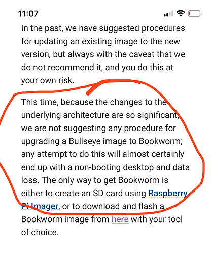

Did you upgrade or do a fresh install.
I saw this comment on one of the raspberry PI pages.
I re-imaged the SD card… I’ve never had good experience trying to upgrade the Rpi OS from one major release to another.
