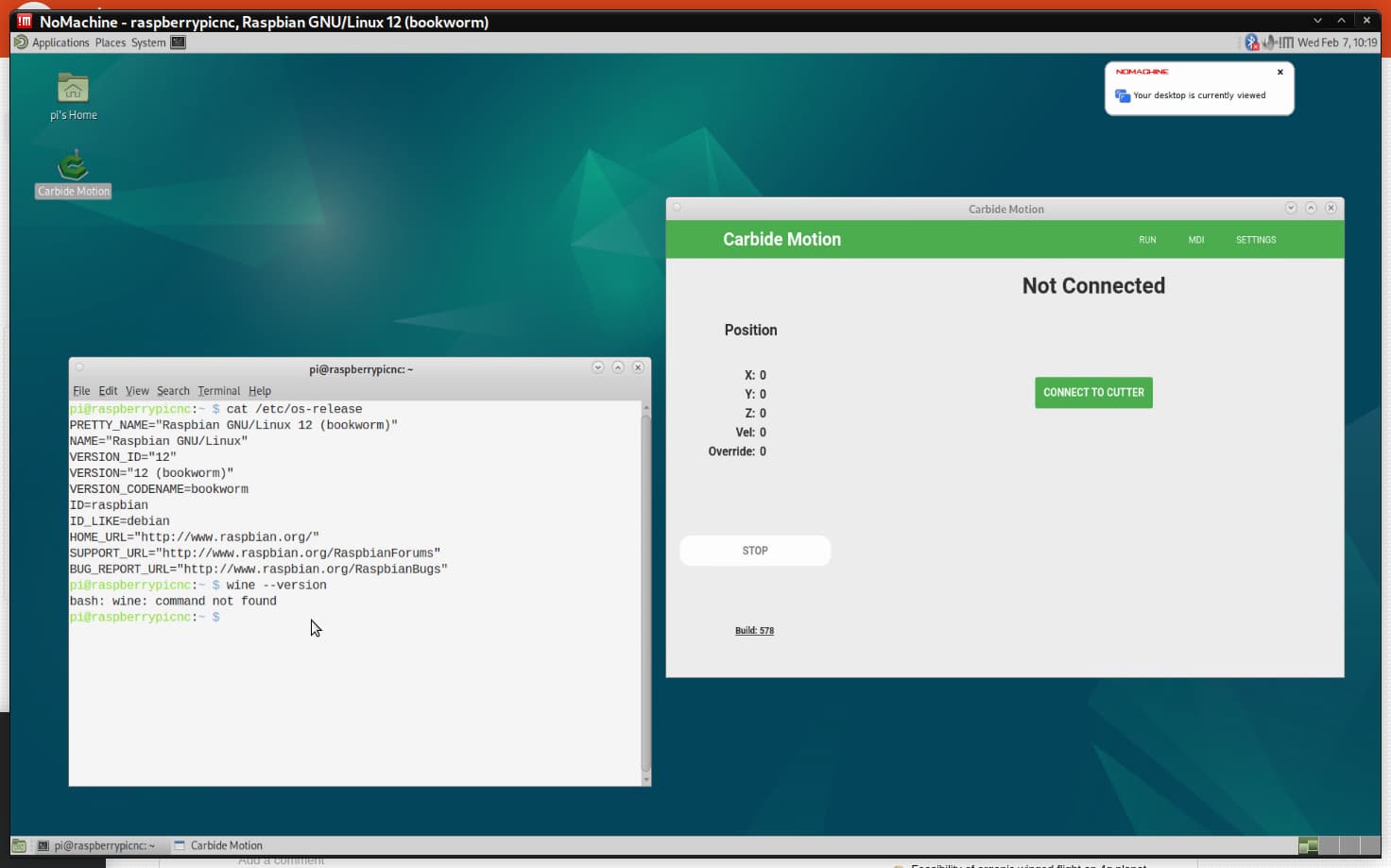

Seems fine with mine, running Debian.
Are you using Wine for CM?
Nope, no Wine on that computer. I just installed the raspi deb file for CM. :man_shrugging:
So what hardware is that running on? You seem to be suggesting that you’re running an ARM coded application on an x86 system without any emulation layer - which doesn’t seem to make any sense.
It’s running on a raspberry pi 4, using the Debian build for Raspberry devices.

Yeah that is why people are confused. The devise Jeff Geerling is comparing a Pi to in that video is has an x86 processor. You cannot just run the .deb package for the pi in an x86.
Maybe I wasn’t clear earlier. I’d expect someone to install the version of linux that matches their instruction set. You can run a .deb on an x86 if you have the proper version of linux.
Correct, but Carbide3D only has an arm version of Carbide Motion in .deb form. There is no x86 .deb for it.
Ah, that makes more sense. Now I see what ppl are getting at. CC runs so well on my other computer that I forget it’s running through POL.
