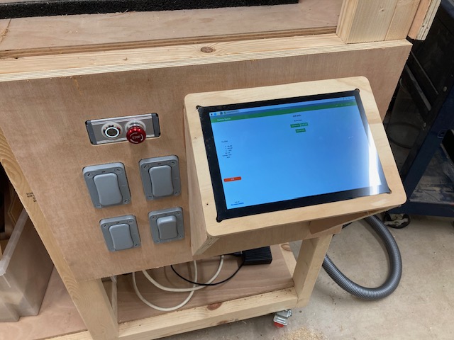

Thanks for asking @robgrz my reason for going with a Pi is that I can create a well-integrated screen that is close and convenient for controlling the machine. The fact it is Linux is just a side effect, but what I really appreciate is the low cost and small form factor you get with a pi. Seeing a guy on youtube build a screen next to his Shapeoko with a Pi was a catalysing factor for me buying and seemed much more elegant than other machines where you have to awkwardly have a laptop nearby.
I wonder if discontinuing the pi and going down a Linux route would add friction for potential buyers who want a simple integrated control and have found the pi as the easiest route to achieve that. Of course you could always add an external screen as an add-on people could buy!
I personally don’t mind having static images of the toolpaths - not the end of the world. I really care about the simple form factor. I only deal with Linux because of the Pi, not because I want Linux per-se.
Here’s my setup for reference :slight_smile:
Obviously just my perspective so do what you think is right :+1:
