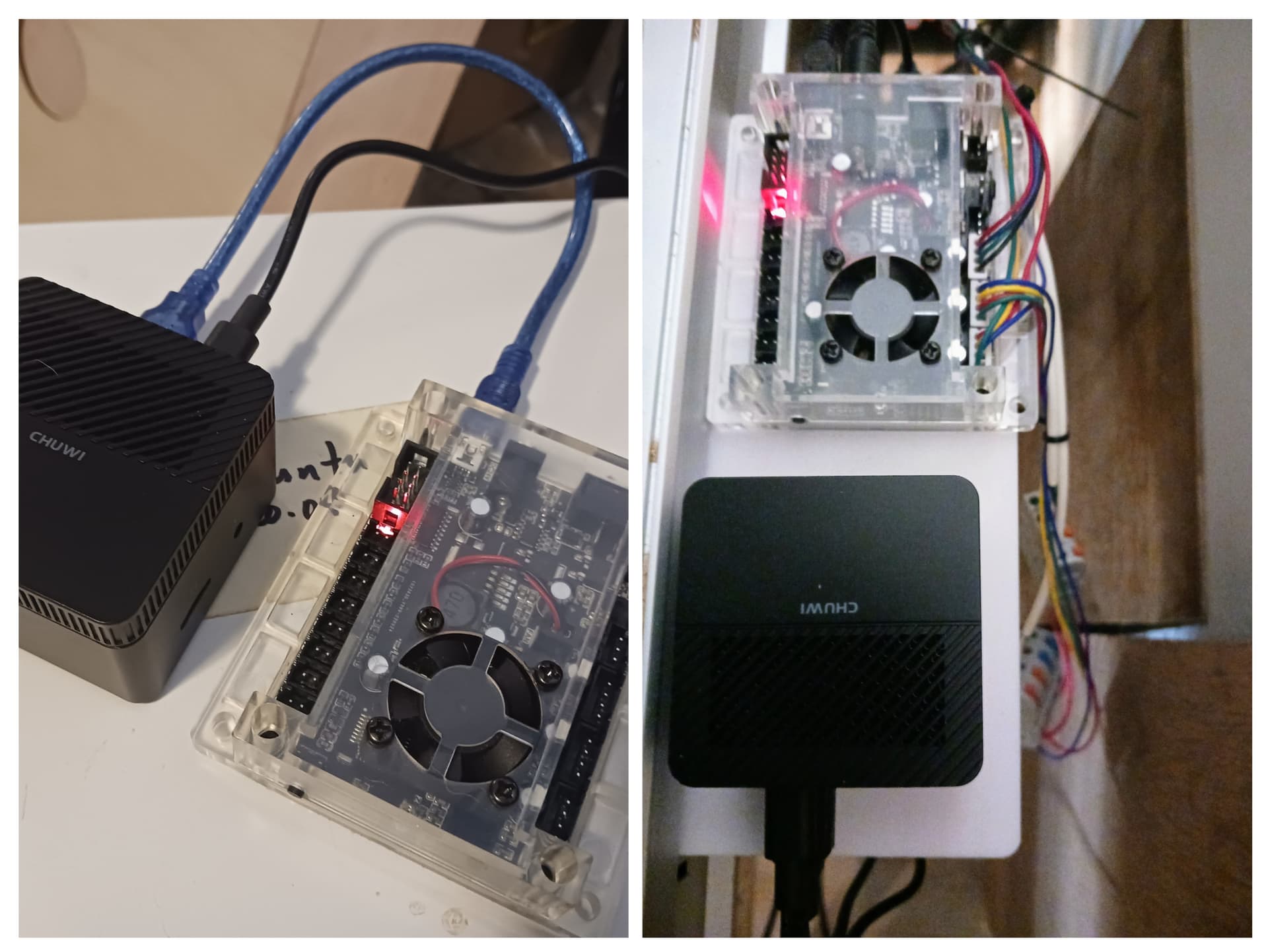

Same here for me… until I discovered miniPC’s. Some are such a small form factor and actually cheaper than a Pi5 with all its attendant accessories… and have sufficient ram and storage for any/all gcode senders or other programs you’ll ever likely need. A “super-Pi” in effect… but without GPIO, which is often not needed.
I purchased several tiny brand new miniPC’s shown for about the same $$$ as a bare Pi5 without its essential accessories. I then blow away the installed OS and install LinuxMiint-DebianEdition (LMDE6/7) and set them up for headless operation through Xrdp over wifi. I add any/all gcode senders and programs (Lightburn, CarbideMotion for Linux?, etc) I use with my various machines… and it’s easily moved between machines if needed. Senders such as gSender and UGS also provide pendant functionality for cellphone. Set up the job remotely, snapshot the QR code with your phone, while still on your good PC… and then just carry the phone into the shop to jog into position and start your jobs.
I love my Pi’s’ but they simply are not as versatile and do not perform as well as even a modest miniPC for USB output to a cnc controller.
