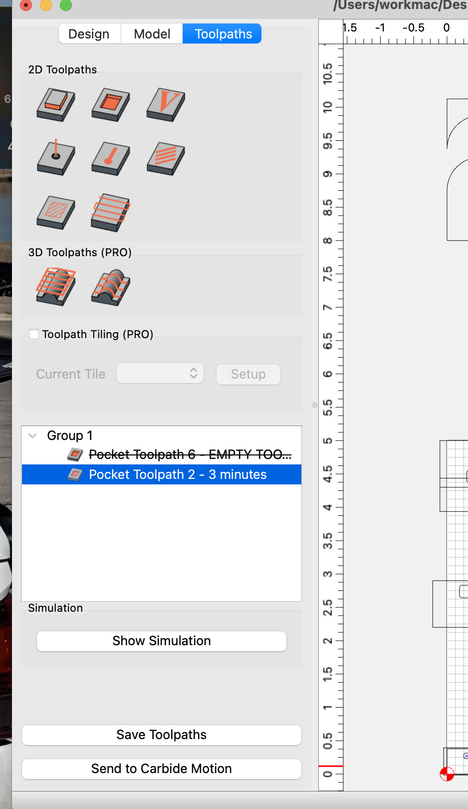

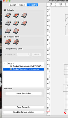

Where is this elusive button? I’ve never seen it before… :thinking:

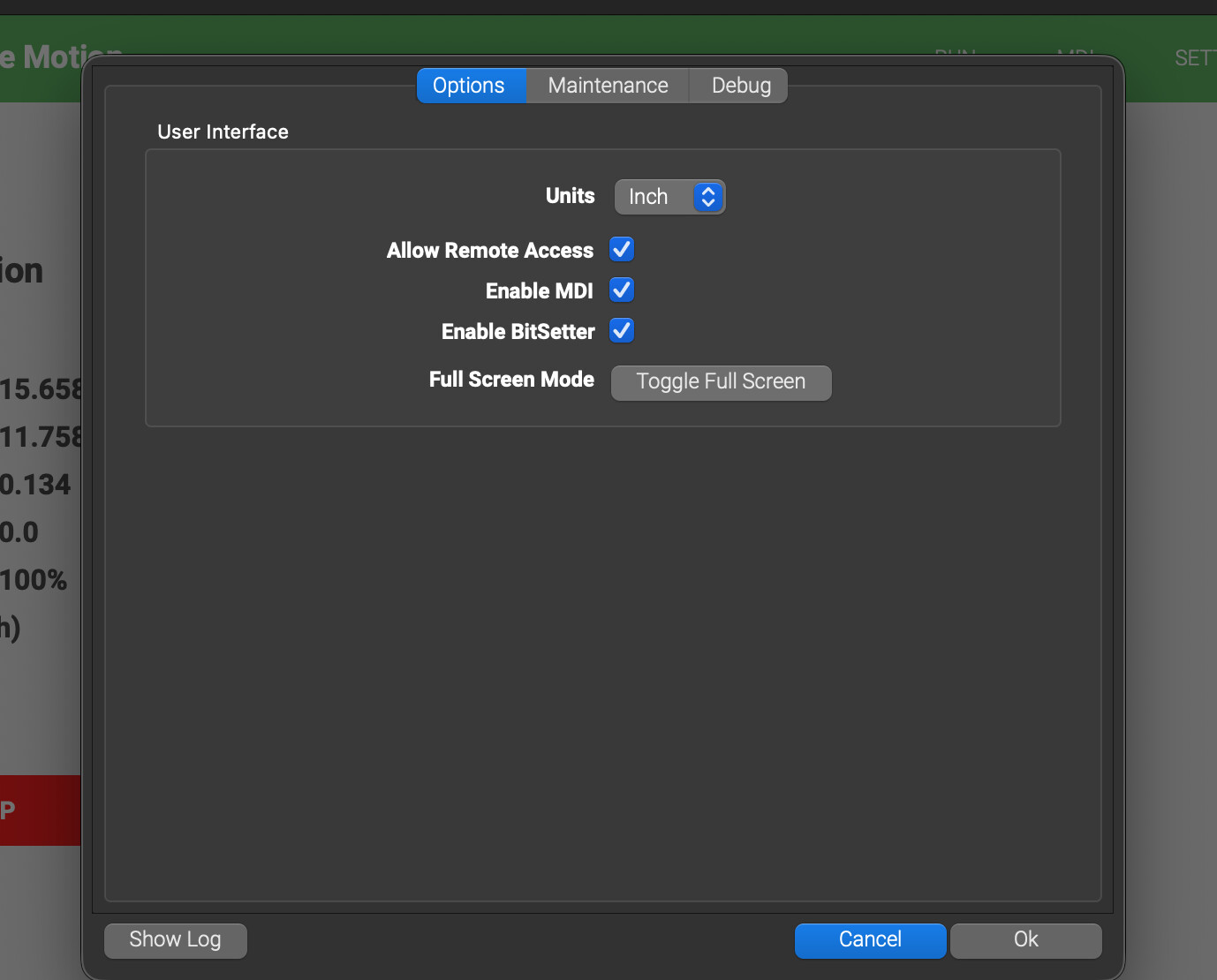

Allow Remote Access must be checked and CM has to be in the Job Info screen.
@Ed.E Thanks! I was re-doing the settings on my machine today and saw the “allow remote access” check box but I never knew what it was related to.

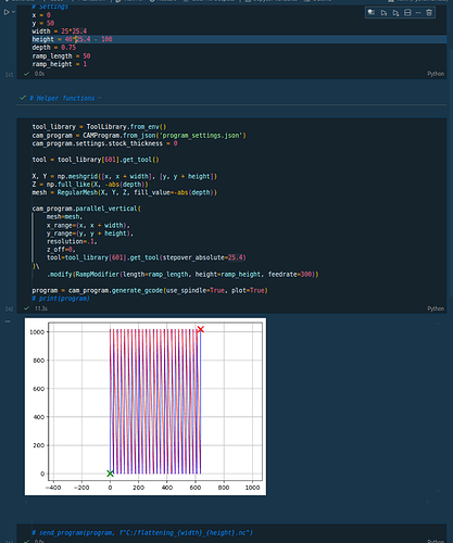

Just to give context of my question. Here’s a Jupyter notebook I use to quickly do flattening operations. I can just automatically transfer files over to the controller PC. I know it’s a little strange, but I like doing things this way :slight_smile:
