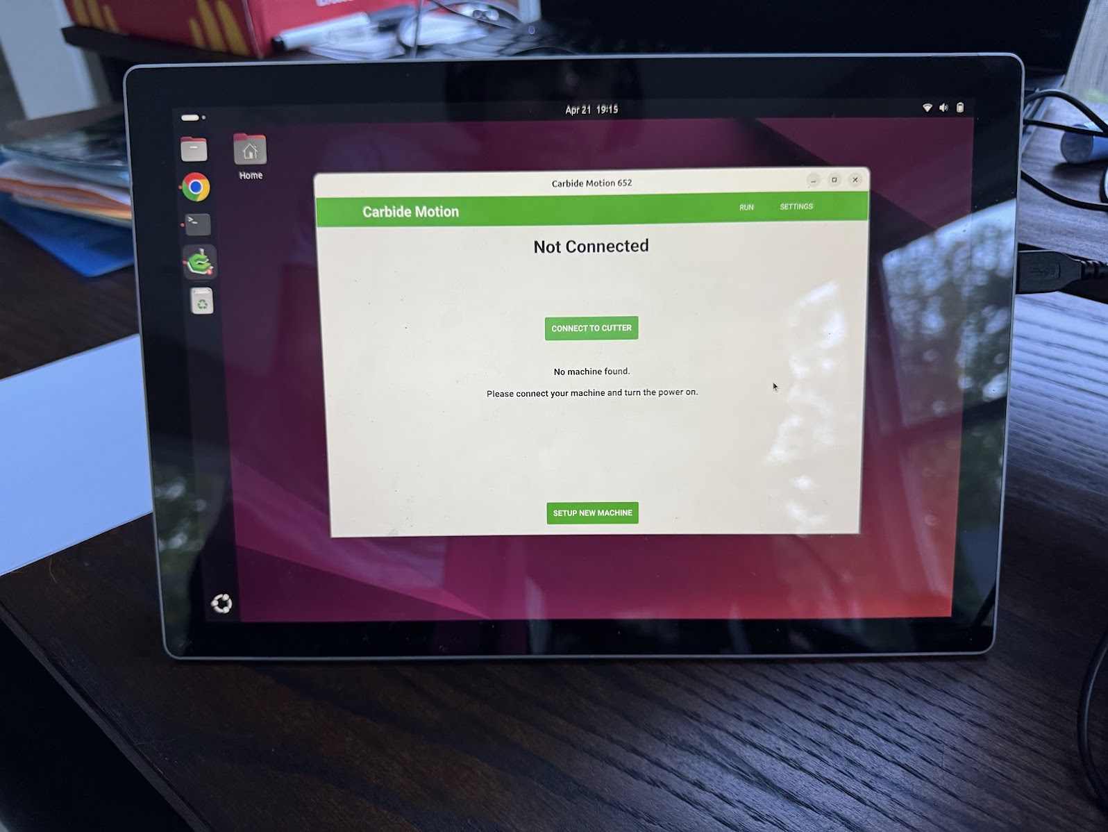

Sorry I was late to the party… I got it installed on my surface running Ubuntu.

I got it loaded and running on the gControl Panel computer I bought after setting up a dual boot option with Linux Mint. I haven’t tried it yet. I will wait until the 5.1Pro is set up.
I am running CM on Kubuntu (from a USB attached Seagate Backup drive) on an older MacBook Pro that no longer gets MacOS updates. I have run multiple hours worth of cutting and have had no issues or disconnects. Very satisfied with this setup.
I was able to setup Linux Mint on my old Surface 3 and run it on that. Very nice use for a device that was bound for the garbage otherwise.

Is there an updated flatpak for Motion? When I run flatpak update. I get three EOL warnings. I’ve also had problems getting my new pendant to talk to the app.
Alternatively, I’ve been successfully running Create Pro natively with Wine on both my shop’s Ubuntu-based Mint Linux computer and my office’s Arch-based ChachyOS computer. I can’t get Motion to talk to Shapeoko 5 when running on Wine, though. Anyone have any tips?
