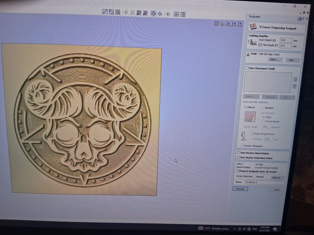

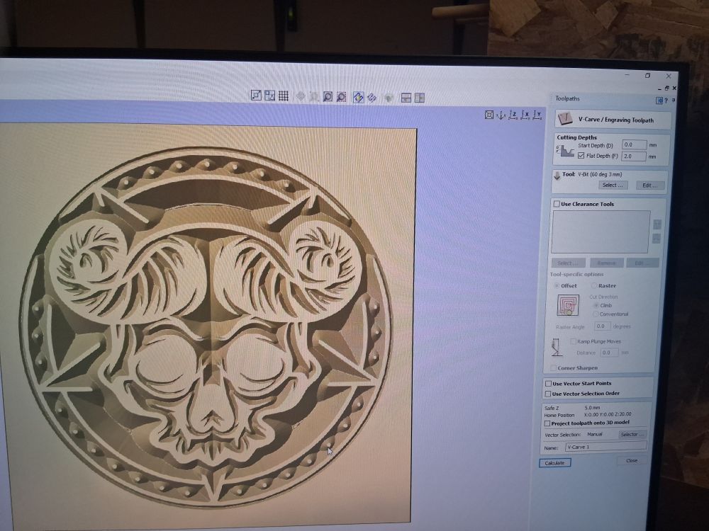

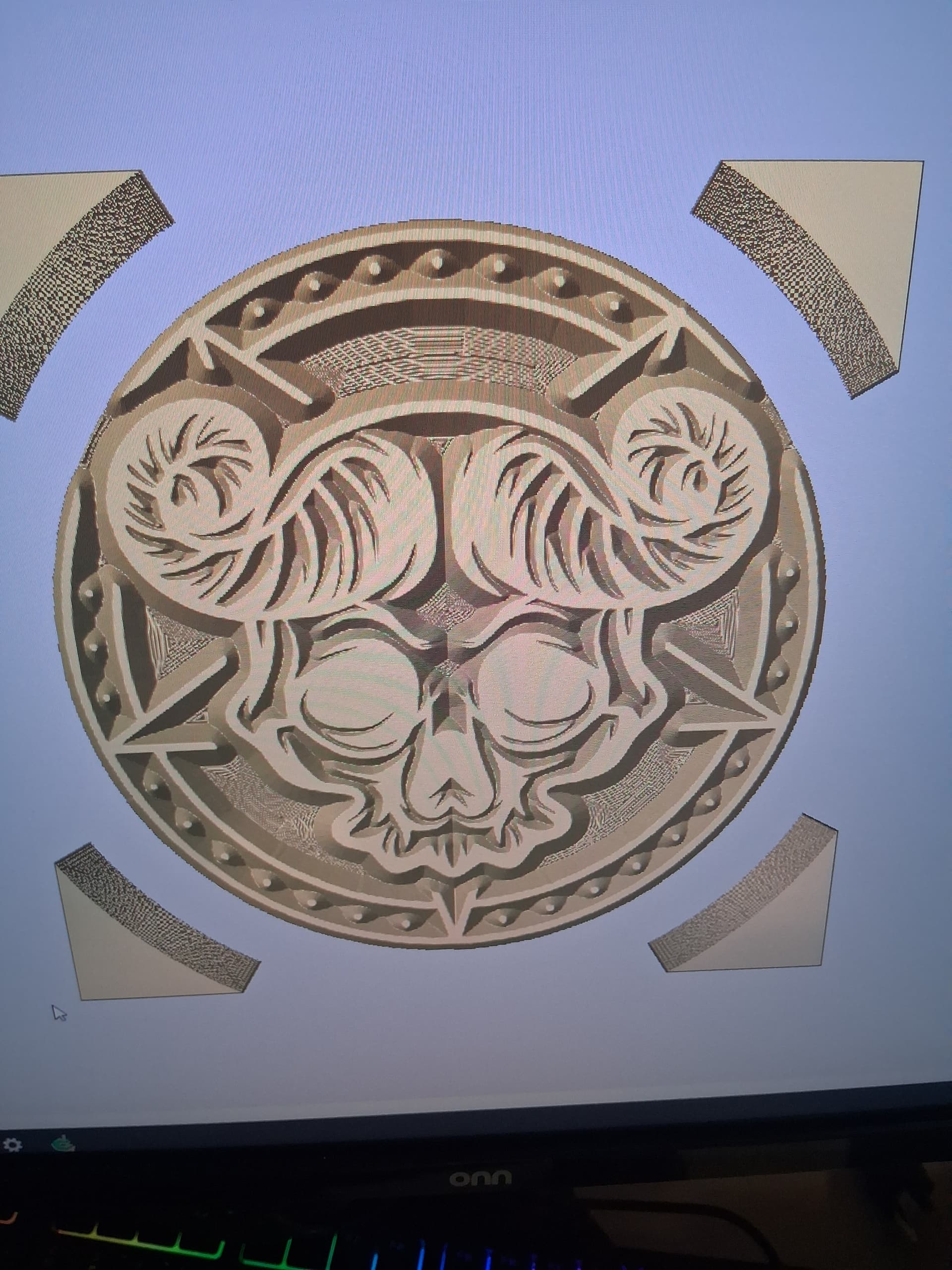

I do Engrave logos on brass. Have in fact been doing it for 7 years in South Africa. I moved to Spokane Washington 2 months ago and bought a Shapoko 5 pro 4 x 4. I do my cad in aspire and export my g code for cutting on the cnc. My preview is actactly what I want in Carbide motion but the result is not the same as the preview? Anybody else hade these problems before. I prevouisly used a CNC i build myse;lf with Mach 3 and I also usaed a comercial machine and never had this spesific issue. I always got what the preview show I would get!
Does the CM preview match the Aspire simulation?
Do the tools being used exactly match the tools programmed?
I.e. No chipped points on V tools, Tapered ball mills not cutting deeper than the radius of the ball?
Pictures of the preview & actual cut might help??
Yes it does axactly.

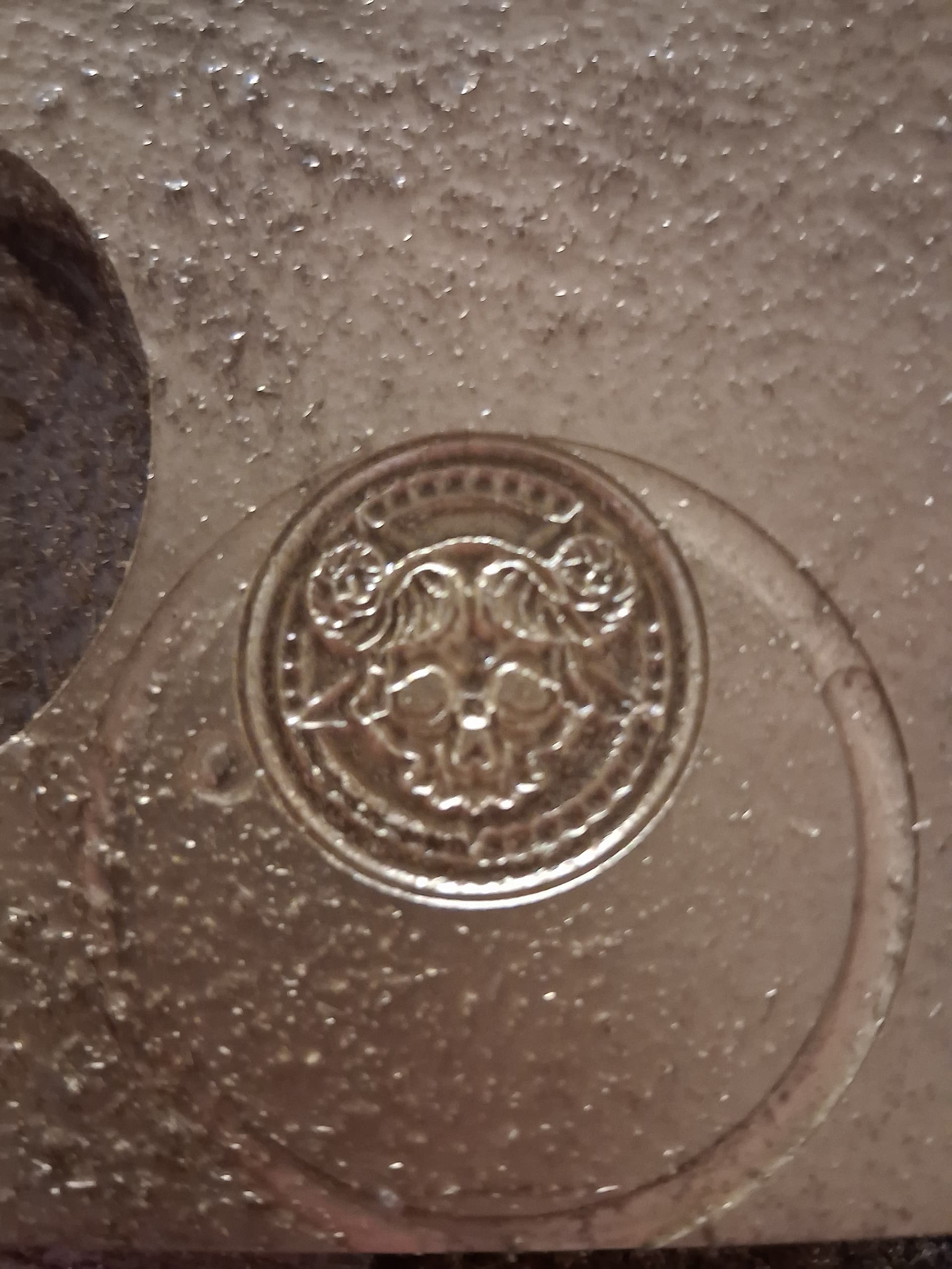

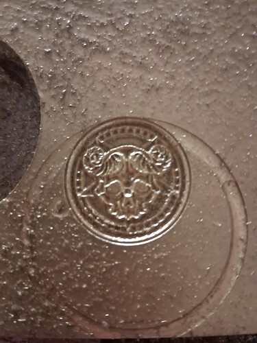

But this is the result I get.
Clearly not the same as both previews.
Blurry pic, but it kinda looks like it cut too deep, and maybe some of the brass is deformed rather than cut?? The same basic shape is there, but it just lacks the detail in the preview.
So I’m thinking maybe a bad Z zero, or a dull or damaged cutter???
I could verify the Vectric Aspire file for you, but it doesn’t appear to need verification. This is (in my opinion) a mechanical / cutter / damaged or wrong size tool issue, possibly exactly as Tod1d said. I would verify that the same tool as you designed it for was inserted in your collet, and if so, carefully examine that tool.

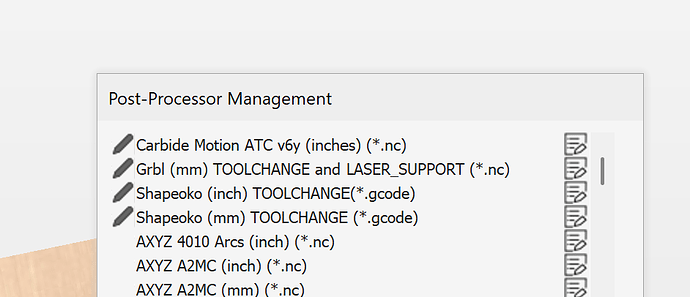

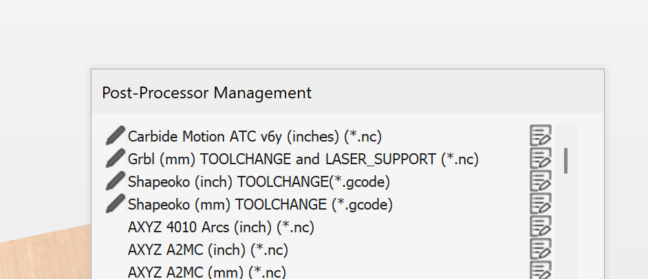

What is the post processor needed to use for Carbide Motion?

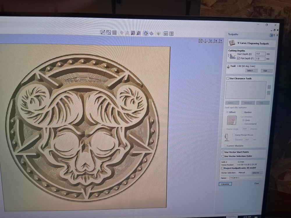

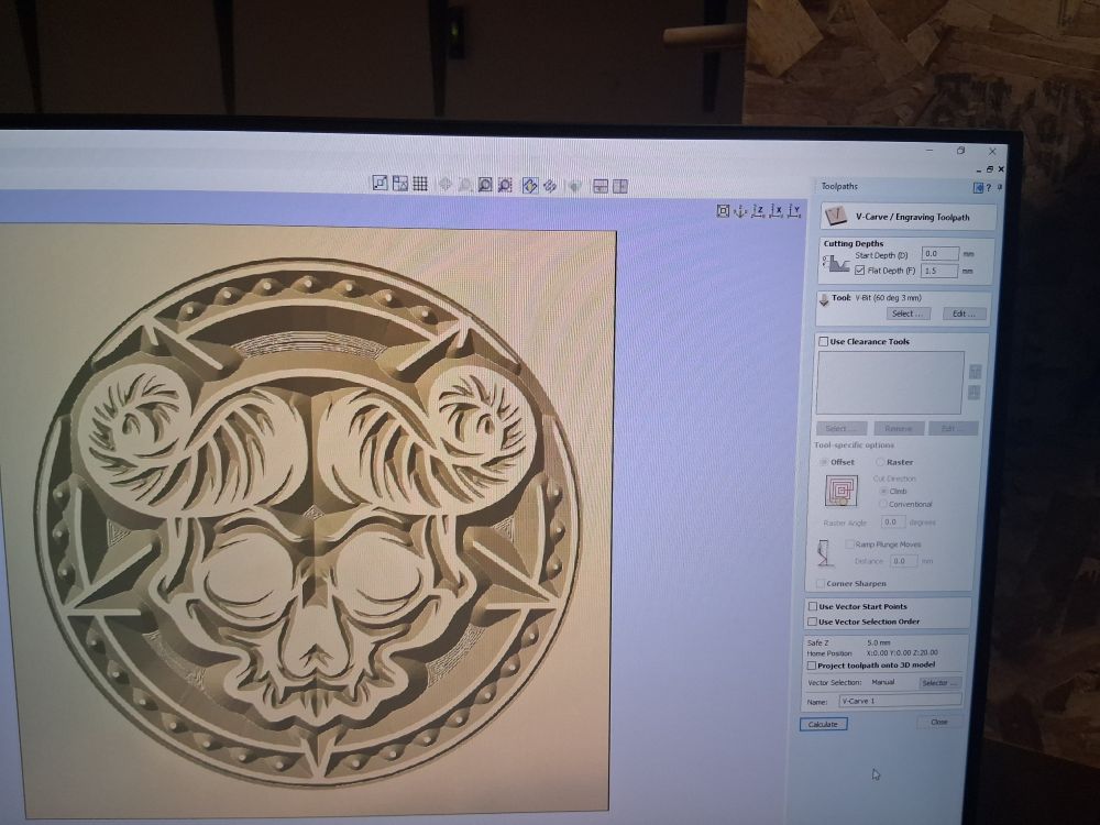

Here are a couple of different depth file previews I made in ve carve.
I have always been able to get exactly what Vcarve previews show me.
Not this time.
Here is a few previews I made

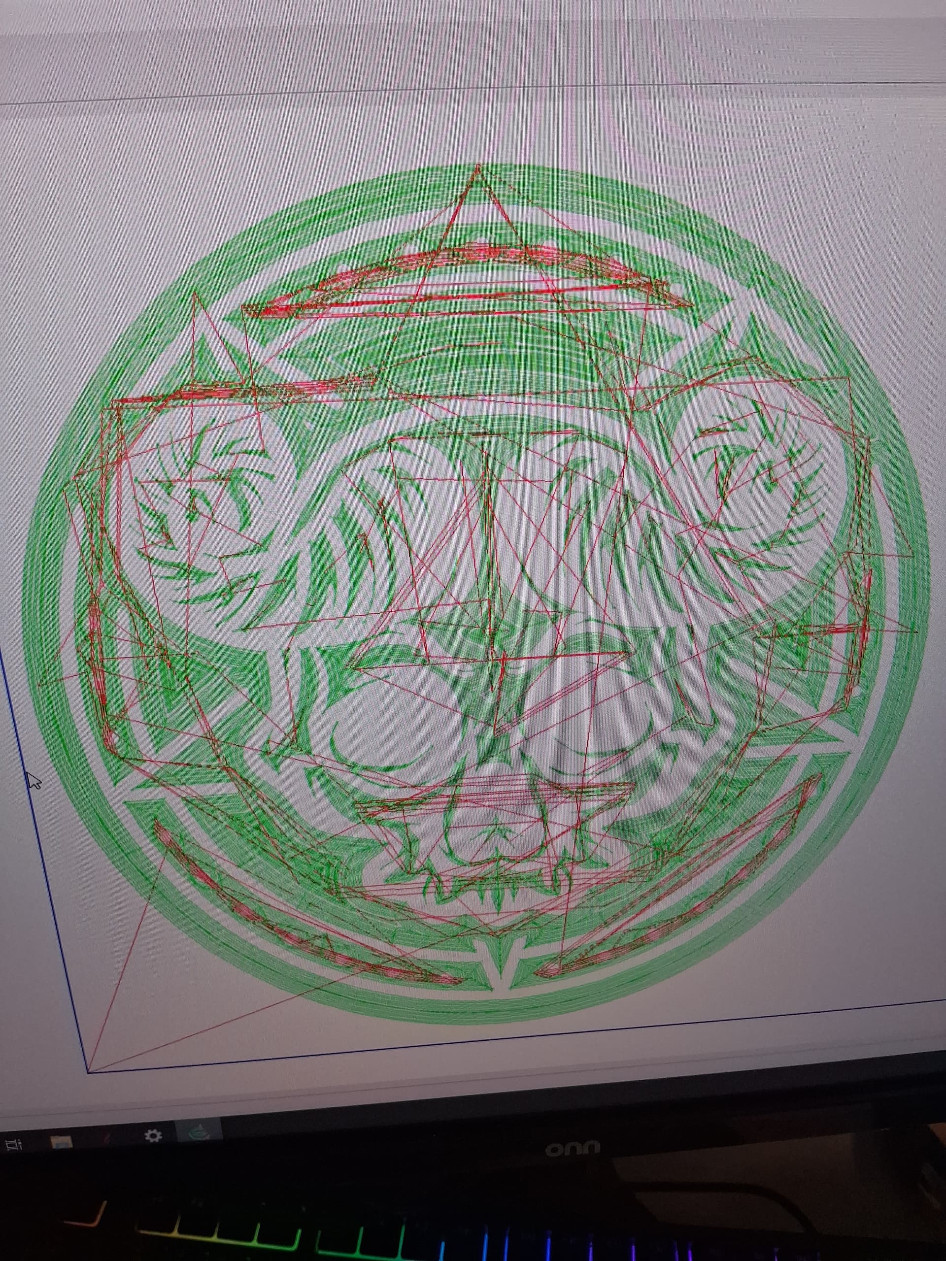

Carbide Motion doesn’t determine the depth. It only cuts the G-code you send to it.
Note that this cutting is relative to the depth which you have set.
I would recommend setting up a basic and simple test file which includes facing off the material as an early process, then making all the toolpaths thereafter relative in depth to that surface — that should allow precise and accurate measurement and repeatable results.

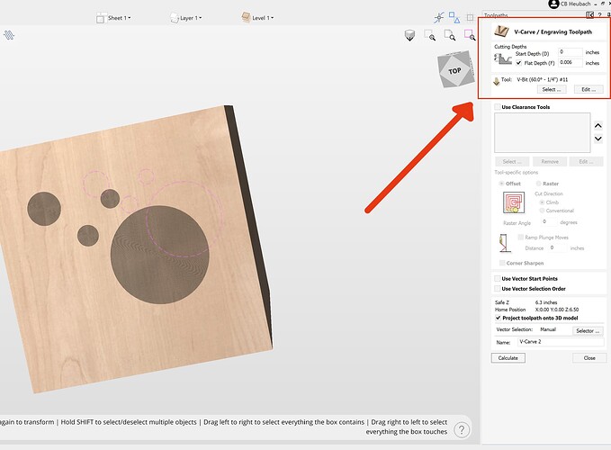

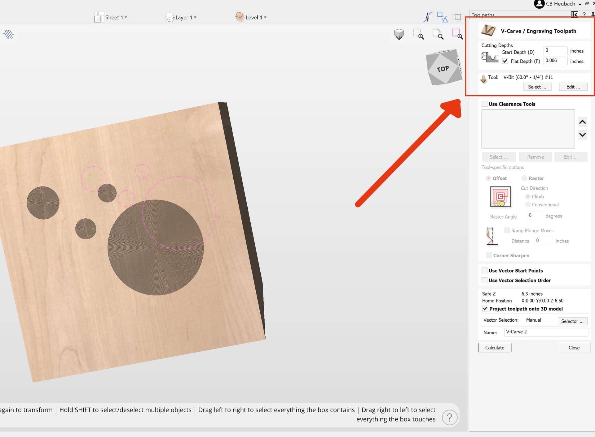

If I didn’t have my flat depth checked, my vbit would go right through the board. If I do have it checked, it will limit my depth to (in this case) .006". It is not Carbide Motion. Also check if your vcarve is set to work with 3d modeling toolpaths. I use Vectric Aspire everyday and I only use Carbide Motion for running my machine. It works perfectly. Y’all have a setting wrong somewhere in Aspire. When I get back I will send the post processors for you.
Obouisly that will happen if you dont spesify a flat depth.
But I am using 10mm thich meterial and only cutting at most 2.5mm deep.
Then it will not cut trough.

What post prosessor are you using?
I haven’t use the v6y but other guys say it works fine. The other three are flawless.
Check your messages. I sent my email address. Return with your aspire file and I will take a look.
If you are using Aspire look for the post processor that @Allen44 has created and posted in this forum.
