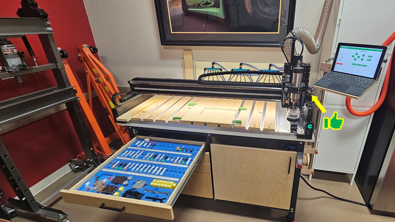

Love the setup. What are the air lines for? Is that a vacuum system?
Thanks David. The air lines and manifolds behind the machine are a failed initial attempt at a vacuum table using a sealed MDF substrate as a cheap bed… didn’t work needless to say. Will be biting the bullet for an aluminum vacuum table instead. I also have air at the spindle for cooling and chip clearing when needed. I sometimes helpful with fine details in HDPE (like sign work).

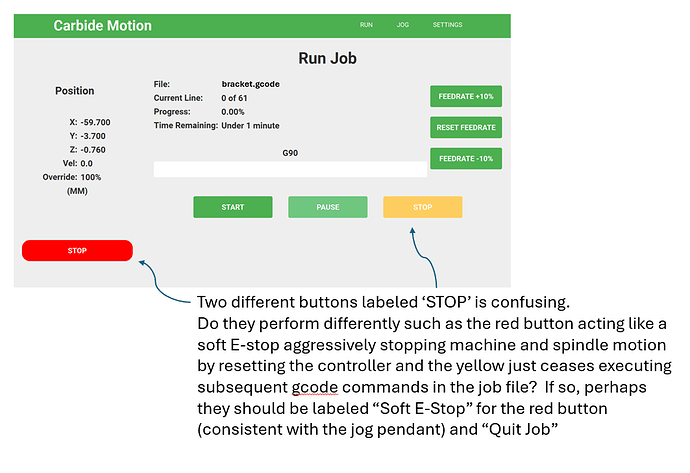

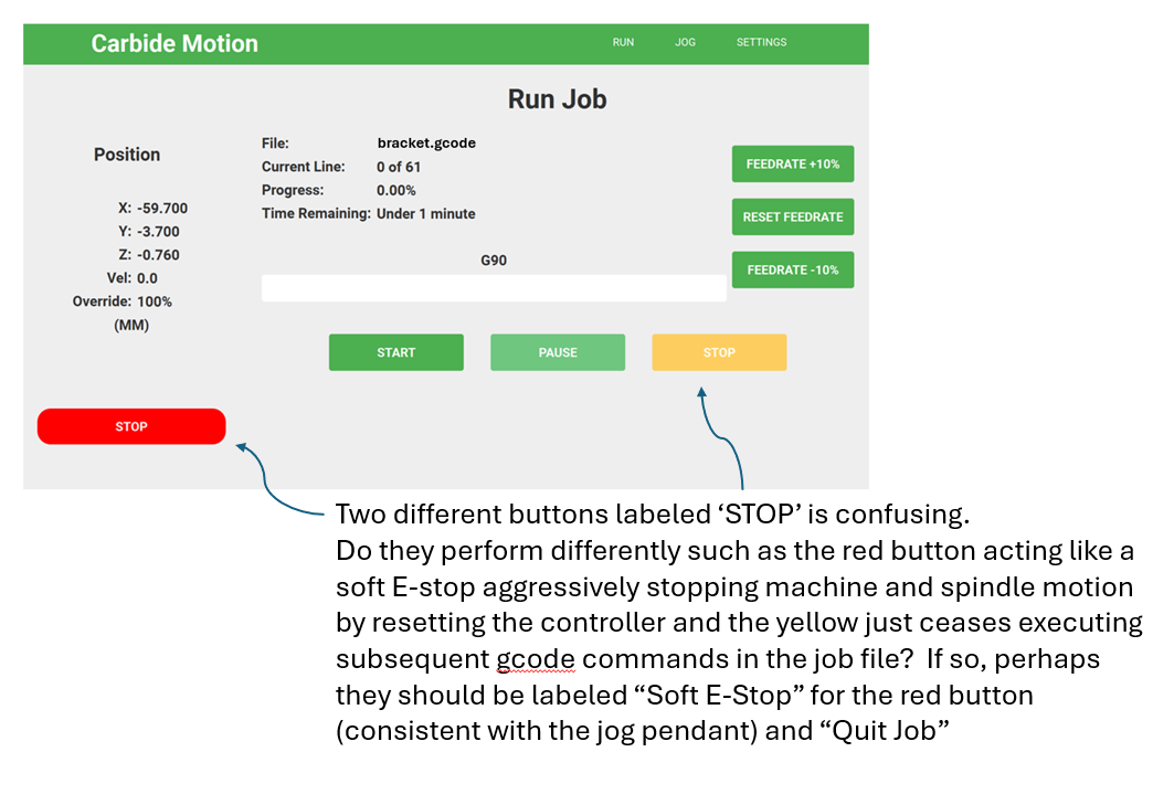

In regards to two buttons on the control panel labeled “stop”. From experience, it is confusing to have two buttons with the same label with different meanings depending on context.
If you’re open to requirements, please consider:
  • “Stop” shall have exactly one definition

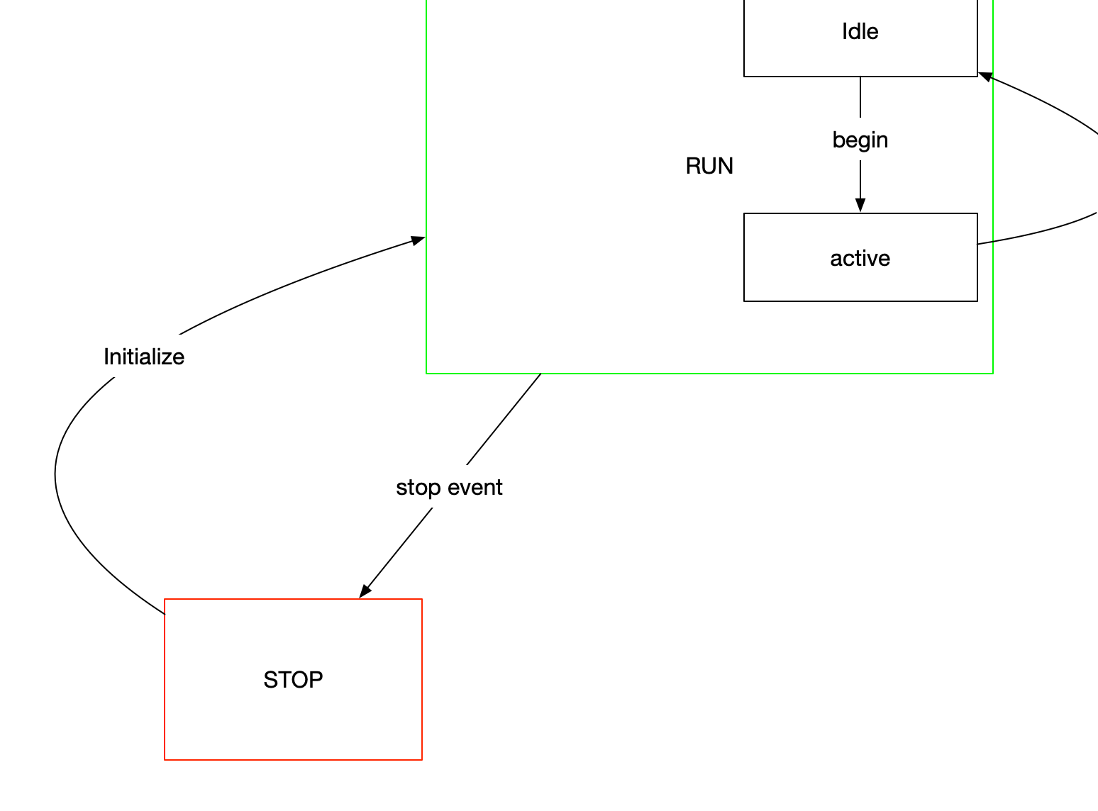

I have encountered this concept before, and think the program behavior aligns well with a RUN/STOP paradigm. Within RUN you have most of the online features occurring for example Begin Program, Pause Program, End Program.
Attaching a simplified diagram. The important part I think is that stop means one thing, it is the state with absolute least activity. Run and Stop are paired. All the activity is within Run, and labeled uniquely.

I’ve always thought it confusing that the CM UI has two buttons labeled STOP.
My suggestion would be to retain both if the functionality is indeed different and clarify their function with the red button being labeled “Soft E-Stop” (assuming it actually issues a USB command to reset the controller) and the yellow button labeled as “Quit Job” (assuming it stops issuing subsequent gcode from the active job and returns to the default CM Run screen).
