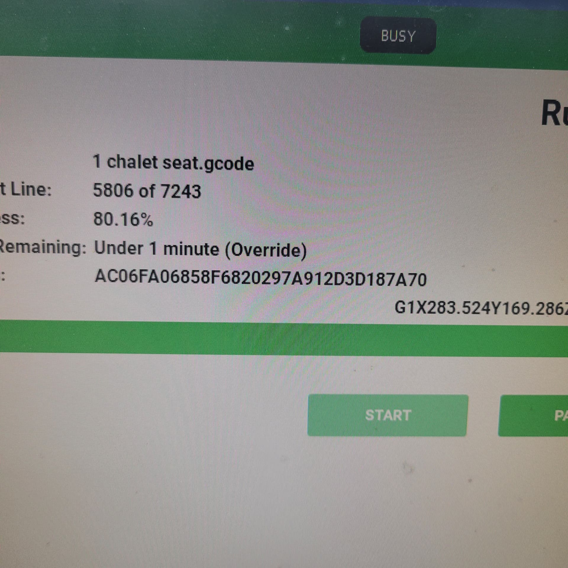

There is a line on the CM UI that, on my machine, reads
Status: AC06FA06858F6820297A912D3D187A70
While this is a fascinating sequence of numbers what do they mean, why are they on the Run screen?

Screen grab of this?
Which version are you using?
Normally that area shows descriptive G-code comments — does that text appear in the G-code?
Interesting!. Why yes it does.
What an odd thing to do. Do I have any options to make this more meaningful?

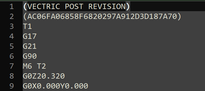

I would guess it is a GUID that represents a version for the Vectric post program.
Or a unique ID for the installation of the software.
I am using Vectric Vcarve Pro and it also adds exactly that same text comment code in the second line of every gcode file I make. So it has something to do with Vcarve’s id stamping. I had asked the same question a week ago and never got any answer.

Hi Ron, so I decided to dig a bit deeper and change Vectric post processors to see what would happen and the string code does change with the different post processor configuration.
So, the string you showed in your screen capture is exactly the same I have as well for the Vectric built-in Post Processor for the Shapeoko Pro XXL Carbide Motion Controller.
That’s my best guess it is an ID stamp for the version of selected Vectric Post Processor. I wonder why they couldn’t have just used the text descriptor instead of the code string which us newbies would have immediately understood.

I did some more checking to answer your Status line question more. Carbide Create adds into the gcode file more comments than what Vectric software does. Carbide Motion looks for the keyword comments from CC and displays them in the Status line in CM.
For example, the word “Toolpath” is a keyword that CM will display. So, CC will add a comment line such as (Toolpath: Contour Toolpath 1) into the gcode and CM will read that and display it on the Status line. Thus that is something the Vectric software does not do that CC and CM does.
Therefore, in my opinion, the Status line for non Carbide Create generated gcode files is pretty useless. For non-CC files it seems CM just displays the second comment line it encounters and that is all, for Vectric files it appears to be the Post Processor file config ID.
