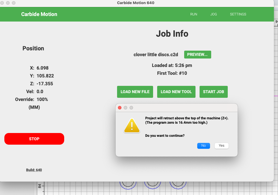

Carbide Motion v640- Need to reset z height every time
Hi All,
I posted about this issue before but didn’t get around to finding a solution.
My Nomad ‘remembers’ its last set position fine until I switch off the machine and turn it back on. I keep getting this error:
I’m attaching a simple file I used to cut a couple of small discs.
Could someone please point me to what’s happening?
Many thanks,
Gunter
clover little discs.c2d (44 KB)
If you run the Load New Tool process when you open Motion the first time, you should be able to run your program without setting the zero again. The new workflow doesn’t make any assumptions about the height of the spindle (and by extension the distance to the Z-origin) until it measures an endmill at least once.
Thank you Winston, I tried this and it worked but I realise I need to do this every time I start carbide motion, not just one time. Is that how it’s meant to be?
Many thanks,
Gunter
So, I’ve found that if I don’t close Carbide Motion and only turn off the machine, when I reconnect I don’t need to do this. So it might be a bug or behavior that can be improved in a future release. But in the mean time, this isn’t really a step backwards, because Carbide Motion used to force you to probe a tool as soon as you initialized the machine. It simply gives you the flexibility to opt to measure it ASAP, or after you set a zero.
