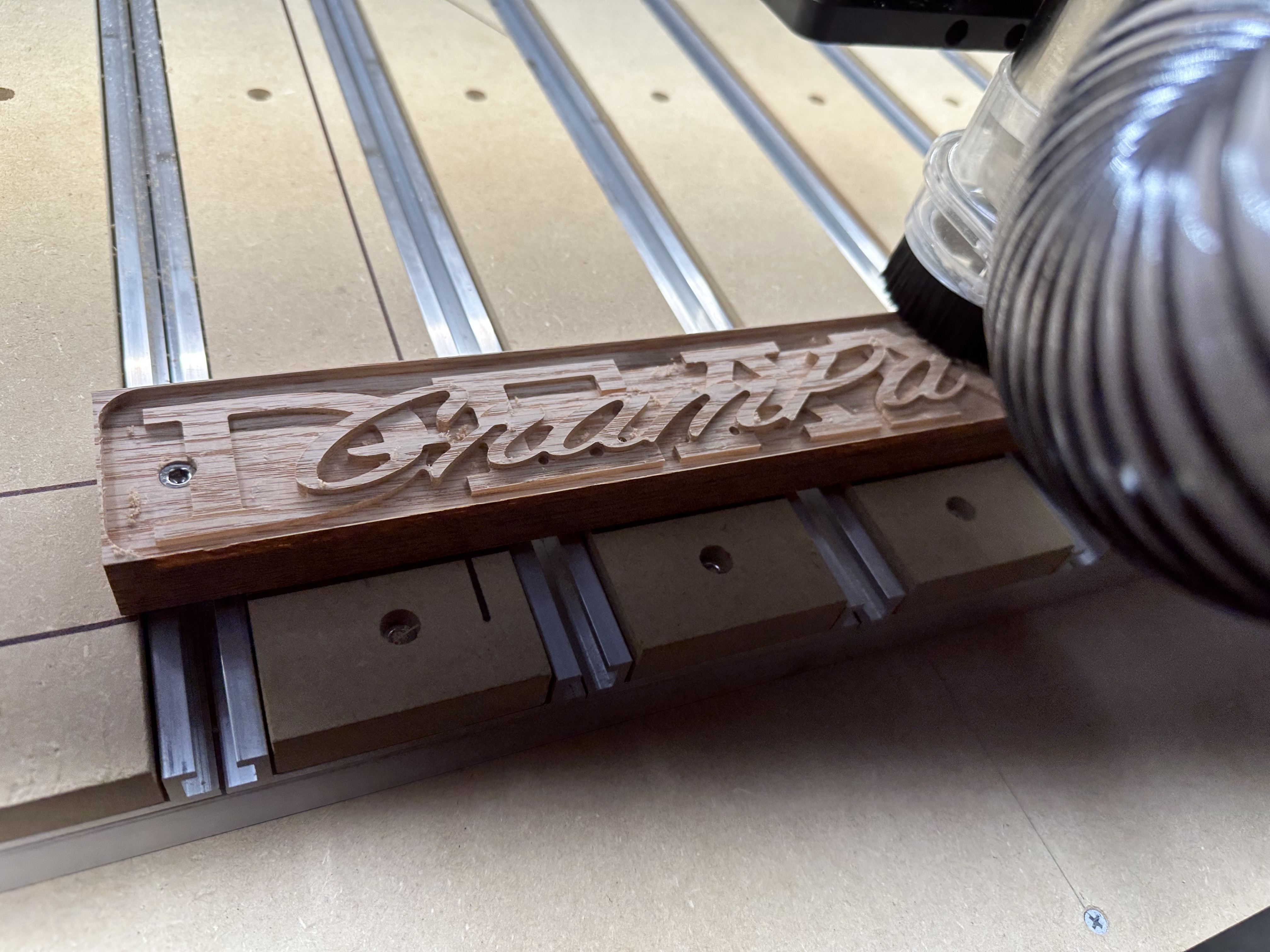

I was able to recover from the semi crash. Enclosed pic is my third cnc project.
