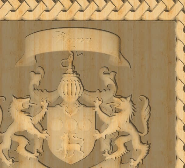

So, for me it is mostly a depth concern. You will notice on this image of a 3d carve from an STL, that the pockets in the neck area of the wolves are different. I’d like to know how deep the pocket areas are so that I can make adjustments with another tool pass.

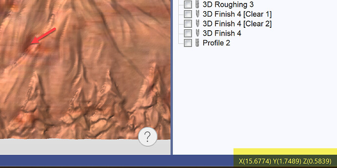

In this screenshot I had my cursor where the red arrow is.
As you move around the coordinate values in the lower right corner are constantly updated.
It does the same thing in the 2D view as well.
Thankyou! It will make it a lot easier to find the correct spot and depth than flipping back and forth with the 2D view.
