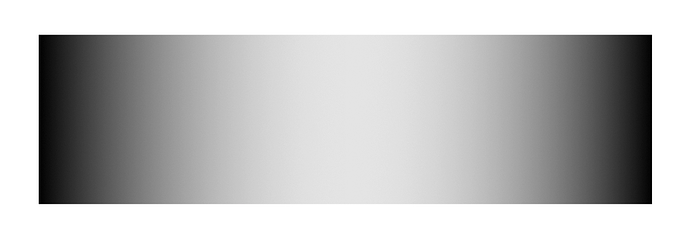

OK, so I make custom sculpted rocking chairs. I would like to carve different things in various locations on a couple of these chairs, primarily the headrest. The headrest has a convex curve of about 20 degrees across its length. How do I convince my CC version 8 pro to do this? Thank you

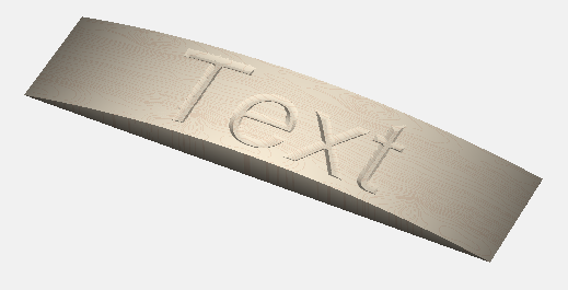

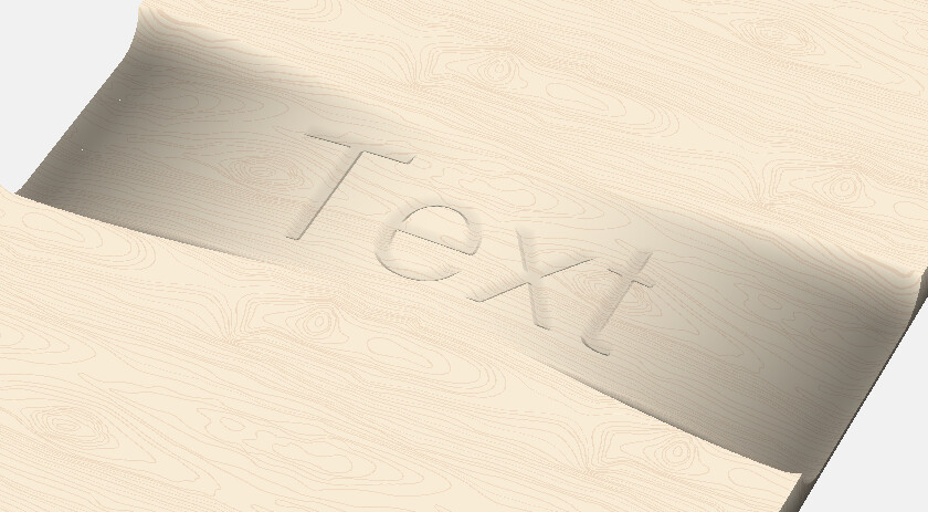

You can do this with two Model objects. I’ve fiddled with this a bit, putting a cameo face on a convex background. Here’s a quick sample of what I’m on about:
The object on top is just a current project of mine, by itself it is straight as if off a lathe. This object is then warped (Added) to a CC built-in shape (‘Round’). Of course that shape should be concave only along the X for you. The built in object is flat most of its width so doesn’t mimic your situation except near the edge.

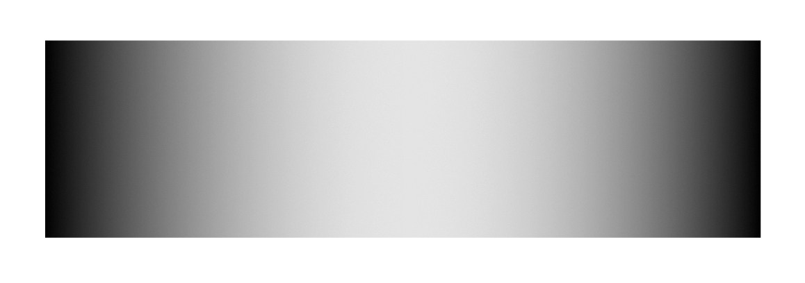

The first step would be to model your curve either as an STL or a depth map. This would be face-on just as you would view the carving and would appear as a gradient left to center to right. Left and right would show the same value, the center would be lighter. Make the Merge type ‘Equal’.
Put your model to be carved on top of this (place below in the Model pane), Merge type ‘Add’ or ’Subtract’.
This would likely require a lot of trial and error, especially to model the gradient for the curve properly. That said, you have a parameter in the Model pane, Height, to help set the depth of the curve. You would maybe need to tweak the falloff of the gradient in whatever program you use to generate it. (Affinity will do this, I think it’s still free.) Then there’s the usual trial and error to get your model at the right depth.

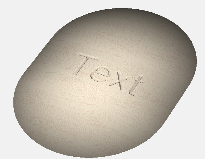

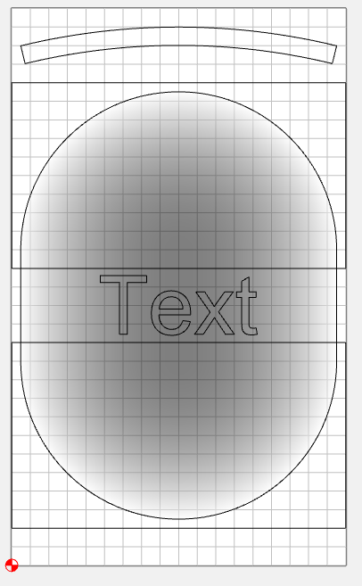

Assuming your chair back is something like the cross section, this example is 8.5" wide with a 1/2" rise in curvature. I can model this using the large oval with these settings to get 1/2"
Then I model the detail into that shape. I just used a text object
I subtracted the ends just to make it look right. It’s not necessary for machining

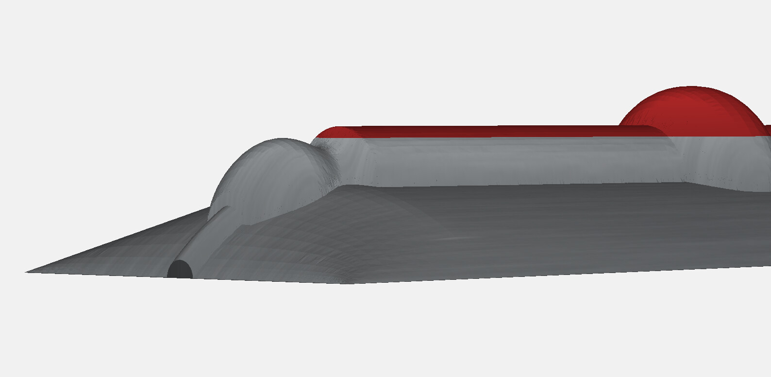

I machined the whole piece with a 1" ball so you can see the engraving, then machined only the text with a 1/8" ball. I would just use the 1/8" path on the machine.
